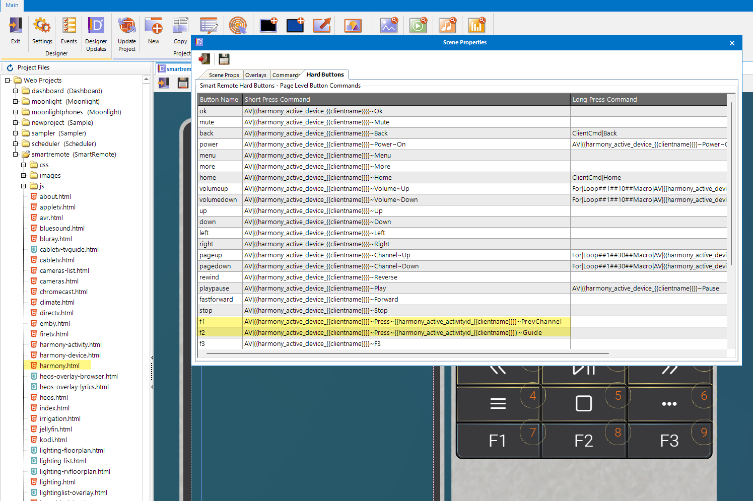

Thank you. I entered the commands. F1 brings up the SAP menu. F2 does nothing.
I am definitely a neophyte at this. Here is the screen shot. Where did I go wrong?

Hi Jim, I replied to this post a day or so ago (go back - post 1654)
allonis.com/forum/harmony-hub/43-how-goe...tions?start=162#1654
Hope my two cents / pence was useful.

Thanks. One last question. Which do I edit "harmony-activity", "harmony-device" or "harmony"
Like I said, I am a beginner.

I'm not sure what you mean - but if this helps...
in my example if I always wanted the F1 button to bring up the Guide, I would delete the entire contents of the short press command box for F1 and just replace it with:
AV|3~Press~80513405~Guide
Of course, the above would only work for me (because in my setup the Server has called the Harmony 'AV|3' and the specific code '80513405' is what the Harmony calls my cable TV box). Yours will be different - hence the need to see what is happening in the logs to find the command you want to use.
Just to repeat - the above ties the F1 button to one device. If you want it to control whichever is the current active device (rather than always only controlling one device) you will need to use a variable.
I hope that makes sense.
