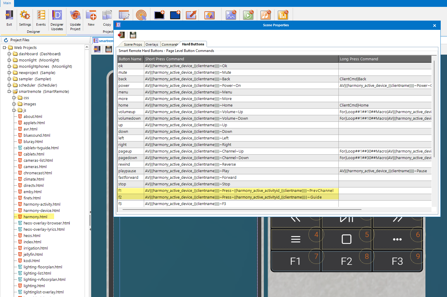

Thank you. I entered the commands. F1 brings up the SAP menu. F2 does nothing.
I am definitely a neophyte at this. Here is the screen shot. Where did I go wrong?

Can you get the guide to come up by using the 'soft' on screen buttons?
If so, try this (this is what I did):
- Load up MyServer
- In the dashboard turn on the 'Logging' slider
- Press 'Live Event Log' to open un the logging window
- Press the soft on-screen button on the remote that brings up the guide
- The Log will churn out a load of stuff showing what happened when that button is pressed
- For me (for example) when I press the guide for my Virgin Tivo box in the logs this line (amongst others) popped up:
16/03/2024 12:43:29.43 · DEBUG · Server.doCommand - AV|3~Press~80513405~Guide from smartremote-fx-2p4v
It is this phrase "AV|3~Press~80513405~Guide" that I put into the command line for the hard button.
Yours will be different (certainly different numbers)
Then hard button will then do the same as the soft button.
Note however that the stuff in {{curly brackets}} in the longer version you have been putting in are variables which refer to the active activity or device, meaning that in theory the 'Guide' command should be triggered for whichever activity or device is currently active. There are no {{curly brackets}} in the above text I refer and thus no variables. The string of numbers above ('80513405' in my case) refers to just one specific device or activity - an 'absolute' reference. That's fine for me as I only want to press Guide on my Virgin Tivo box but using an 'absolute' value like this and not the {{curly bracket variable}} in the hardbuttons for 'harmony' means the key will forever be locked to that one device when using Harmony.

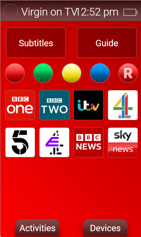

I have been ditching the built in Harmony scene completely and slowly (very slowly) building my own custom remote screens for my activities and devices. Current early draft for Virgin TV attached, by way of example, which works amazingly well (channel buttons run a macro which cause the corresponding channel number (ie 101 for BBC 1) to be input):
On that note... What an amazing add on it would be to have an overlay which automates the creation of channel buttons and corresponding channel numbers (Harmony did it by asking user geographic location, and which corresponding TV service they were running and then autopopulated channels) - I assume there is some public database of channel lists, icons, and number based on cable/freeview/satellite service etc?
- Load up MyServer

Many thanks but not quite what I am looking for. Just a suggestion that users may benefit from a method to automate the creation of a channels overlay populated with channels relevant to their location and setup. It's no great hardship to manually create your own (as I have started to do as per screenshot).

Just clickable icons for channels, not a guide. Query whether it would be possible to create a script that autopopulates an overlay with clickable channels icons based on user's location and TV service?Are you talking about icons for channels or a TVGuide?
