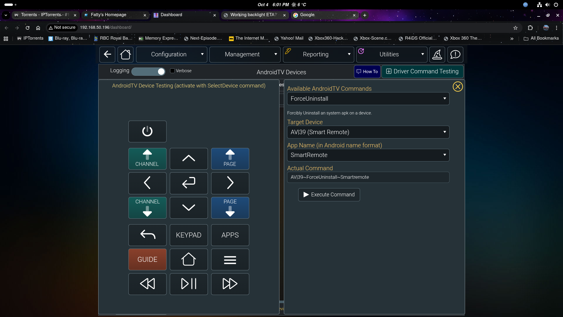

10 months 1 day ago - 10 months 23 hours ago #4483
by Fattykidd
Replied by Fattykidd on topic Working backlight ETA?
see below
Last edit: 10 months 23 hours ago by Fattykidd. Reason: update picture
10 months 1 day ago #4484
Replied by David Li on topic Working backlight ETA?
You need to select FORCED uninstall to remove the original apk software
From the AndroidTV Driver Commands window, (do these steps carefully!) select "Forced Uninstall" and select the SmartRemote device ID and select the smartremote app. Run the command. The SmartRemote icon will be removed, and the SmartRemote will reboot itself. Make sure you select "smartremote" so it gets included in the command to process!!! Forced Uninstall command is only used to remove the original smartremote.apk from the SmartRemote. Any subsequent uninstalls can be done with the "Uninstall" command which does not require a SmartRemote reboot.
