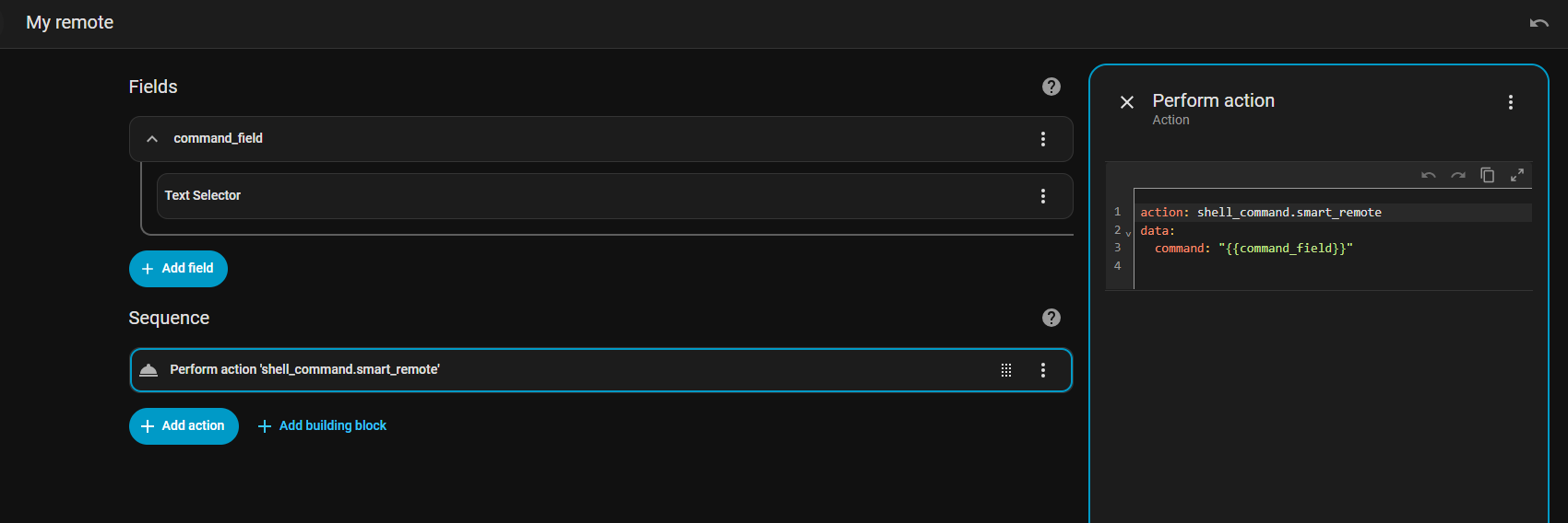

You should be able to put something like this into your configuration.yaml(make sure to restart HA after you put this in so it's available to select in the gui)
Then you could create a script that takes an input field(the command you want to run) and calls the shell_command.smart_remote action. In the script you'll have to edit the action in yaml to pass the field to the shell_command. Picture below of the script.
After that you should be able to call the script and enter the command you want in the field. That shouldn't require anymore yaml.
