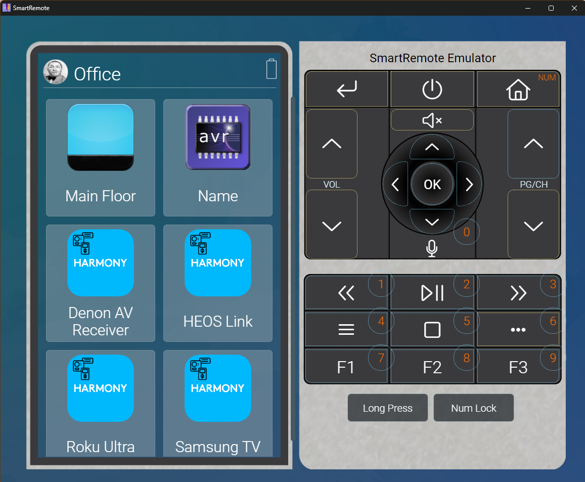

Today's Designer update adds hard button emulation when you preview a SmartRemote project using the Designer's Launch command.
The Buttons labeled Long Press and Num Lock are used to toggle those button states. Now you will be able to fully test your SmartRemote projects without have to stop to reach for the remote.
