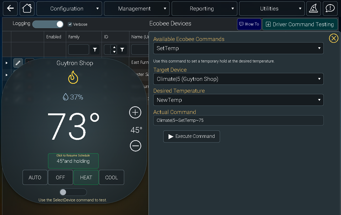

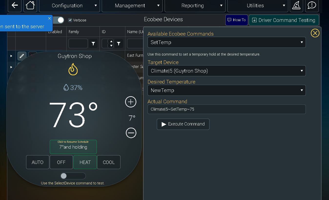

I found that the testing UI in Dashboard seems to operate my Guytron Workshop thermostat. There is often a delay in response but the Ecobee seems to obey most commands. The Up and Down commands seem to work the best. They are almost instant.
However it does not obey the SetTemp command. I have tried all kinds of numbers and usually it grabs only the first digit.
For example, if I tell it to go to 75 deg with this command, Climate|5~SetTemp~75 it tryies to set the temp to 7 deg.but that setting does not seem to be successful on the Ecobee.
A few seconds later and it reverts to 45 deg

And, if I try to change the temperature from Moonlight, it is completely unresponsive.
