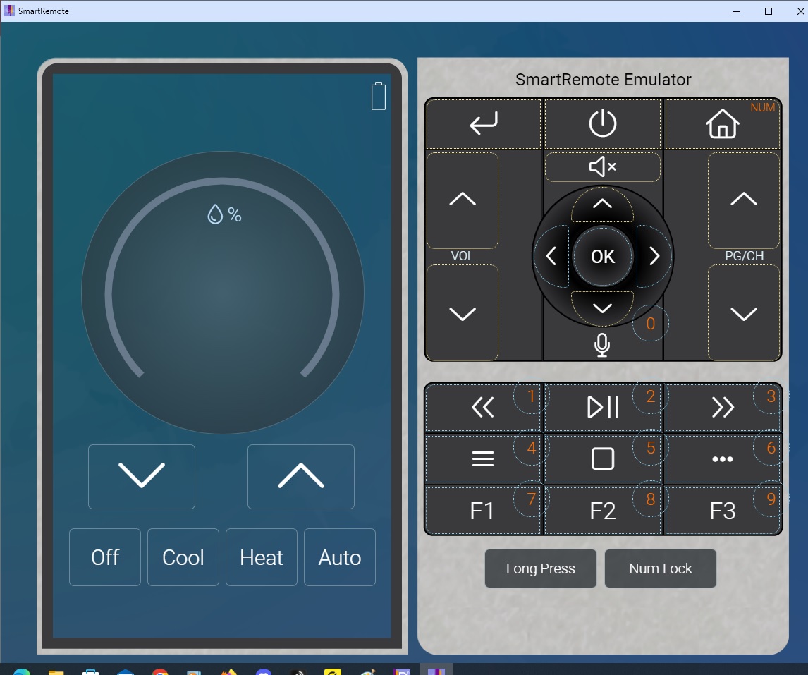

As you can see in the picture, nothing registers on the icon from the climate.html webpage.

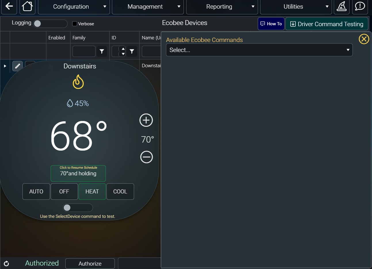

From My server, I have the correct thermostat selected as shown.
This is the log that when I select a command from my server:

I'm afraid I can't tell you how to fix it but I think I can see what the problem is. The myServer dashboard view of the thermostat and the emulated remote in myDesigner are two completely different clients as far as the system is concerned and for control to work in either of them then the thermostat has to be selected in that particular client context. As you've shown this is working in the myServer dashboard. But when you try to use the thermostat in the emulated remote the active device isn't getting set. When the "Climate|{{{{activeroom_{{clientname}}}}_thermostat_id}}~SelectDevice from smartremote-fx-6u2b" command runs it actually says it runs "Climate|~SelectDevice" whereas what it should be running is "Climate|1~SelectDevice". So I'm guessing that in your activate source macro or somewhere else, some part of the activeroom_{{clientname}}}}_thermostat_id variable isn't getting set correctly. You can then see the effect of this later in the log when you try to turn the temperature down and it runs "Climate|~settemp~down" instead of "Climate|1~settemp~down". Are you selecting the room in the emulated remote, and the thermostat is allocated to that room?

I think Andrew is right...I think the Smartremote-sample doesn't include the button to select which thermostat (even if there is one). Should work once that variable is set.I'm afraid I can't tell you how to fix it but I think I can see what the problem is. The myServer dashboard view of the thermostat and the emulated remote in myDesigner are two completely different clients as far as the system is concerned and for control to work in either of them then the thermostat has to be selected in that particular client context. As you've shown this is working in the myServer dashboard. But when you try to use the thermostat in the emulated remote the active device isn't getting set. When the "Climate|{{{{activeroom_{{clientname}}}}_thermostat_id}}~SelectDevice from smartremote-fx-6u2b" command runs it actually says it runs "Climate|~SelectDevice" whereas what it should be running is "Climate|1~SelectDevice". So I'm guessing that in your activate source macro or somewhere else, some part of the activeroom_{{clientname}}}}_thermostat_id variable isn't getting set correctly. You can then see the effect of this later in the log when you try to turn the temperature down and it runs "Climate|~settemp~down" instead of "Climate|1~settemp~down". Are you selecting the room in the emulated remote, and the thermostat is allocated to that room?
