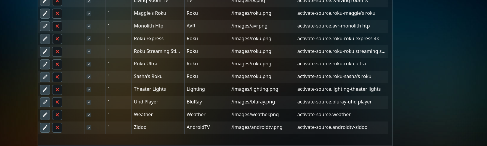

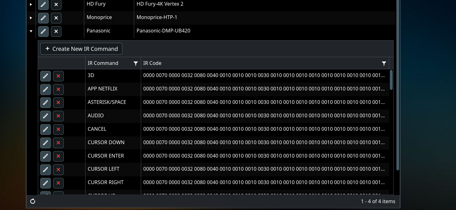

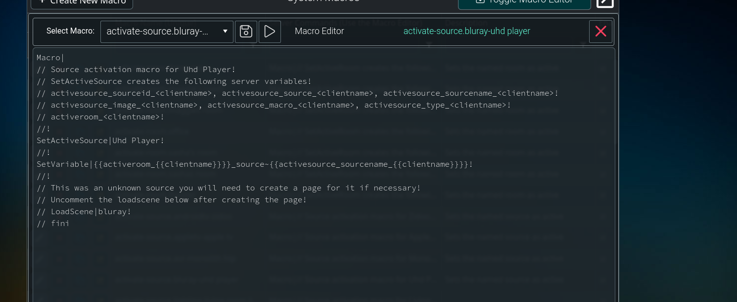

I'm setting up my ub420. I have the ir database model created. I've tested to make sure the ir commands work. I also created a "source" for the uhd player, myServer created an activation macro. I see I will need to edit the macro to uncomment the load scene command. Where or what I'm having issue with is.
Is there a way to automatically tie the ir code database to that scene ? Or to tie it to the source device so it loads automatically when that scene is loaded on the remote ?
I also made source devices for my htp and zidoo player. Same principle applies as macro's were made and ir commands work, but trying to take "lazy" way out of mapping commands to remote buttons.

The BluRayIR driver is where you pair the IR Model with an IR emitter to create a BluRay device.  The current driver does not yet create the activation macro and source automatically.
If you are in a hurry, you can try the BluRayIR driver as it is today, and see if it is possible to create the macro and source manually.
