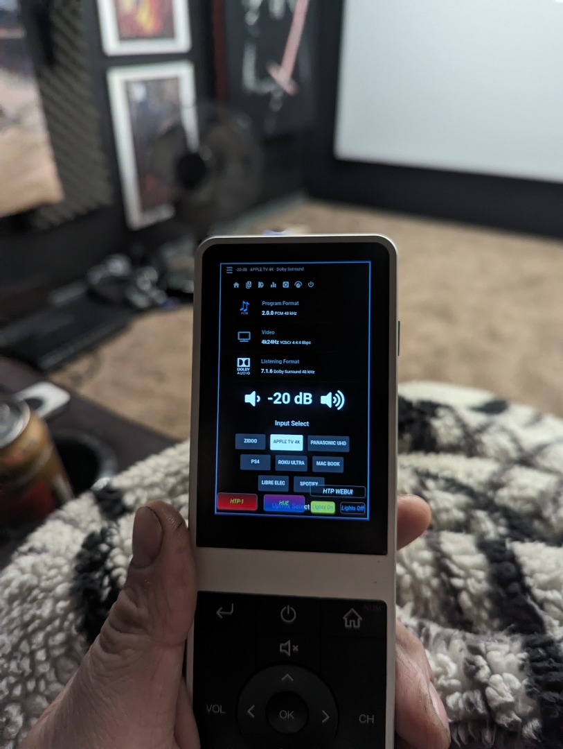

I use an ip2ir to power on and off. You could also use the webui as a page on the SR and power that way.

if you are able to control the HTP-1 via a IP2IR via Infrared, then the SmartRemote can control it too.
The whole problem with this driver is it's a poorly executed integration by Monoprice's supplier.
The removed Power Off / Power On from their API. Silly.

The power commands via the ip2ir work.
The power commands from the htp driver do not.
So at this point in time,
No you cannot power the htp via the SR without extra hardware or workarounds.

If you have an IP2IR controlling the HTP-1 via IR, then yes, you can control that via the SmartRemote.
