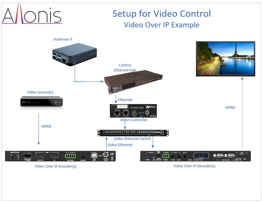

Video Matrix Manages all Video Distribution (Video Over IP technology)
A more advanced way is to leverage the Video Matrix Switch to send any Video Source to a reserved Audio Output card (typically has an HDMI AND an analog audio minijack or phoenix connector). This audio connection is then plugged into one of the Audio Matrix inputs.
Advantage: Any of the video devices can be used as both a video AND as an audio source. The Audio matrix can be small (less expensive).

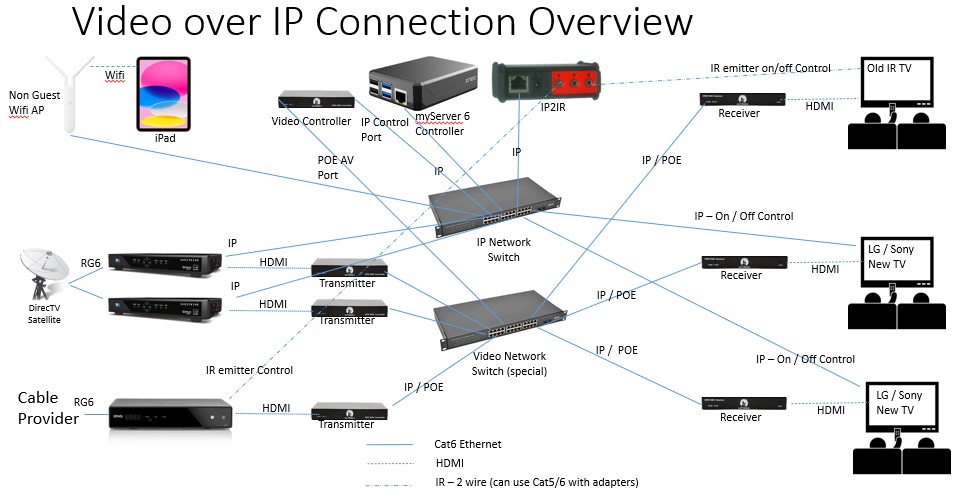

Some of the video over IP solutions support CEC TV control. This can be an advantage if you only have one CAT6 wire to each TV. Using CEC, you can both distribute the video AND control the TV on / off. Note that most modern TVs also support Wifi on / off control - which is another option if your video matrix doesn't support CEC (or your TV doesn't).
Video Over IP systems are very scalable - now or in the future with facility expansion plans. Typically no need for a larger equipment rack.
Most Video Over IP systems support video wall capability. Some also support multiple sources displayed on one TV (one receiver).
Some of the Video Over IP systems, the boxes can be configured as a Transmitter OR a Receiver. One less part to keep on hand for backup purposes.
Disadvantage: you need one video output card for each concurrent video source you want to listen to ie: one card for Zone 1, and a second for what you want to listen to in Zone 2. If there are two video cards, then the user needs to select which video card is used for that audio source. So, not quite as intuitive but less expensive for the flexibility.
Video over IP can be a little more complicated to setup initially than HDBaseT systems as there is more networking involved.
Depending on system size (number of "endpoints"), there can be price differences between Video Over IP and HDBaseT.
Video Over IP with IR control and Tablet connection examples
