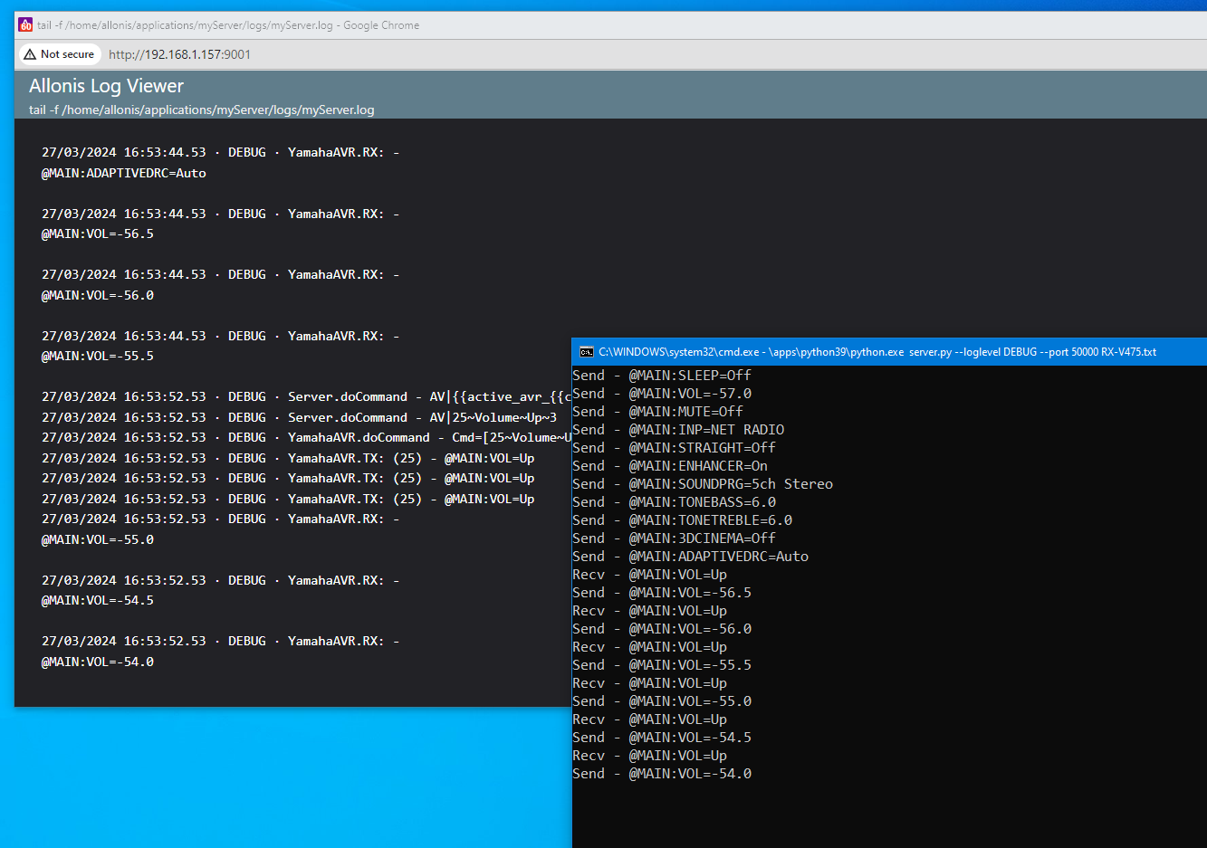

At the moment it looks like I've got three server variables that were set up when the driver was configured (av_25_connected, av_25_name and av_25_power) but the av_25_power variable always stays as 'Standby' even when the amp is turned on by myServer. av_25_connected does correctly switch between 0 and 1 as the driver connects and disconnects.
I never get an av_25_volume variable created to mirror the volume.

PS I get the impression there should be a plethora of av_25_* variables created for this driver. I don't see any of them, only _connected, _name and _power (which never changes) as stated previously. It's as if the responses back from the amplifier aren't being processed by the driver and stored in variables.
There's a python implementation of a YNCA driver here  github.com/mvdwetering/ynca and it rather helpfully contains a Yamaha avr simulator. It doesn't implement the connection drop after 40s idle but apart from that it seems to work. You 'fill it up' on start up with data from a real amp (or made up) and it uses that in its responses. I've extracted just the relevant files needed to run it and attached them to this post. You can run it like this:
Code:
$ /c/apps/python39/python.exe server.py --loglevel DEBUG --port 50000 RX-V475.txt
then use AddReceiver in myServer to add it and test some commands. Hopefully this will help with the debugging.

I've forked the Python ynca project and updated the simulator so that it times out after 40 seconds of no activity from the myServer client. So that aspect of the driver can be debugged now too.
My fork is at github.com/andrewmk/ynca?tab=readme-ov-file#ynca-server and the simulator is run (as per the readme) from the root of the project:
python3.exe -m ynca.server --loglevel DEBUG --port 50000 /logs/RX-V475.txt
