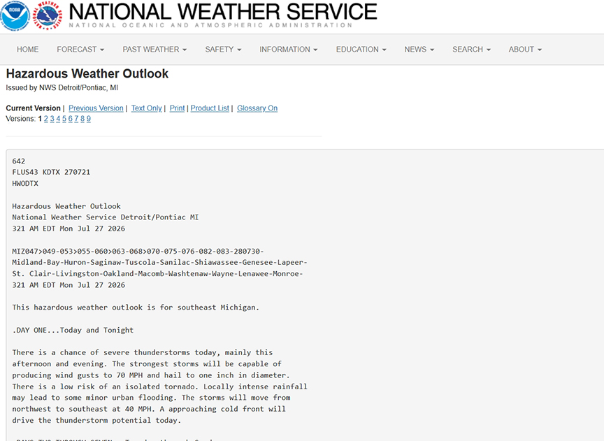

NWS severe weather warning in effect for Pontiac, MI.   Pic below.  MyServer is configured for Pontiac weather as that is closest to West Bloomfield.  Examining server variables there's nothing under alerts but some squal warnings for Lake Erie.  I went to the weather app in MyServer and unchecked "marine" then ran the update command.  Still no severe weather alert but I do still have squal warnings.

I am not familiar with how Allonis is requesting the weather alerts, but I do make the same type requests manually (http requests) for my Homeseer HA system and for my phone.
Something to check for: Is your position (Latitude, Longitude) set correctly? The NWS uses zones (also called "Points") for weather alerts (other weather providers use Lat and long). So it is possible your zone is not identified correctly, or the NWS did not include the zone you are in with that alert's zones.
I am not saying this is the issue, but it is something to check on.

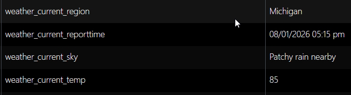

This weather app leaves a LOT to be desired.  It's essentially unusable.  Reporting 85 degrees in Pontiac MI at about 5:30 pm 8/1/26.  Yeah, I ran an update weather command in MyServer.  I really hope Allonis is looking into a different service. I would gladly pay for it by the way,   I paid for the upgrade in the old V5 system that got you hourly weather.

I'm now showing 86 degrees at 6:47 at night using the Pontiac station.  Other online weather services are reporting low 70's.   Maybe I'll try to find another station than Pontiac.  Is there a way to see what is available?
