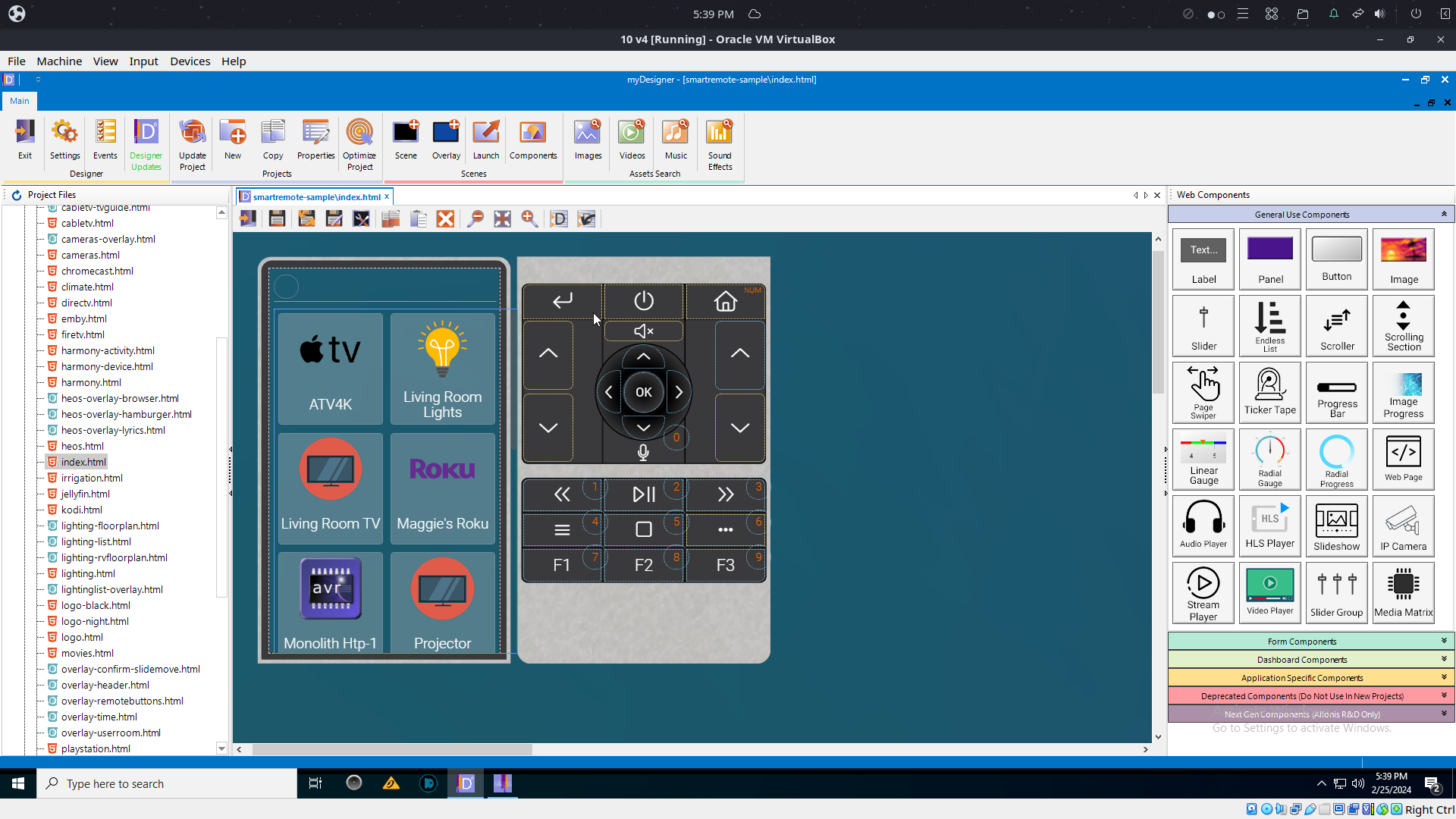

I am missing the "endless list" index page.

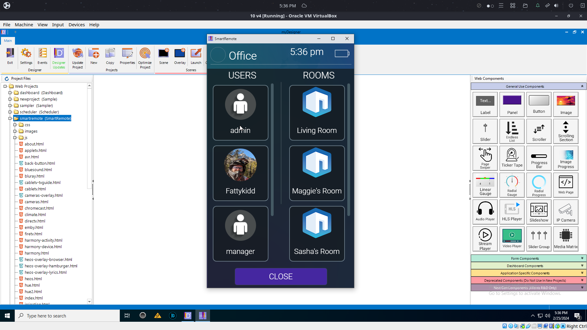

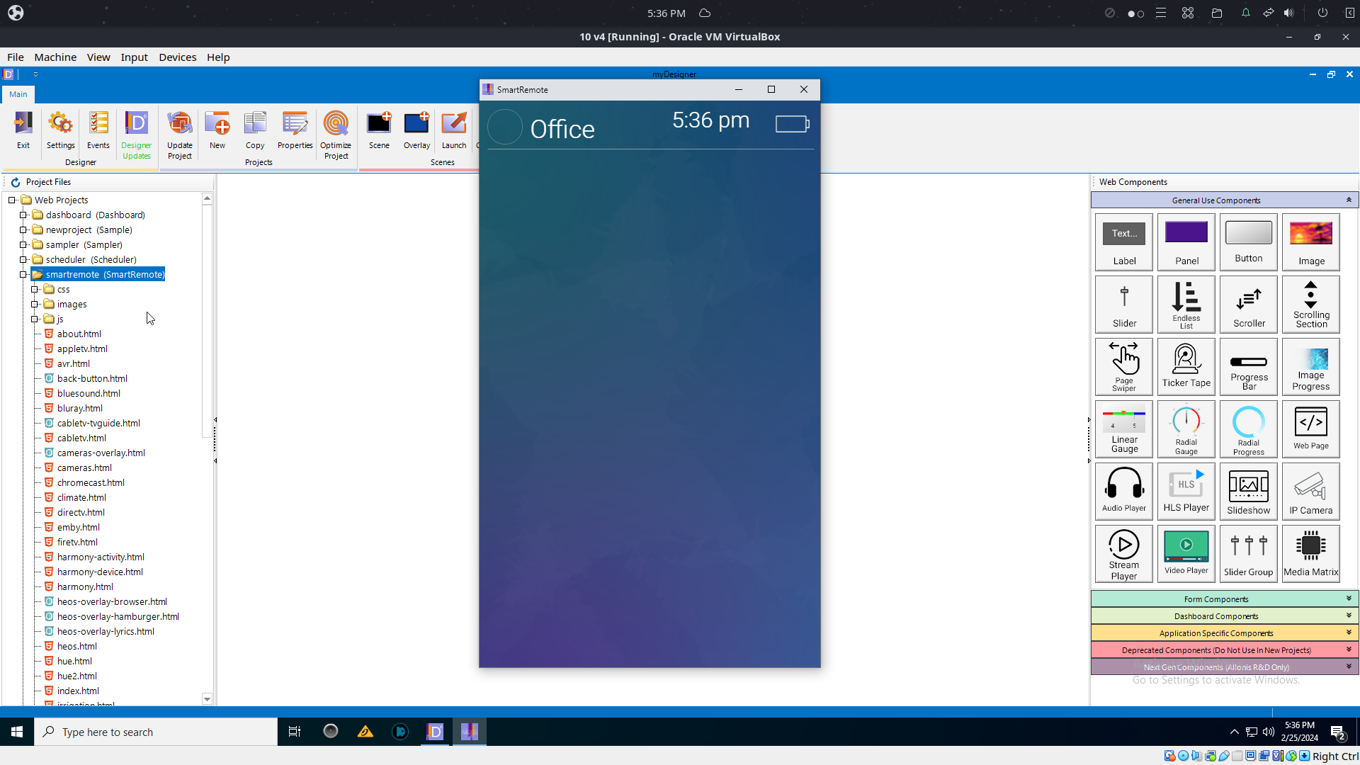

I can call up the index page in the mydesigner editing window and it shows correctly but if I try and  "launch" the project, it's a hard no. This is all on an un-edited smartremote template. I don't even have an office room defined for selectable in the options(see screenshot 2 and 3).. Where is it coming from?
We used to be able to hit the home button and it would take us to the index page that was populated with every device in our system(see screenshot 4), it now no longer goes any further than the selected active room.
