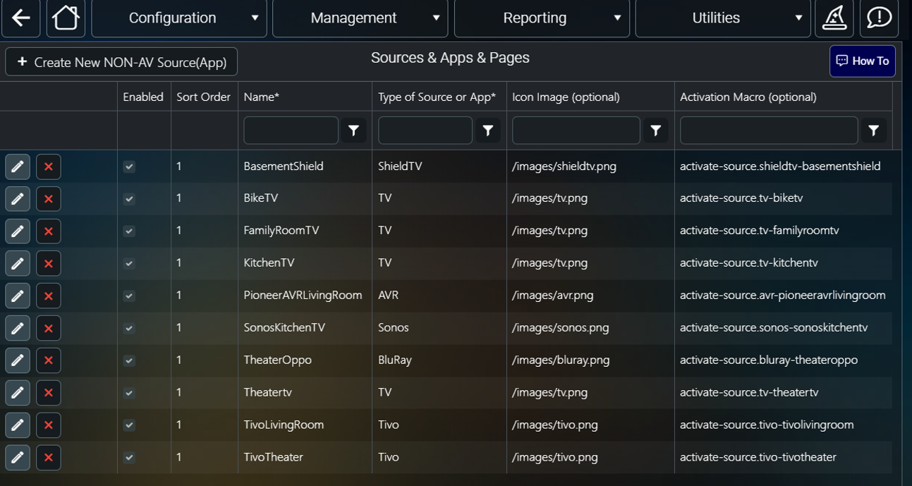

I'm sure you've already checked this but I assume the activation macros are calling the correct sources, right? Can you post a picture of your sources screen?
Thanks for the suggestion.  As mentioned above, the ActiveSource command is invoked with the correct source, and all the variables that get updated by the ActiveSource command are correct, except the ID.  I seem to remember it being correct a few days ago.
I attached a screenshot of my sources below.

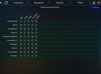

You don't have all of those sources assigned to the same room so you? I'm thinking I ran into an issue early on where I had multiple sources with the same "type" in the same room and I had the same problem with the activesource not getting the correct id.
I only have one Shield, Tivo, and Bluray in the theater.  I attached a screenshot of my apps and sources by room below.  Even if there are multiple Bluray players, which will be the case in the living room when I add those sources, they will have unique names, and the ActiveSource command should still work.  My next post will have some further data.
