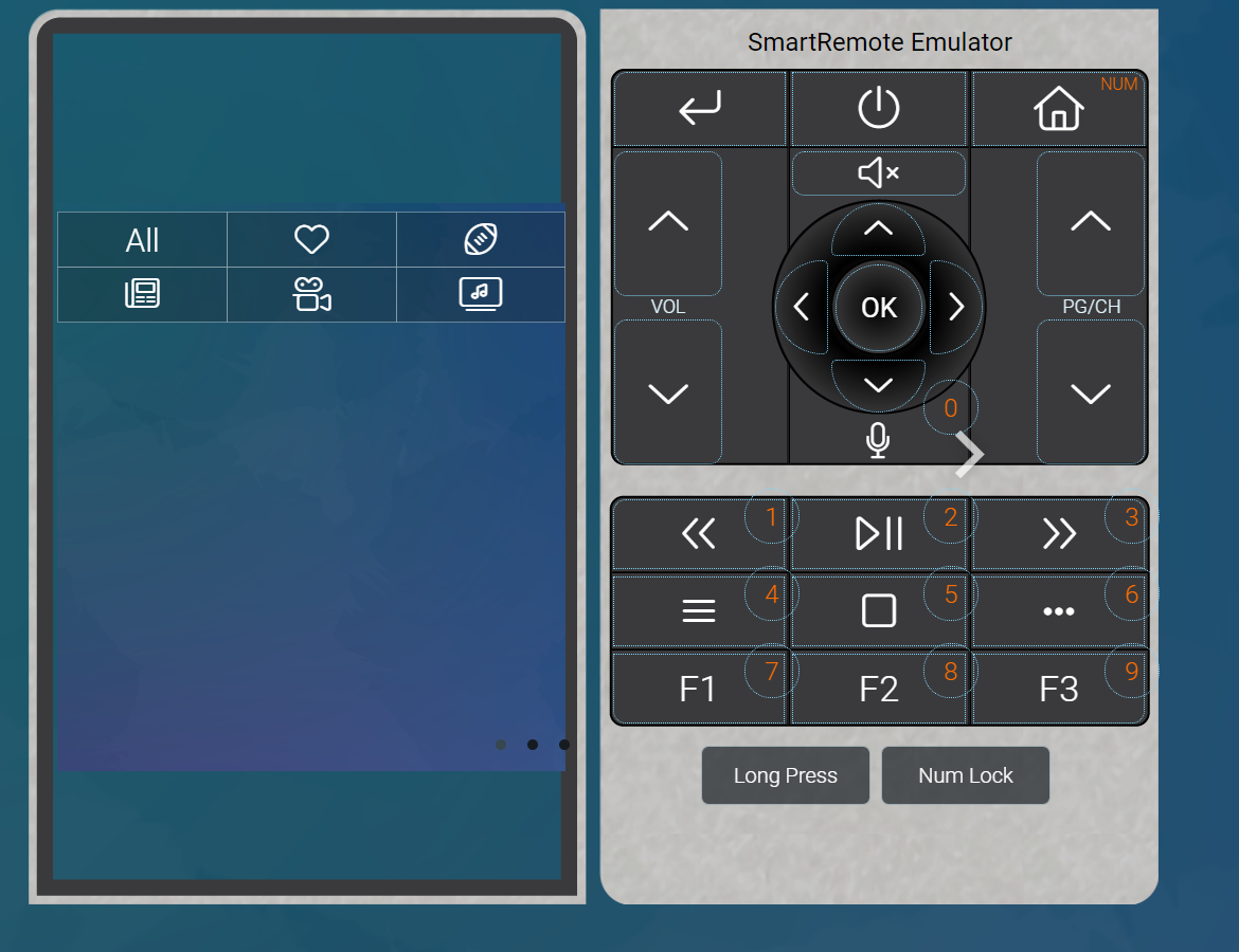

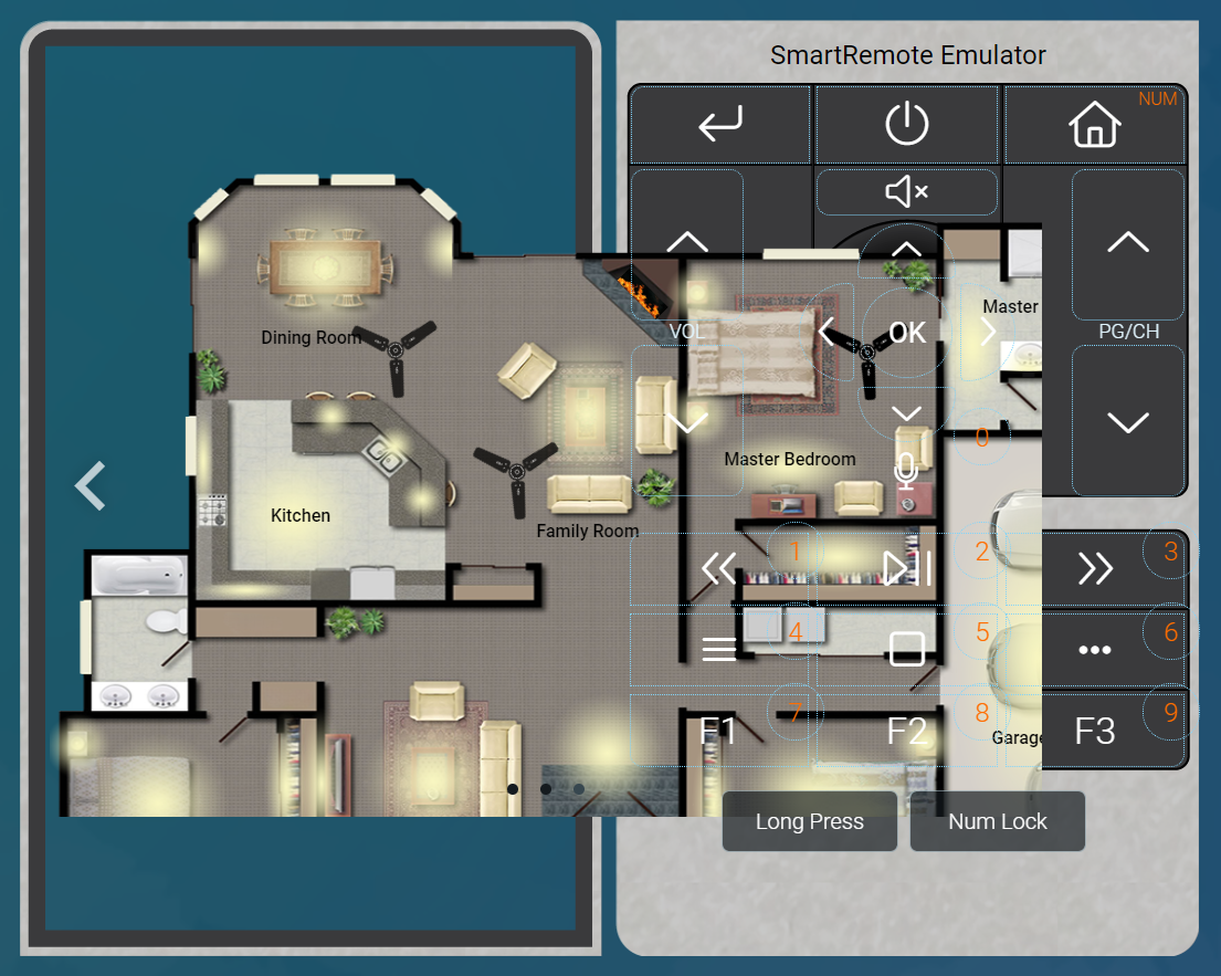

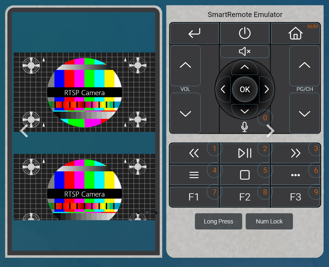

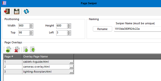

Just for fun, I created a new scene and put the page swiper control on the page. I then configured it with 3 existing overlay pages and added a button on the main index page to load the scene. I launched the emulator and the control seems to work as it should. I can use the mouse to swipe left/right and I see the dots indicating how many pages there are. Note that I did not configure these overlays in my test scene on the Overlays tab. Here are a few screen shots.I'd still like to get some feedback from David/Dave on how the Page Swipe is supposed to work. It seems like it's functionality should be obvious but maybe there's something I'm missing.
