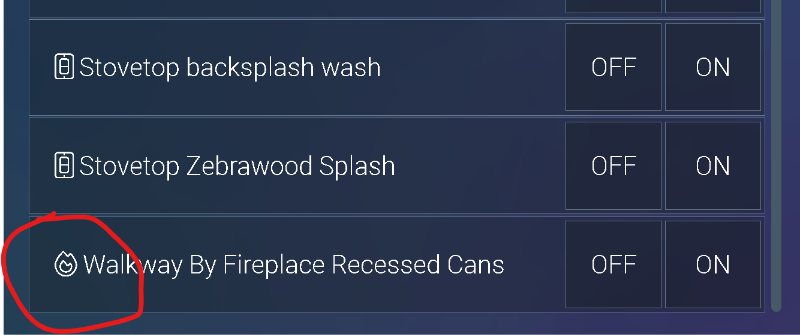

OK I went through the Rooms configurator under "Configuration" in Dashboard and I think the Rooms here reflect what I have in the init.house-lighting macro.  The first time I tried it after this I got about ten light switch events so being rather encouraged, I started wandering around the house with my ipad and after a few more switches in other rooms, it froze again in the Kitchen.  I noticed it froze on a circuit that has a different icon in Moonlight that looks like a little flame.  All of the other circuits have an icon that looks like a switch wall plate.

I'm making progress here...I figured out one question…   When I clicked on the basement kitchen it came up with a blank list and the title at the top of the blank list was “Basementkitchen” with no space between the two words.  I typically don’t name my rooms that way so I looked in the button in the lighting-lower-overlay.html and sure enough, the room name had no space in the command.  So I added the space and saved it.  Now it pulls up the complete list of light circuits in the basement kitchen.  So it seems those room names must be correct.  It seems like Mydesigner doesn’t care too much about upper or lower case but I made them all agree with the room names in the init.house-lighting macro as well just in case.
Now I can switch on/off every light in the house and the app doesn’t crash but most times it takes 3 – 10 seconds before the switch will respond.  Occasionally it will respond immediately.   How do we fix that?
Also, I added a fireplace icon that comes on when the fireplace is on.  I just copied that one from the original Moonlight.  Eventually I will add indicator icons for all of the lights in the house.
