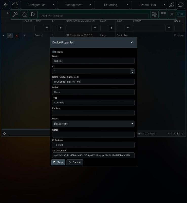

I was able to discover and add my Home Assistant controller and set the serial to the long-lived token I created but no devices are discovered.

Can you ping the HomeAssistant server from myServer controller and visa versa? ie: are they on the same network?
Yes.
what operating system is HA on?
HA OS.
A second Raspberry PI?
Odroid N2+.
Is HA updated to latest OS and app?
Yes.
Turn on verbose logging in the driver and watch the live event log. you should see the driver trying to connect. if it fails you should see an entry for that too.
Ok I turned it on but I have no idea where to access the log from.
Last edit: 2 years 9 months ago by glc650.
