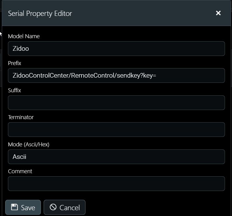

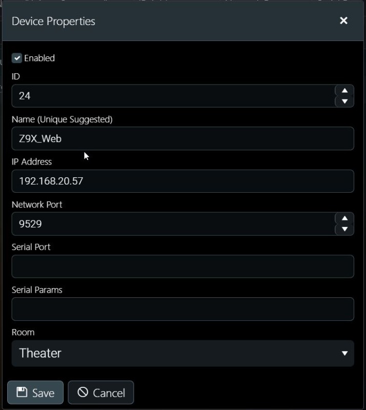

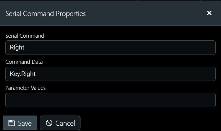

For instance here is the command that I would like to send.
http://192.168.20.57:9529/ZidooControlCenter/RemoteControl/sendkey?key=Key.Right
So I create the GenericSerial with 192.168.20.57 as the IP and Network port as 9529. I then define a serial model with the prefix /ZidooControlCenter/RemoteControl/sendkey?key= and finally I create the command with command data set to Key.Right.  It doesn't work.  I've tried a bunch of combinations and haven't found anything that works.  So any pointers on what I might be doing wrong?
