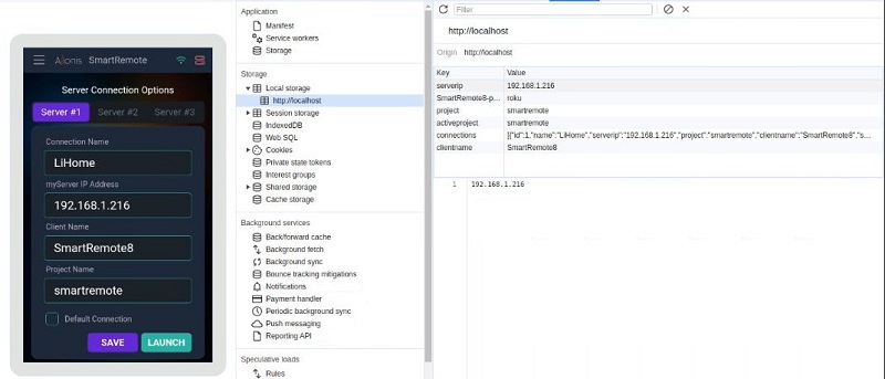

To Manually configure (be careful that you type in the correct information in each field!):
1. Type on the myServer IP Address box. The on screen keyboard will appear. Type myServer 6's IP address.
2. Next, click on the Project Name box. "smartremote" is the correct default folder name (the folder on myServer's webserver) (type with no quotes).  Note this name is case sensitive.  So, it's "smartremote", not "SmartRemote".
3. Click on the Clientname field. You can name your remote what you want.  For our purposes, we will call it "SmartRemote8".  Don't put spaces in the name.  Keep the name simple as it will be used in lots of macros and variables.
4. Click the Save button.  If you have a second myServer to configure, click on the Server #2 tab and enter that information.  Click Save.
The Default Connection is the server that will be used on startup.  You can also deselect but then you will need to choose which Server to connect to with each app startup.
This concludes all configurations that are done on the actual SmartRemote.  All user interface changes are made in "myDesigner".  All button actions are defined in myDesigner as well.  The rest of the configuration including all controlled device support is done in myServer 6 application.  The above configurations can be cleared and saved if the remote will be sold or gifted to someone else.

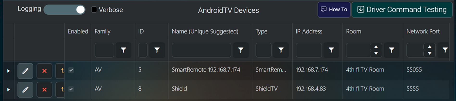

From a PC browser, go to myServer 6's Dashboard. Click on Management / Drivers / AndroidTV's configure button.
Click the Discover button. Soon, the powered on and networked SmartRemote will be added automatically. You should see it's power state in the Power Testing area. Here you can update the SmartRemote.apk if updates are available. The apk updates are distributed in myServer 6 updates.

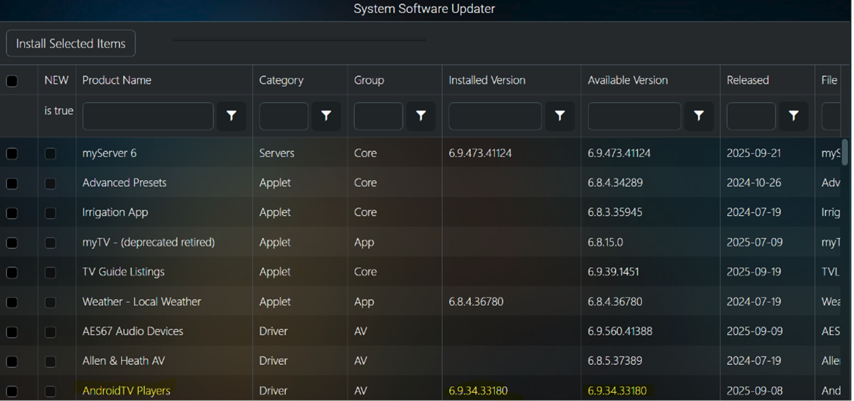

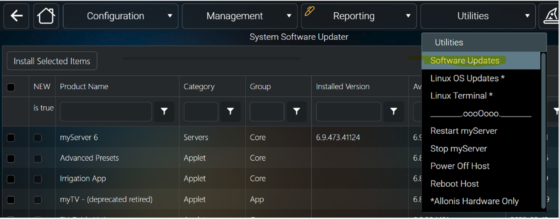

Optional but nice to do: Updating the SmartRemote.apk (the "app" that lives on the SmartRemote)

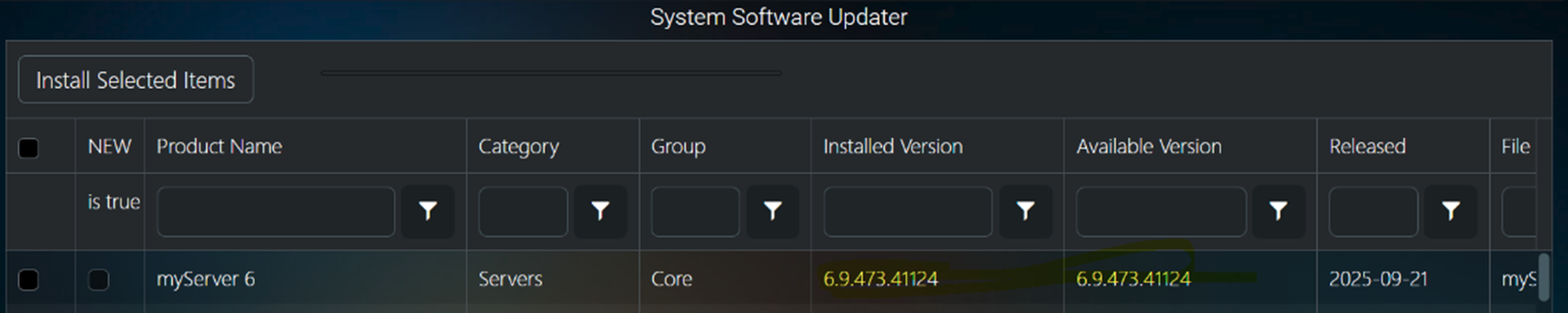

  • 1) Install the latest myServer build from myServer's Software Updater.

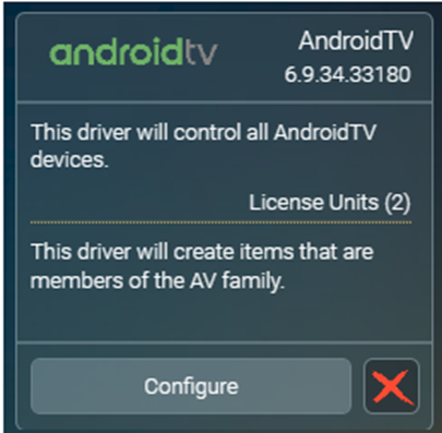

  • 2) Ensure you also have the latest AndroidTV Driver and have added your SmartRemote to the list of Android Devices.
    • Latest Driver

    • Find Android TV
    • Press Configure and make sure SmartRemote is there
  • 3) Update to the latest SmartRemote Template.
    • Go back to System Software Updater
    • ***Backup your custom webpages and change the smartremote-sampler file name to "smartremote" folder name.
    • ***You can also copy back your custom webpages from your backup.
      • *** I have no idea how to do this and don’t have any custom webpages. Do I need to look up how to do this?
      • The only Backup Option I could find was this

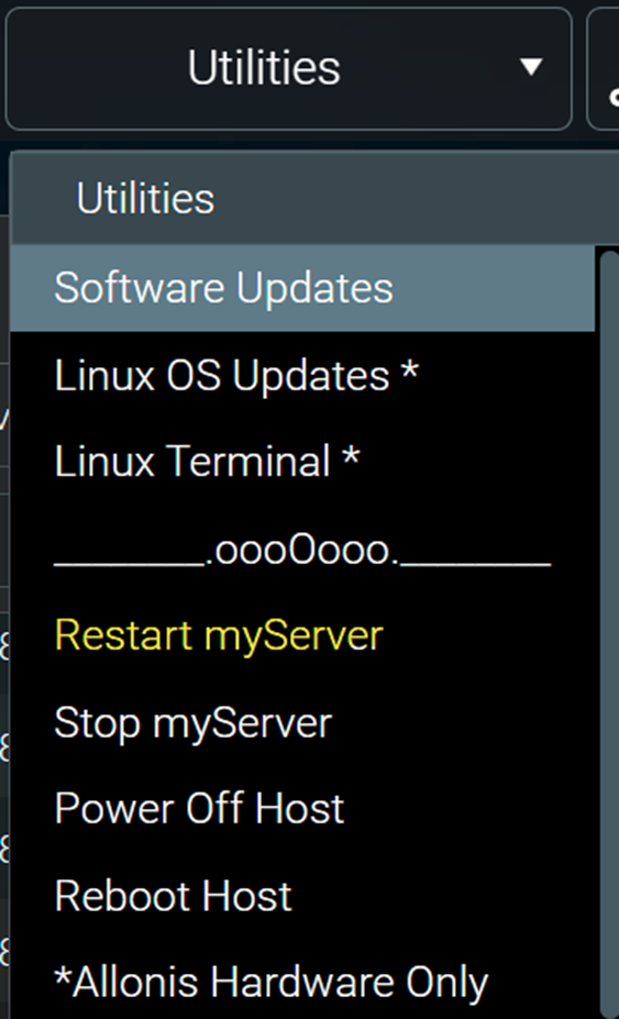

  • 4)  Restart myServer

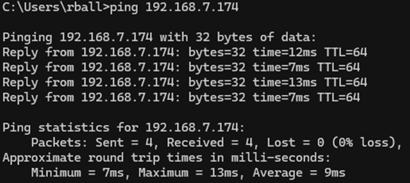

  • 5) Ensure that the SmartRemote is online.
    • You can ping it's IP address.

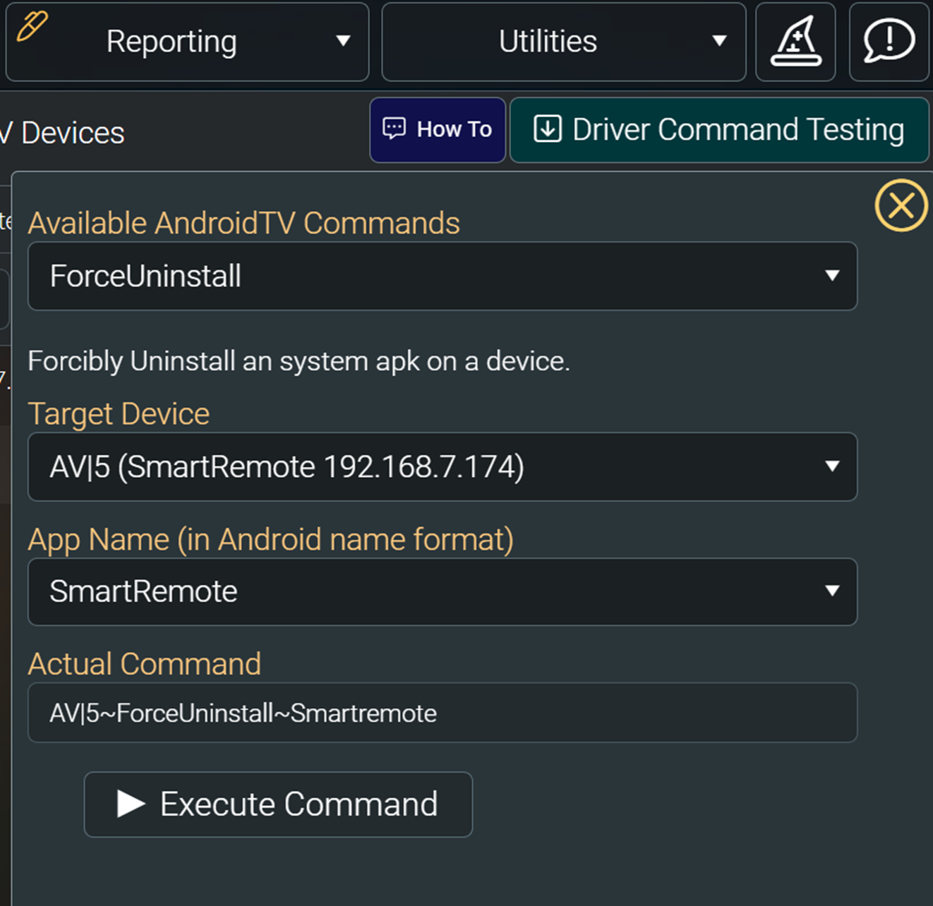

  • 6) If the apk has never been updated since new: Do this CAREFULLY: From the AndroidTV Driver Commands window, select "Forced Uninstall" and select the SmartRemote.
    • Found at Management->Drivers->AndroidTV->Configure
    • Run the command.  (Click Execute Command)
    • The SmartRemote icon will be removed, and the SmartRemote will reboot itself.
    • Make sure you select "smartremote" so it gets included in the command to process!!!
If the smartremote.apk has previously been upgraded (like to 2.0.2) then simply do an Uninstall (not a Forced Uninstall) from the AndroidTV driver command menu. Ensure you select to remove the smartremote.apk from the command drop down selections.

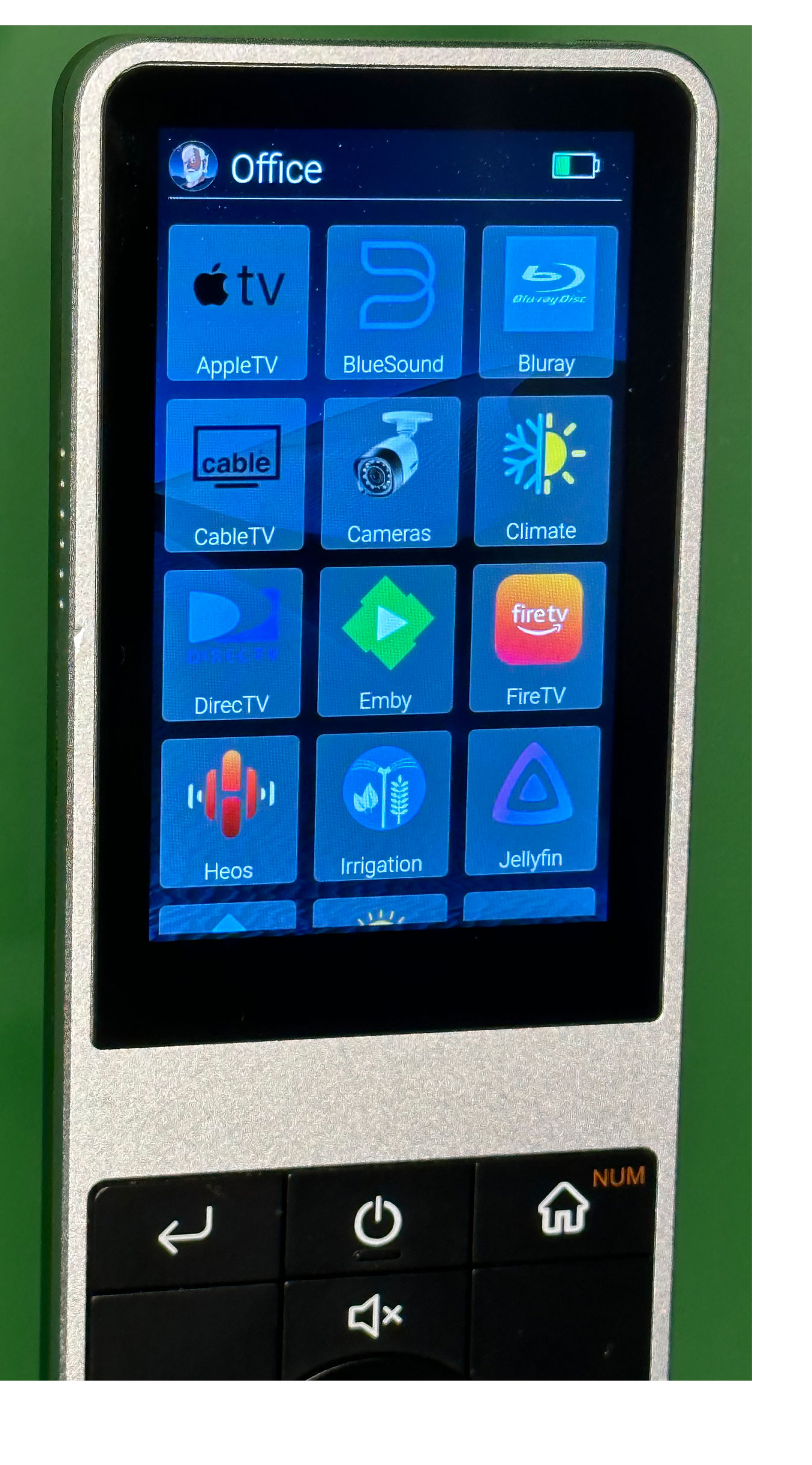

The following steps are done on the remote:
  • 8) Soon, you should see the SmartRemote app icon on the SmartRemote.  Click to launch it.
  • 9) Accept all permissions and select to add SmartRemote icon.
  • 10) Click to launch the SmartRemote Icon.
    • You should automatically connect to your myServer instance if you had that setup as default.
      • If there wasn't a default, then you should click to Launch myServer.
  • 11) Once the myServer smartremote home page is launched, you can click the Dot Dot Dot hard button.

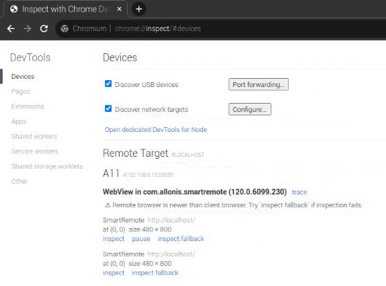

You might not be able to reach the AndroidOS desktop to clean data.  If this is the case, myServer Pi needs to have ADB access.  This can be done within myServer's AndroidTV app (add the SmartRemote IP to the list of Android devices - which adds ADB connection to it).  You can also from a terminal session, type: "adb connect 192.168.1.48:55055" (use your IP address). Then, in Chrome (on the myServer controller), go to "chrome://inspect"  You should see the SmartRemote listed in the list of ADB connected devices.   Click "inspect" link in the SmartRemote's Remote Target section.
Chrome inspect 1
Go to the Apps tab and click the Application Tab.
You can adjust the myServer IP address and the project name (the myServer smartremote folder) as well as change the SmartRemote's computer name.
 Chrome inspect 2
 SmartRemotes that are "off" in AndroidTVDriver will not show in Screencast view in Inspect. Turn it ON and it displays. So, the remote might be asleep.
