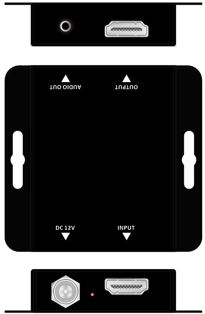

Panel Schematic Diagram / Panel Layout Diagram
 A  3.5mm Analog Audio Output Port
 B  HDMI Output Port
C DC 12V 1.5A Power Input Port
D System Indicator Light
E HDMI Input Port
