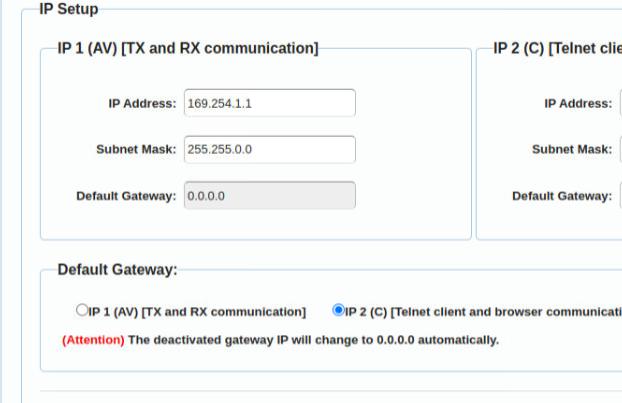

Here is what the Video Controller settings must look like:
HDTVVoIPsetup
NOTE:
  1. The HD over IP Video Controller does NOT issue IP addresses for TX and RX devices on the Video network.  Therefore, they will be on a 169.x.x.x network.  Optionally:  the computer running the JTech Windows Video Over IP software must be networked directly to the Video Network Ethernet switch on the 169.x.x.x network to "see" the TX and RX devices.  Link to download the Windows Video Over IP software
  2. You do NOT need to configure the video walls in the Windows Video Over IP configuration software.  The Video Walls are defined in myServer's driver.
  3. TX and RX Alias's will populate the myServer driver device list.  So you can configure those using the Windows Video Over IP Configuration utility.
  4. The control box defaults to 192.168.11.243 on its control port. You will need to put the controller on your local network before you can configure the system.
