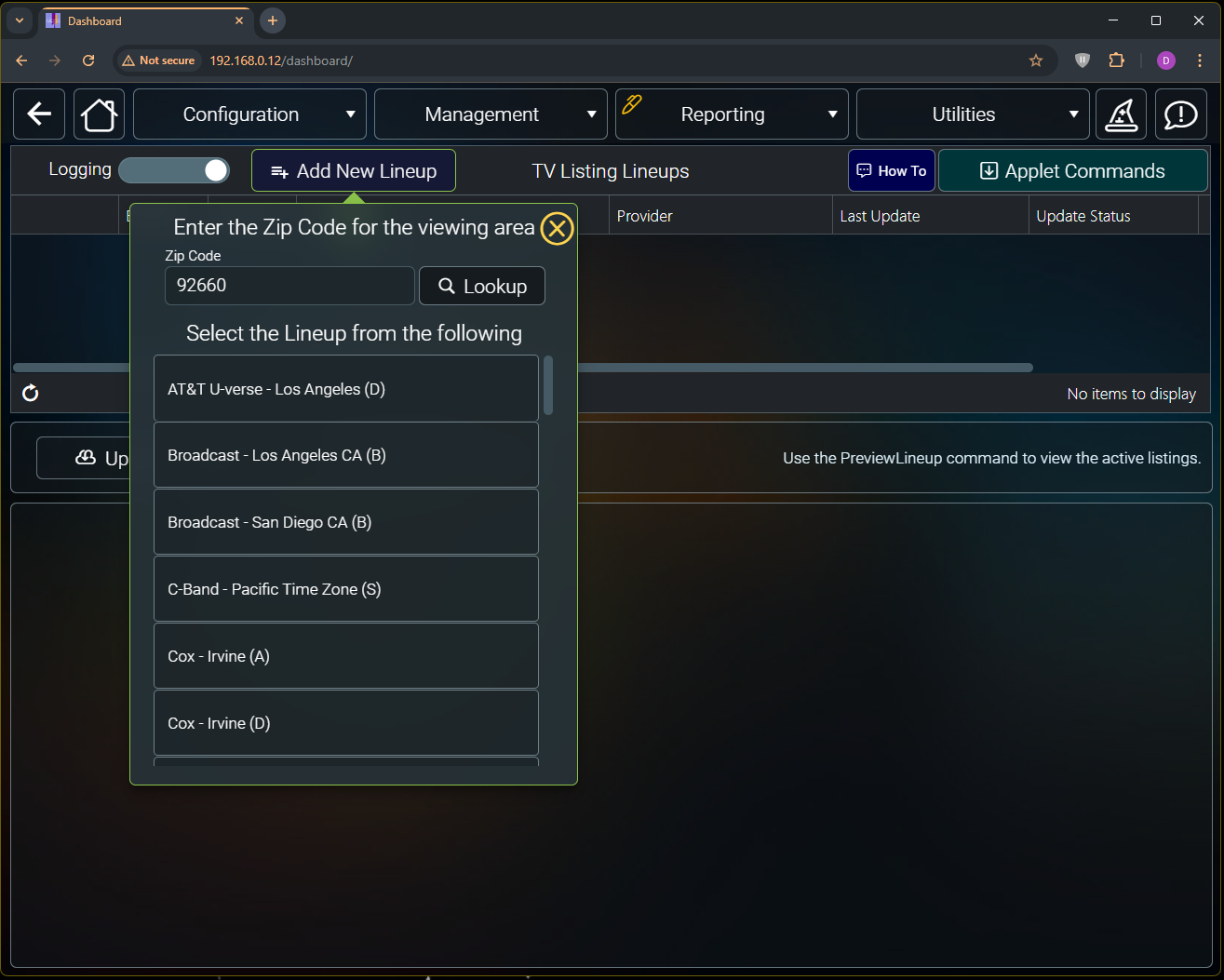

Next step is to create one, or more, listings. Click on the "Add New Lineup". An overlay will appear that prompt for input. Enter the zipcode the viewing location and then click on the Lookup button. This will return you a list of all the known TV providers in your area. Click on the lineup that matches your service.  The letters shown in parentheses depict the type of service, e.g. (O) online, (S) satelite (A) Analog, (D) digital. You should see a screen like the following:
TVListings1

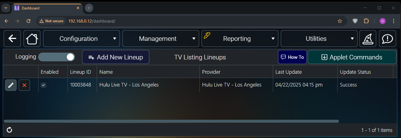

After selection you'll see the new lineup in the table.
TVListings2

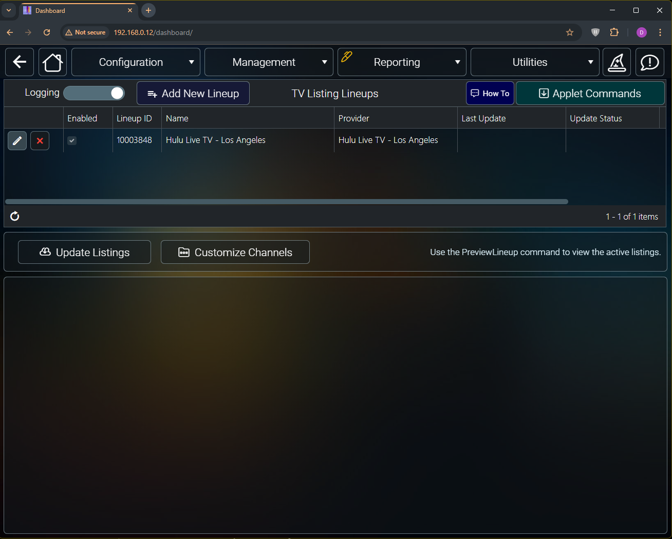

After you've added your listings you'll need to kick off the initial download of data. Click the "Update Listings" button to start the process.
When it completes (takes many minutes typically - lots of data!) you'll see the status update next to each listing entry.
TVListings4

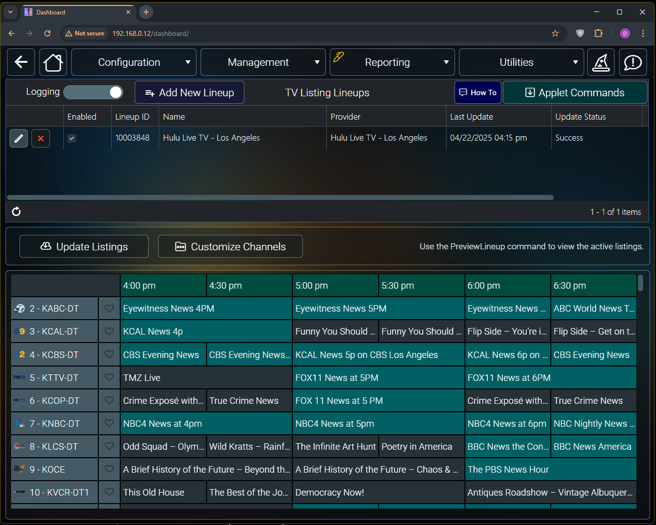

If you would like to preview a lineup click on the "Applet Commands" button and select the PreviewLineup command. When you execute the command a preview of the guide will be shown on the page. Like shown below.
TVListings5

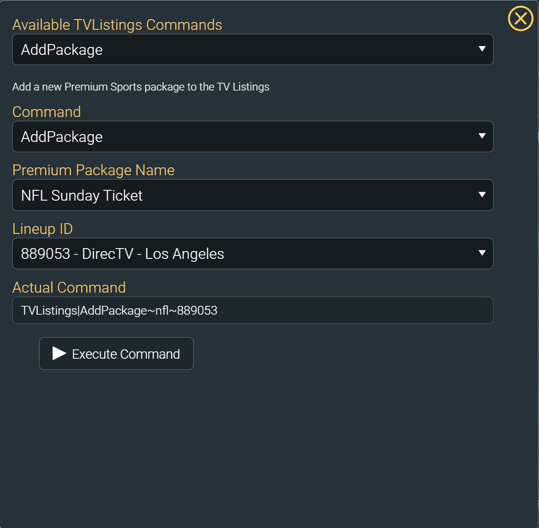

These packages are not installed via the Add New Lineup dropdown. Instead you must use the Command Builder to individually add the packages you are currently subcribed to. Here's an example of adding DirecTV's NFL Sunday Package.
tvl addpackage
Repeat for each premium package you are subscribed to.
To remove a premum package use the command builder RemovePackage command. It works just like AddPackage only in reverse.

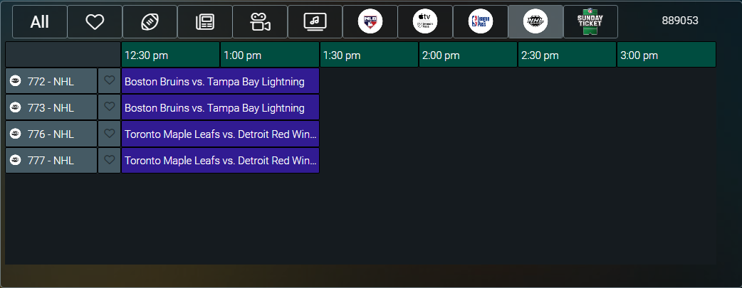

Once the sports packages are added you will see new filtering options on the listings grid. Five new filters are provided. One for each premium service. Only the packages you currently subscribe to will have visible filter buttons. Here is an example of filtering on the NHL Center Ice package.
tvl filters
Note that if you select a filter and no programs show up it does not mean that something is broken. All it means is that the selected service is not broadcasting anything during the times shown at the top of the grid.
