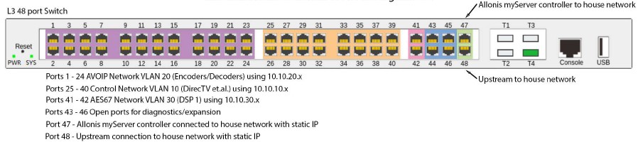

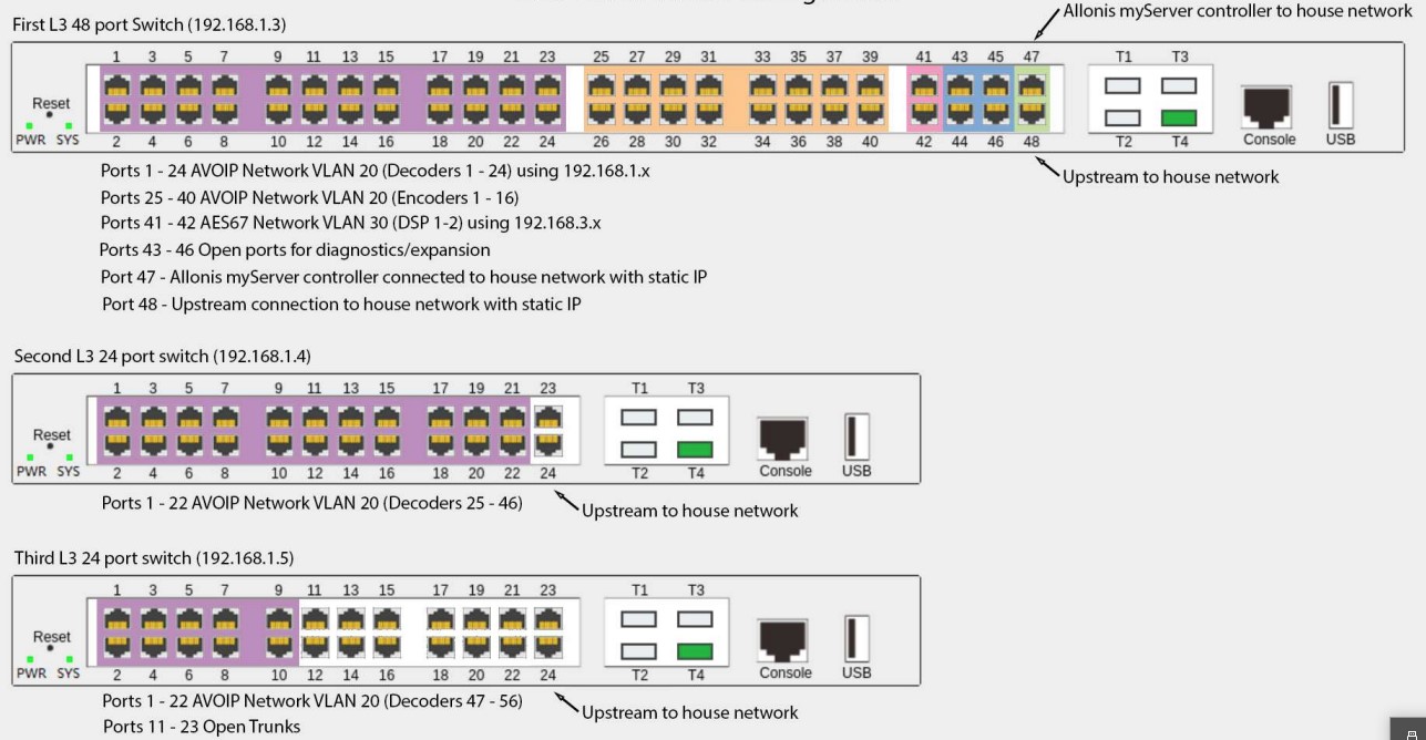

Prerequisites – Documenting the port layout
For our example we will use the following switch port layouts.  Note that no two systems have same number or type of devices, so this is just an example.
Ports 1-12 will be for AVOIP traffic (Encoders). They can be configured to feed A/V over IP traffic to downstream switches.   VLAN 20  Video sources connect to these.
Ports 13-38 will be for AVOIP traffic (Decoders). They can be configured to feed A/V over IP traffic to downstream switches. VLAN 20  These are typically mounted at the back of the TV and connected via short HDMI cable to TV.
Ports 1-38 can really be used by either Decoders or Encoders.
 Ports 39-40 will be used for Control Devices ethernet switch (that can be on less expensive L1 (dumb) network switch). VLAN 10
Ports 41-42 will be used for AES67 Audio over IP traffic. VLAN 30
Port 43-45 will be used for diagnostics (typically a laptop).  This has access to all VLANs and Internet. VLAN 10, VLAN 20, VLAN 30, VLAN 40.  We highly recommend this laptop is available for system configuration.  Windows OS, TeamViewer Host software installed.  We will need the TeamViewer ID / password for access.  We also recommend this laptop is on a Wifi Internet connection as well.
Port 46 - 47 is for the myServer controller ethernet connection(s).  this has access to all VLANs and Internet.  Two for redundancy myServer controllers. VLAN 10, VLAN 20, VLAN 30, VLAN 40
Port 48 is used for connection to the "house" / "Bar" network (that is typically where Internet is accessible)
Ports T1- T4 will be generic trunk fiber ports for connection to upstream (primary) / downstream (secondary)network switches. VLAN 10, VLAN 20, VLAN 30, VLAN 40  Connector:
1.25G 850nm Multimode SFP LC Transceiver Fiber Module 550 Meters 1000Base-SX LC MMF

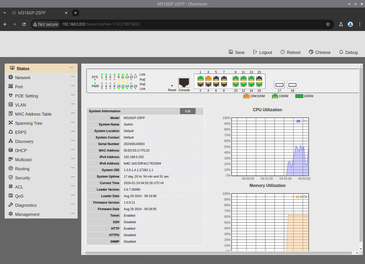

  1. Get the switch on the network.
The L3 switches will always default to an IP address that varies by manufacturer.  The Allonis switches will use the IP address of 192.168.1.200. You will be presented with the main status page.  Note the below pictures display a 16 port switch.  Setup is similar for 48 port.
 GetOnNetwork1

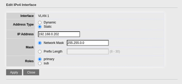

Immediately navigate to the Routing / IPV4 Interface section.
 GetOnNetwork2
Select VLAN 1 by activating the checkbox and click on edit. Change the IP address and Network Mask to an unused IP address on the house network. In this example we us 192.168.0.202 with a network mask of 255.255.0.0.  This is the IP address to manage the switches settings.
 GetOnNetwork3
Apply the changes and then immediately change your browser to open this new address.

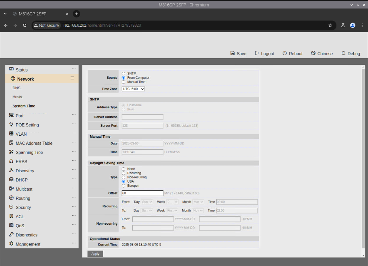

 2. Set the time on the switch.
While not absolutely necessary setting the time on the switch can help down the road if you need to look at log files.
Open the Network / System Time section.
Set the Time Source to “From Computer”.
Specify the correct UTC offset for your Time Zone.
Activate Daylight Savings Time if your location uses it and set the correct type.
Then click Apply.
SetTime1

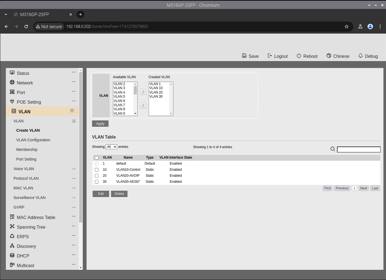

3. Create the VLANS
Browse to the VLAN / Create VLAN Section
Create three new VLANS as shown below.
 AddVLAN1

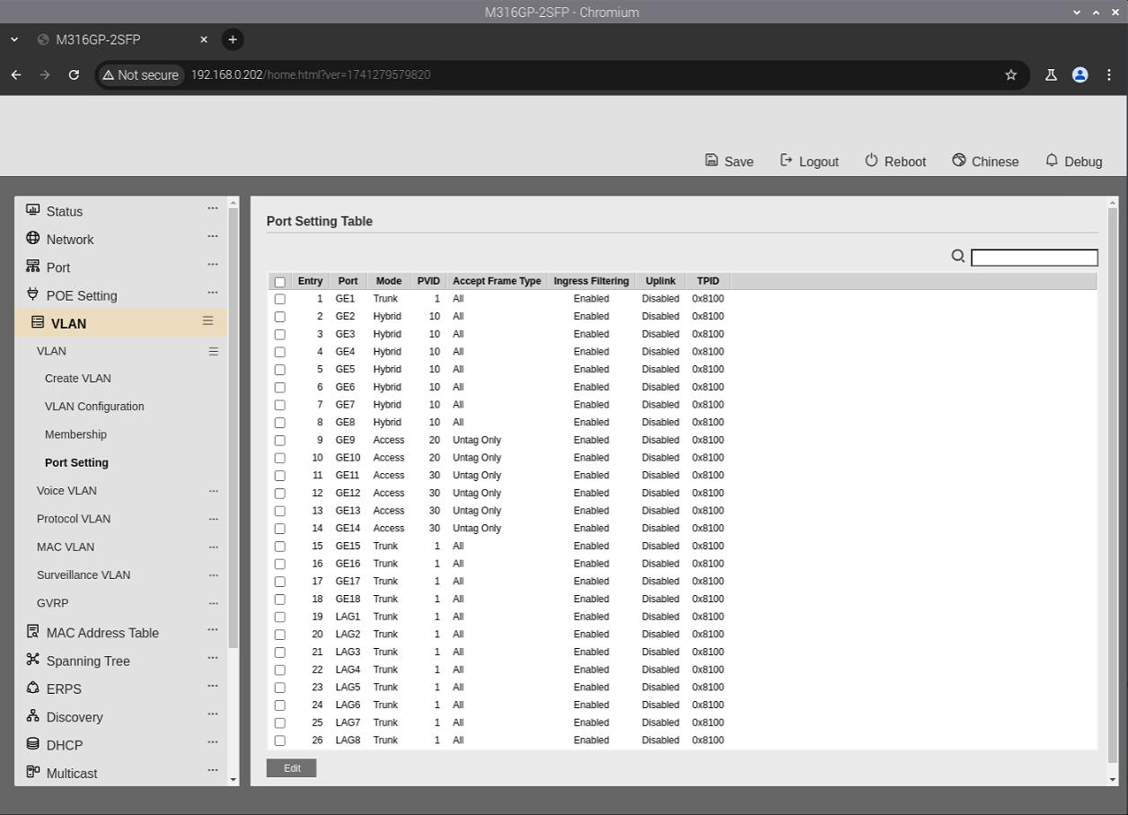

4. Assign VLAN Port Settings.
Navigate to the VLAN / Port Settings and define the mode for each of the ports on the switch.
Set port 1 to Trunk for myServer
Set ports 2-8 as Hybrid ports so that they can talk on the control network as well as have Internet access.
Set ports 9-14 as Access ports as they only have to communicate on their defined VLAN.
Ports 15-16 will remain as Truck port for connection to the house network.
It will look like this.
 AddVLANPorts1

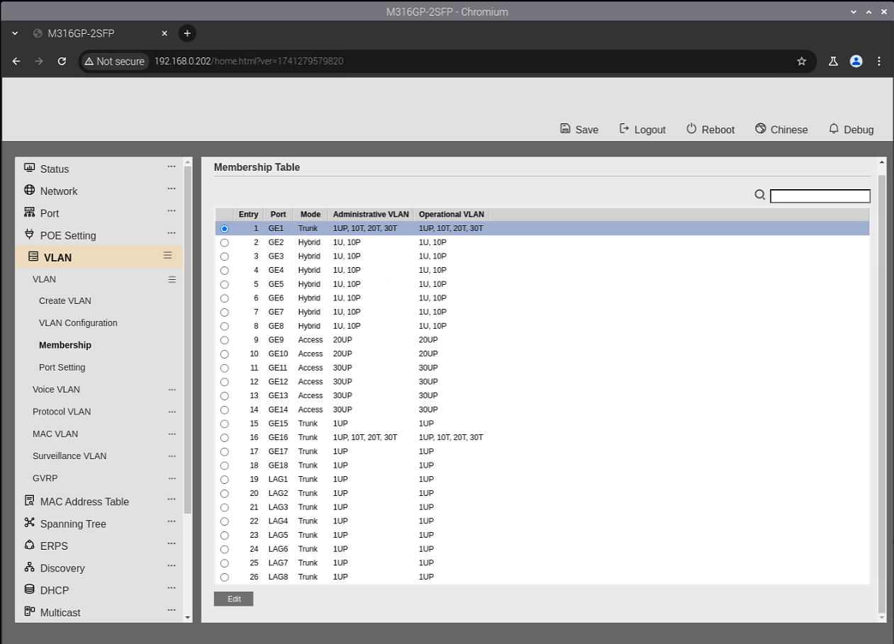

5. Assign VLAN Memberships
Next navigate to the VLAN / Membership section. Here we will define the VLAN associations for each port.
Port 1 is on the Control network and it is also the port were the myServer controller is plugged into. This is a special port as it has to be a member of all VLANs as well as the house network. We keep the port defined as a Trunk port and allow it to see Tagged VLAN traffic on all VLANs.
Ports 2-8 are defined as Hybrid ports on the control network. They will set VLAN 10 traffic as well as have access to the Internet.
Ports 9-10 are assigned to the AVOIP network VLAN 20. They are defined as access ports since they do not need to talk to the Internet.
Ports 11-14 are assigned to the AES67 network VLAN 30. They too are defined as access ports since they do not need to talk to the Internet. (Subject to network streaming requirements).
Port 16 is our Trunk port to the outside world on the house network.
You will need to edit each of the ports and make the appropriate membership assignments. When you are done it should look something like this.
 AddVLANPortAssignment1

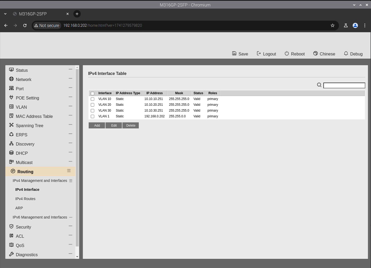

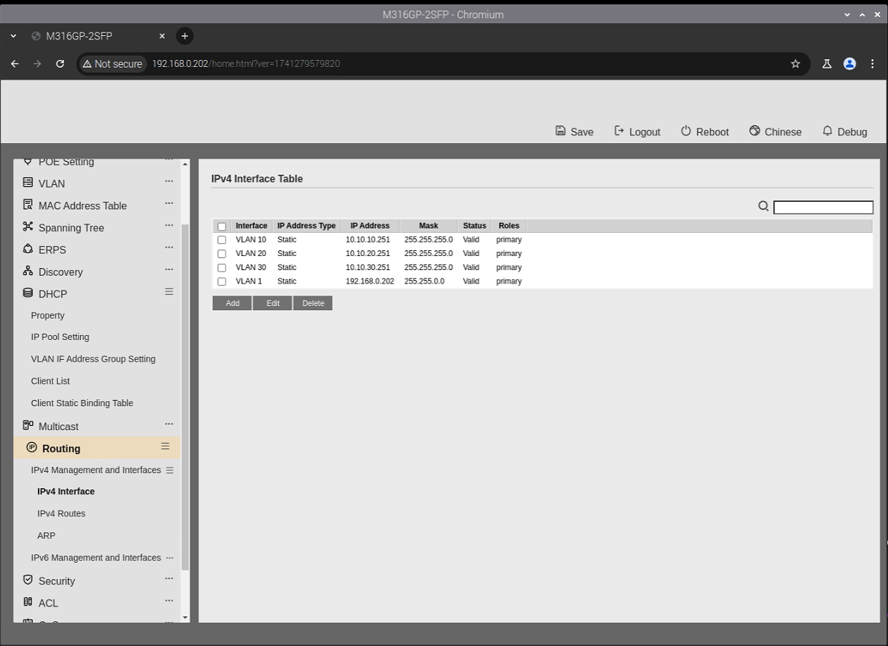

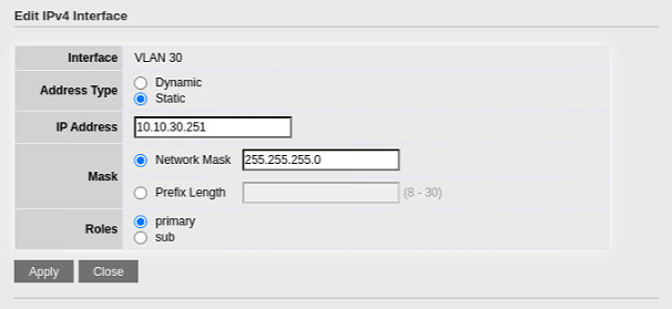

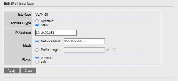

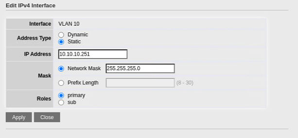

6. Define VLAN Routing
Navigate to the Routing / IPV4 Interface section.
Create a new VLAN route for each of the three VLANs.
The Network Mask typically is 255.255.255.0 or a 24 subnet mask as more addresses are hardly ever needed.
 AddVLANRouting1
 AddVLANRouting2
AddVLANRouting3
When done it should look like this.
 AddVLANRouting4

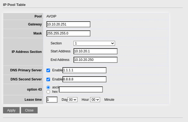

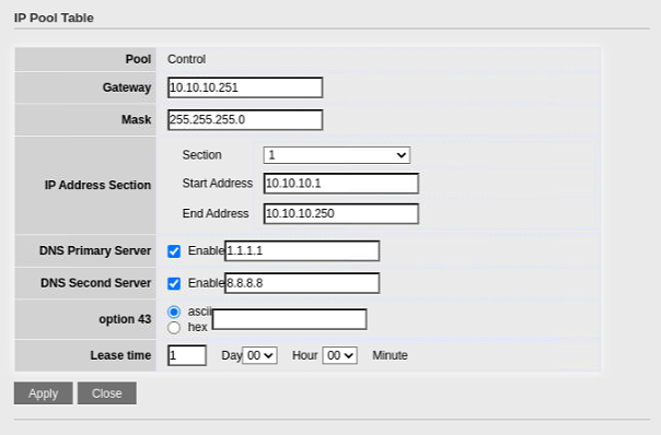

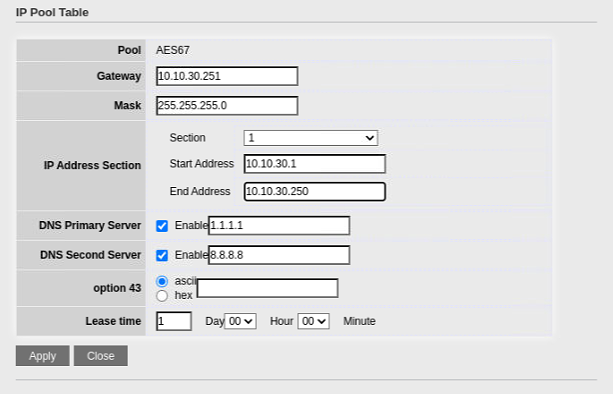

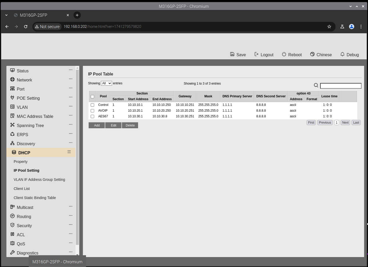

7. Setting up VLAN DHCP
Navigate to the DHCP / IP Pool Setting Section
Add a new DHCP Pool for each of the VLANs.
Note: the "Control" VLAN Gateway should be 10.10.10.249 to route to the myServer 6 controller's IP (that gates the requests to the house network).  The picture below is wrong.  The VLAN 20 and 30 Gateway should be .251 as they don't require access to the Internet (via the house network).
 AddVLAN DHCP1
 AddVLAN DHCP2
AddVLAN DHCP3
When you have defined all three VLAN pools it should look like this.
 AddVLAN DHCP4

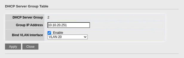

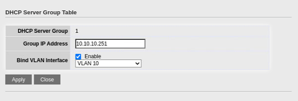

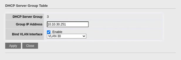

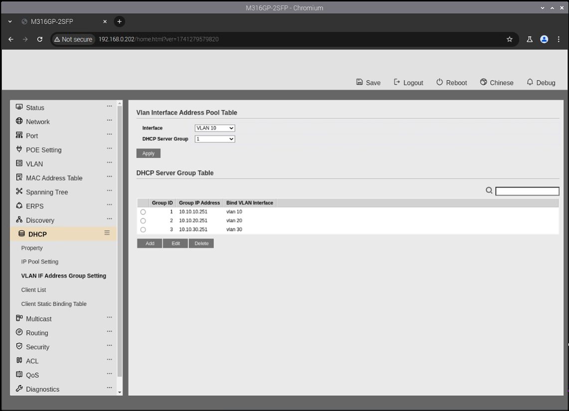

8. Binding the VLAN to the DHCP Group
Navigate to the DHCP / VLAN IF Address Group Setting section.
Add three new bindings.
 AddVLAN Binding1
 AddVLAN Binding2
AddVLAN Binding3
When finished it will look like.
 AddVLAN Binding4

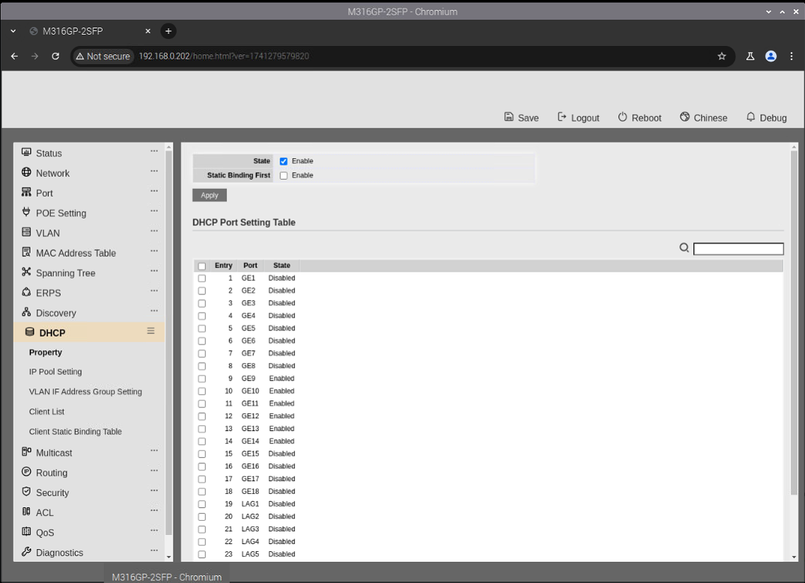

9. Enabling DHCP on the switch and ports
Next go to the DHCP Property page and enable DHCP on the switch and ports
 EnableVLAN DHCP1
 After the devices have their DHCP addresses, highly recommended to save them to the MAC tables so the addresses don't change.

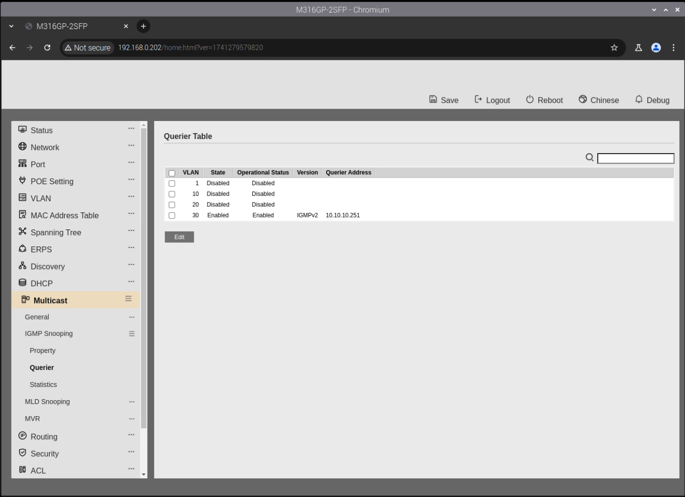

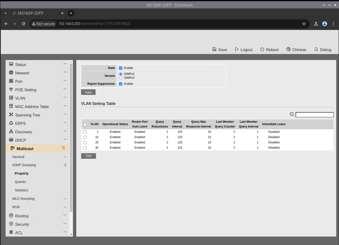

10. Multicast and IGMP Snooping
Navigate to the Multicast / IGMP Snooping / Property page.
Enable IGMP Snooping on the switch and each of the VLANs.
It should look like this.
 AddMulticast IGMP1
Then go to the Multicast / IGMP Snooping / Querier section. Enable the querier on the AES67 VLAN.
 AddMulticast IGMP2
This completes the configuration of the L3 switch. Make sure to SAVE this configuration on the switch so that it be retained between switch power cycles.  Recommended is to Backup the configuration so you can apply those same settings to a replacement switch (if needed).
