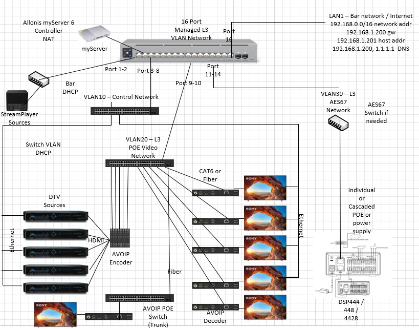

Example of a multi media network including Control, Video Over IP, AES67 digital audio VLANs:
DigitalMedia Networking 1
In this example the myServer controller is dually being used for control automation but also for NAT translation so the various downstream devices can access the Internet via the LAN1 (the "Bar's Network").
VLAN 10 is Control that also need access to the Internet (for content or updates)
VLAN 20 is Video Over IP
VLAN 30 is AES67 devices
VLAN 40 is for Control devices that do NOT need access to the Internet - like for TV on / off integration (prevents unauthorized firmware updates)
Each VLAN keeps it's content to it's own network which keeps the content from congesting the other networks.
myServer needs to be a member of all of those networks so it can control the devices on the respective networks.  myServer's ethernet network interface is "tagged" to be a member of all VLANs.
The Control network is for items like:  DirecTV receivers, TVs to control power on / off, streaming devices that not only need to be controlled, but also need access to the Internet for streamed content.
In this example the "16 port" L3 switch manages the different VLANS and particular ports are assigned to the specific VLANs.  VLAN particular downstream switches are then connected to those ports that connect to the VLAN specific device types.
Address reservations via DHCP are managed by either the "16 port switch" or via myServer's built in DHCP server.  All Devices can either be Static IP addressed, or DHCP reserved (so the addresses never change from what is assigned).
