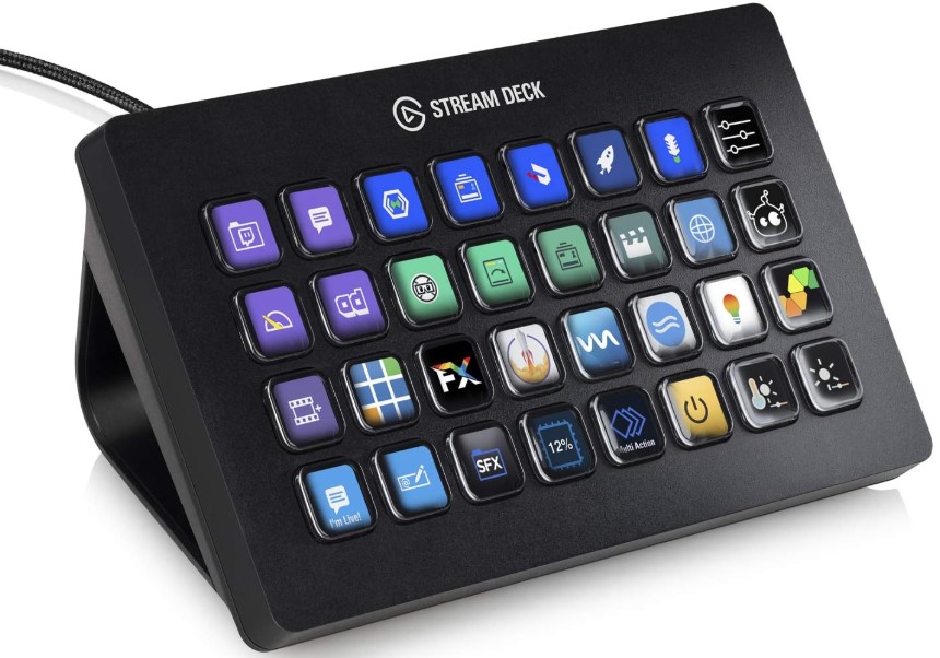

StreamDeckXL 1
ShotBox in Action  (shows a StreamDeck + controllering Allonis's Digital Signal Processors)
The button text and background color can be controlled via variable values set in myServer.  The button pushes are received by myServer and can control "anything" that is supported by myServer's large list of device drivers (including within HomeAssistant or Harmony Hub etc)!
The Shotbox will support multiple brands of shotbox button hardware.  Initially the ShotBox driver supports Elgado's neat StreamDeck line of interfaces.

The StreamDeck USB connected devices can be connected to either a Windows PC or a Raspberry Pi, or a myServer Raspberry Pi controller directly.
So:  StreamDeck interface <> USB cable <> Raspberry Pi <> ethernet (or WiFi) <> myServer controller <> devices to control
The new StreamDeck Studio is a POE powered ethernet device which further simplifies connection:
StreamDeck Studio <> ethernet POE switch <> myServer Controller <> devices to control.
Multiple StreamDecks can be used with one myServer controller (different rooms, or multiples in a room that has lots to control).
The USB StreamDecks can also be connected to the myServer controller via a powered USB / Cat5 extender cable.  We have tested several and have ones that work for this application.
