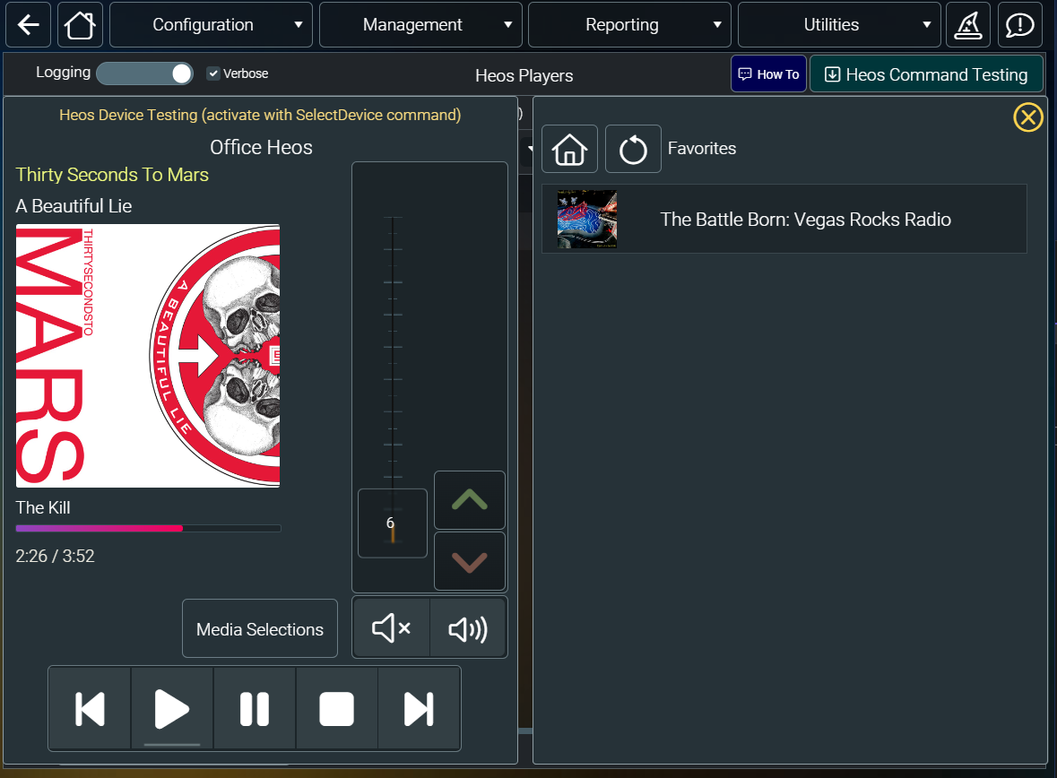

Example:  Asssign a Sonos Favorite to a button
 This example involves some fishing. Create a Sonos Favorite and it should show up like this:
If you then turn on verbose logging on the driver and click on the favorite to play it the log shows this
From the log grab the sonos:// url
 sonos://browse/play_stream?pid=2117691565&sid=1028&mid=4586579727037038354&name=The Battle Born: Vegas Rocks Radio
Then using the drivers Test command add this command to a button:
AV|{{active_sonos_{{clientname}}}}~Test~sonos://browse/play_stream?pid=2117691565&sid=1028&mid=4586579727037038354&name=The Battle Born: Vegas Rocks Radio
Clicking the button will now start playback of that favorite.
