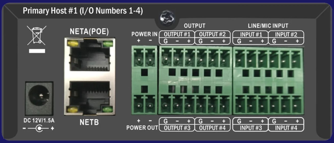

In most Allonis's systems, recommended is to use the 1.5U modular case to house the DSP444 and SP4428 (one to three per rack case).  A typical bar system would be myServer 6 automation controller on the left side, and a 4x4 DSP4428 on the right side of the case.  You can also put the DSP4428 on a shelf.
Each DSP4428 must be connected to the "audio ethernet network".  This network can be dedicated to just audio, or can be shared with the "Control Network" since audio doesn't really consume huge amounts of network bandwidth like digital video does.  Use (for example) a "Ubiquity" quality network switch with AES67 prioritized data packets to minimize chance for "choppiness" in the audio feed.
By default, the DSP gets it's initial IP via the DHCP server on the network.  They communicate (and can be discovered) via UDP on port 8999.

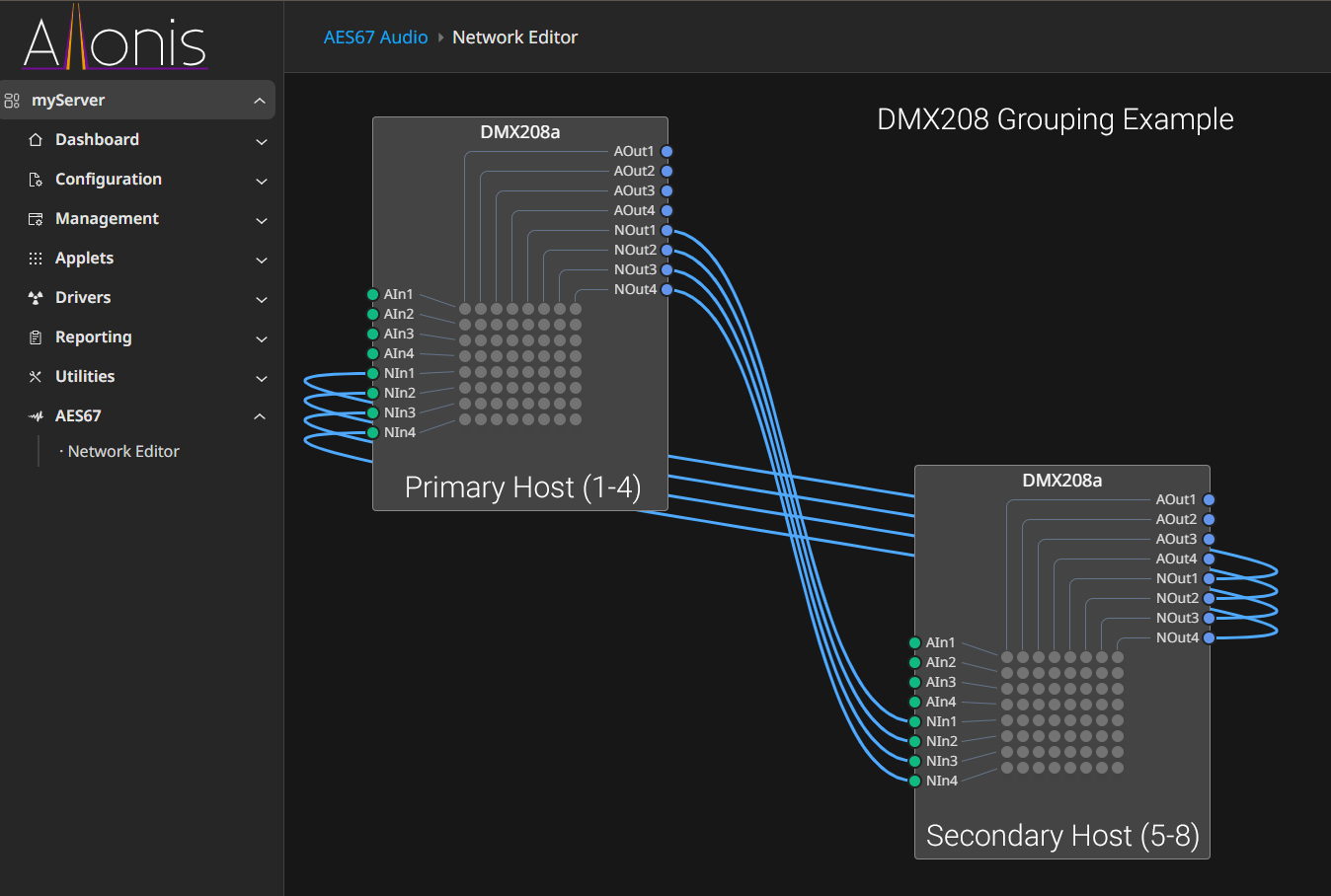

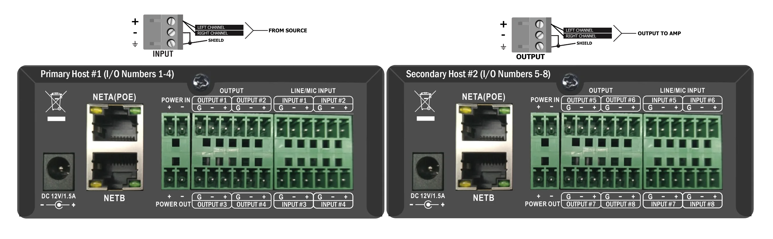

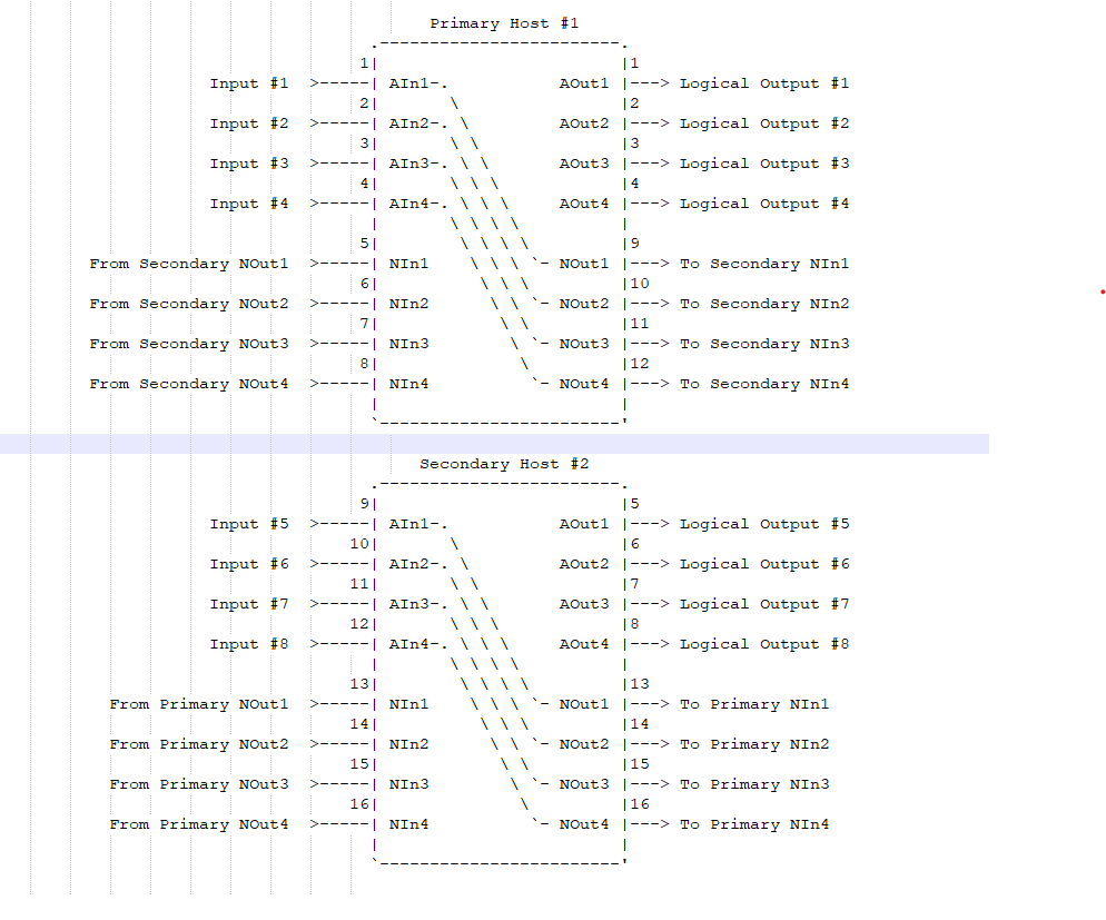

To give you a visualization of how the two DSP's need to work together.  The first is a logical network view of how they are wired. The second is a view from the DMX router's perspective. In order to get the analog signals from each DSP to its partner the analog signals must be routed via the network ins and outs. We'll end up with a logical 8x8 analog switch but there is a lot of steering logic happening in the driver.

Physical I/O is the actual named ports on the DSP.  Logical I/O describes what the system uses for inputs and outputs.  So, in an 8x8 system (2 DSP 4x4s), there are two sets of Physical ports.  There is one 1-8 set of Logical ports.
We will call the first DSP the "Primary" and the second (ports 5-8 as "Secondary") Host.
The Host can be thought of as the device that has a ethernet NIC (the RJ45 jack).  The children of that Host come directly below that.  Inputs are listed, first, followed by Outputs.  Within Inputs, the analog Inputs show up first, followed by the network inputs.
Click on Network Routing View.
If audio routes have already been configured, you should see check marks on what Outputs are playing what Inputs (sources).  You can change those routes by clicking in the appropriate empty box, to command the system to change which sources the Outputs are playing.  Note that is you have more than one DSP444, that you can route "Source1 Analog" to "NetIn1" on the Secondary DSP (Secondary "host").  This then shares the Primary Source1 to the Secondary DSP444 host.

All of your AES67 Discovered devices should populate this dynamic table.  If your devices are grouped ("two DMX4x4s grouped becomes one 8x8 matrix"), making changes here will change those group definitions.

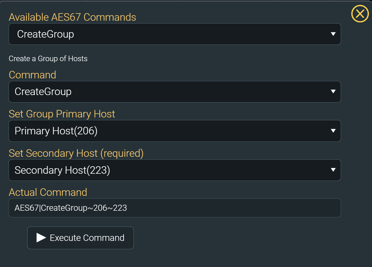

Grouping DSP444(s)
 dmx208 duo
dmx duo create
dmx duo layout
dmx duo routes
