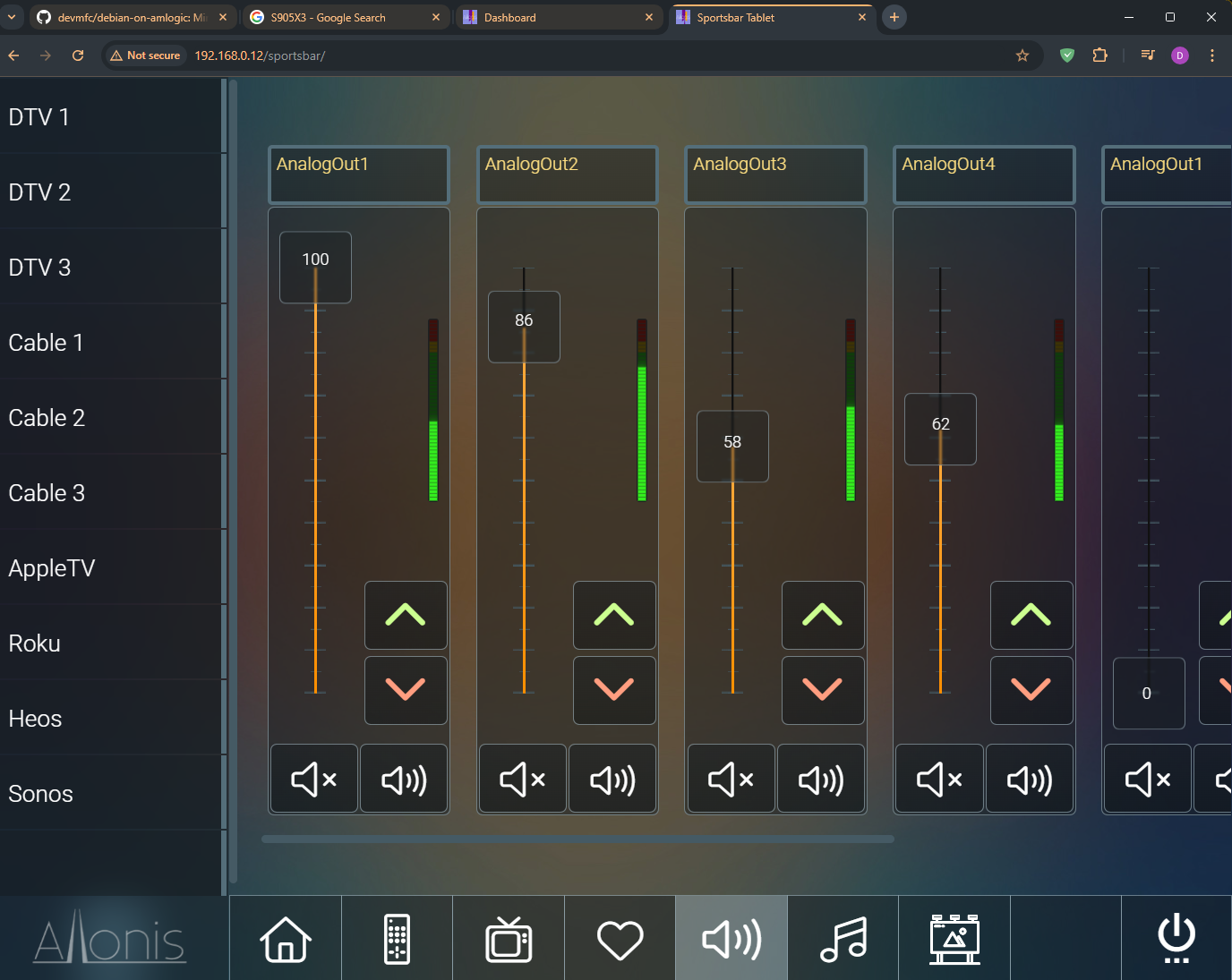

The myServer 6 driver is very comprehensive in it's support.  You can setup an audio matrix system, including michrophone ducking, and page steering.  It is intended as an end user interface, not an audio engineers interface due to it's designed simplicity.
vu customer
vu dashboard

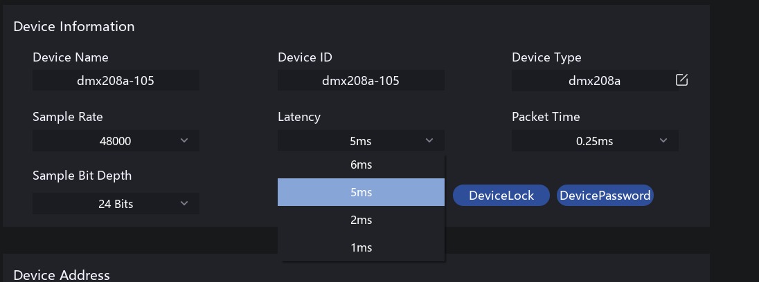

 Networking
You can increase the latency in each DSP444
It is necessary to increase the latency of data packets in the network settings to prevent untimely delivery of packets, which may cause each processor to discard them.
LatencySetting1
Alternatively, there might be other mixed devices on the network, such as CCTV cameras, that require raising the priority of audio stream data packets. This can be set in the "Status" settings.
PrioritySetting1
The higher the number, the higher the priority.
You can configure inter-VLAN communication on the switch. As long as you can ping through, audio unicast streams can be transmitted. If you need to multicast across subnets, you will need to configure PIM-DM on a management switch.
Open the DSP444 packet arrival schedule to check if there are any red bar graphs indicating packets that did not arrive on time.

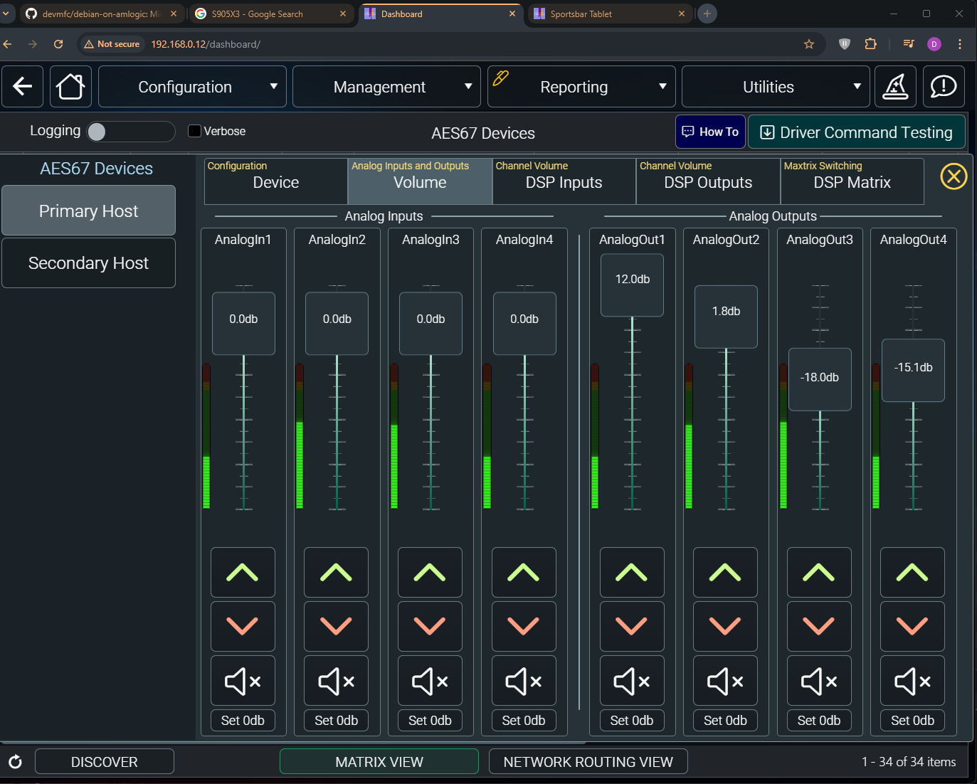

 Matrix View
Volume tab
Best strategy is to change Input volume(s) to balance the sources to be same volume.  The Analog Outputs shoudl be used to change the volume in a "Zone" ie: don't use the Analog Inputs for most cases.
DSP Inputs Tab
Suggested is to leave these at 0.0db (100%) for most system setups.
DSP Outputs Tab
DSP Matrix Tab
Displays the volume settings for both Inputs and Outputs.  It also displays current routing of devices.  If you click on the table cells, the routing commands will be sent to those devices.  If you have two or more DSP444's setup in Group mode - high recommendation not to change anything in these routings or it will break the group definitions.

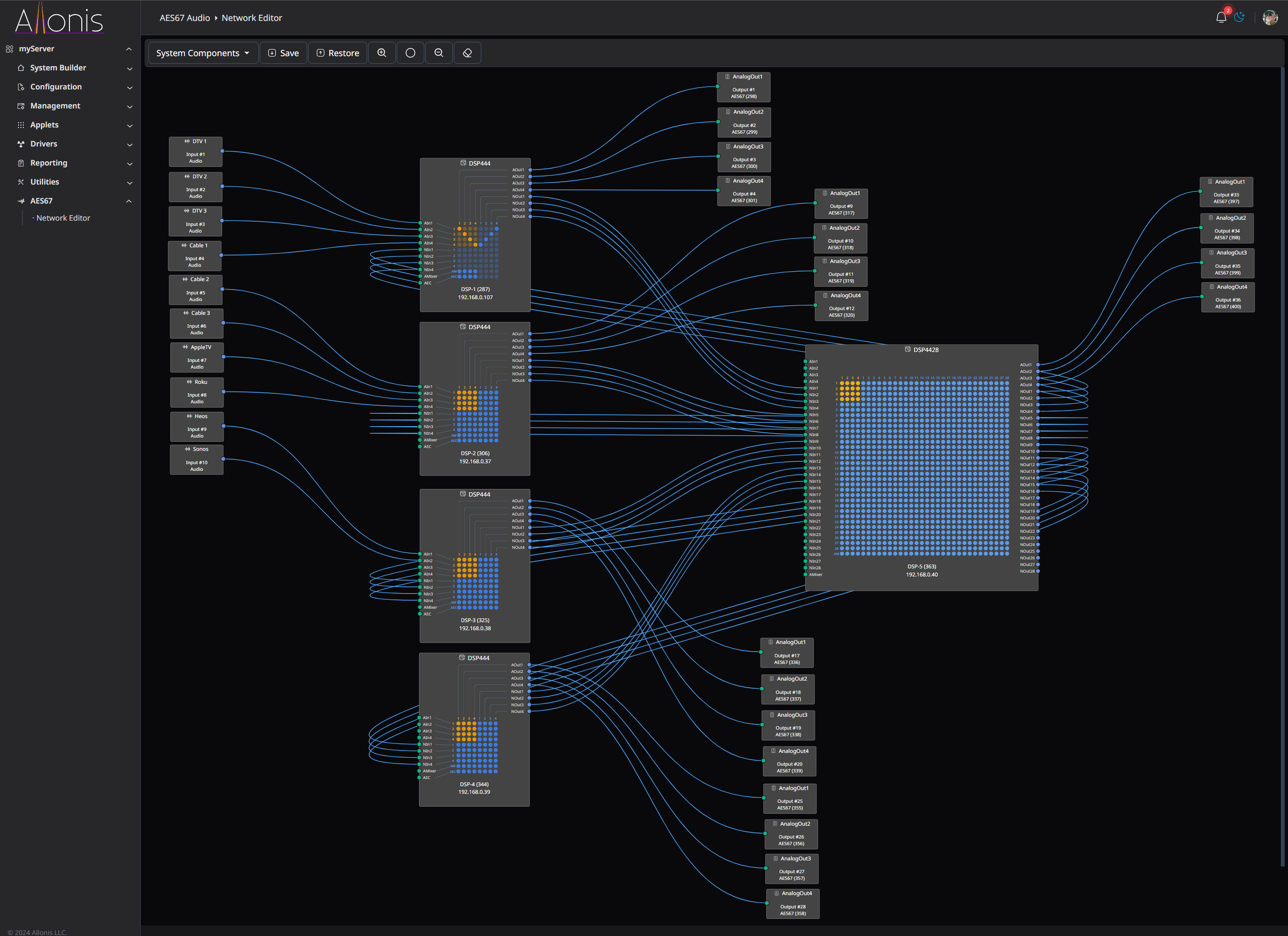

Grouping DSP444(s)
dmx208 duo
dmx duo create
dmx duo layout
dmx duo routes
There are 6 different AES67 configurations supported that will create an audio matrix in 4x4, 8x8, 12x12, 16x16, 20x20 and 24x24 geometries.
Devices (hosts) will be named DSP-1 to DSP-n.
Since each DSP444 or DSP4428 are standalone devices, they will be discovered in a random order and their default input and output numbering will also be defined by the order they are discovered. By itself this leads to chaos.
To bring sanity into play these devices must be logically grouped to define a single matrix.
The driver has a CreateGroup command that will be used for this purpose.
There MUST be a standardization on the physical layout of these devices as they sit in the chassis and have a way to map them to DSP-1 to DSP-n.
Please review the attached spreadsheet as it has a tab dedicated to each proposed DSP configuration.
The customer is only interested in input and output numbers and you’ll see that each configuration keeps those numbers in sequential order.
The driver needs to work with the network inputs and outputs as well as the analogs but these I/O numbers are not exposed to the user. We use our own private numbering scheme for them.
The inputs labeled AMixer are how ducking is controlled.
