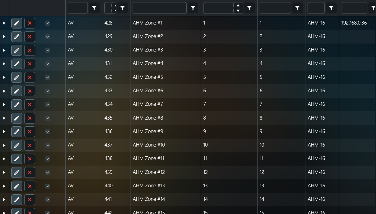

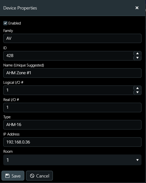

The first device should be setup with the Audio matrix IP address like:
When you have all of your devices configured, it should look like:
Note the first matrix the Logical and Real IDs are the same.  For subsequent matrices, the Logical would be "17" and the Real ID would be "1" (if the first AHM was 16 outputs).
