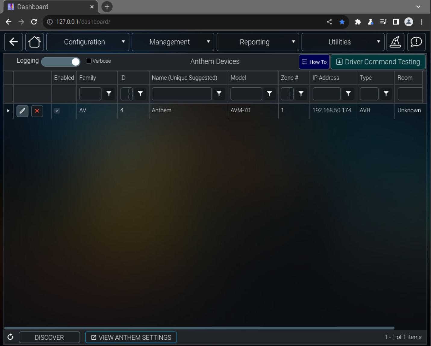

Make sure your Anthem amp is powered on and on the network. Click on the Discover button to start the discovery process.
After a few seconds your amp should be discovered.
Anthem2
Please confirm that the correct model Anthem was discovered. If not please let tech support know.

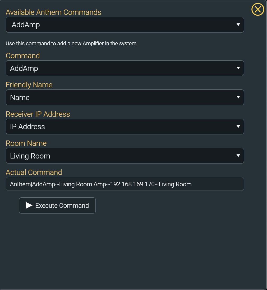

You can also manually add the amp via the driver's command builder AddAmp command.

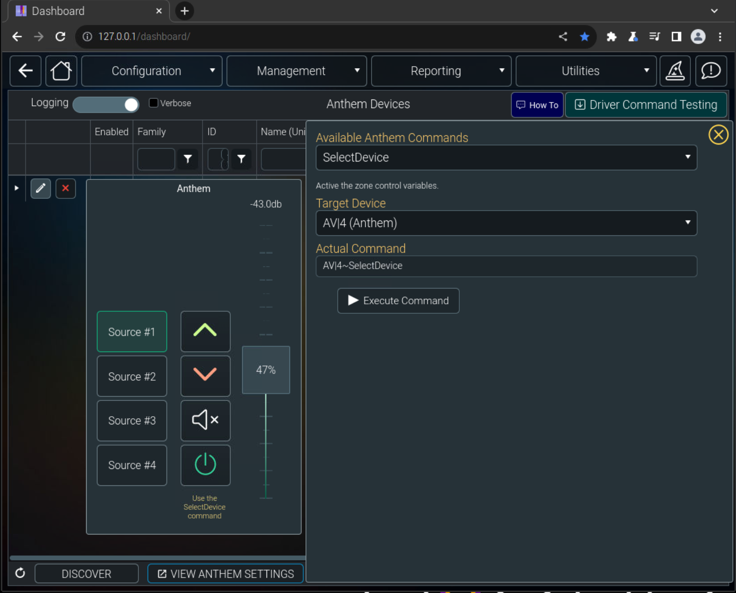

Amp Testing:
You can test basic  amp functionality directly in the driver. From the command builder execute the select device command. Use the exposed controls to the left of the command builder to test communication with the amp.
Anthem4

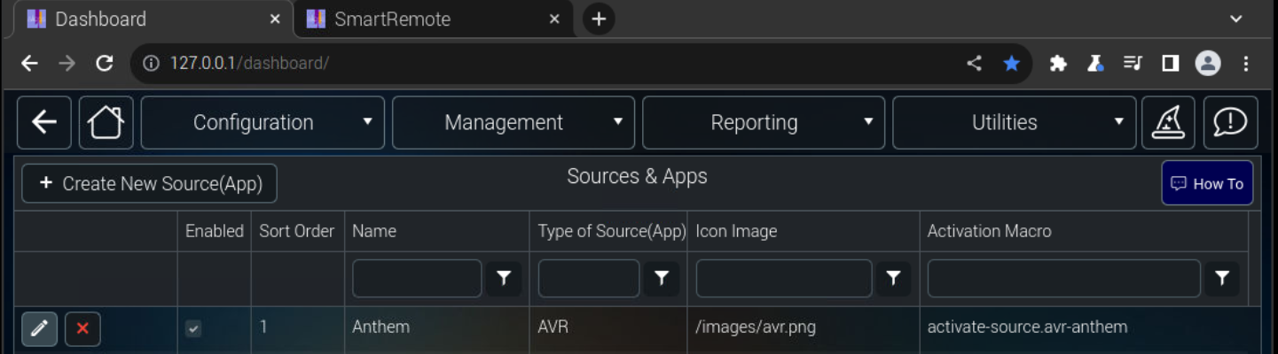

If you look in Configuration / Sources & Apps you should see that a new source has been added.
Anthem5

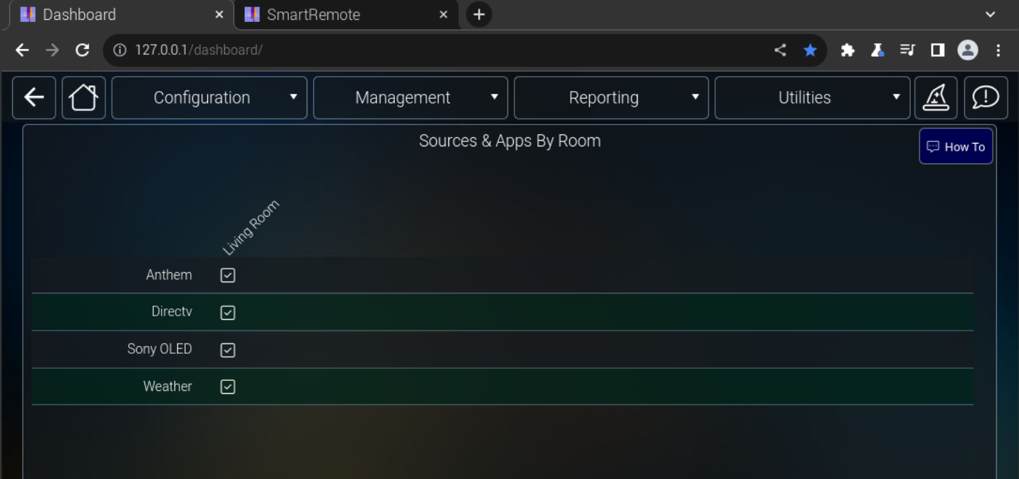

From Configuration / Sources & Apps by Room you should see that it has been placed in the specified room.

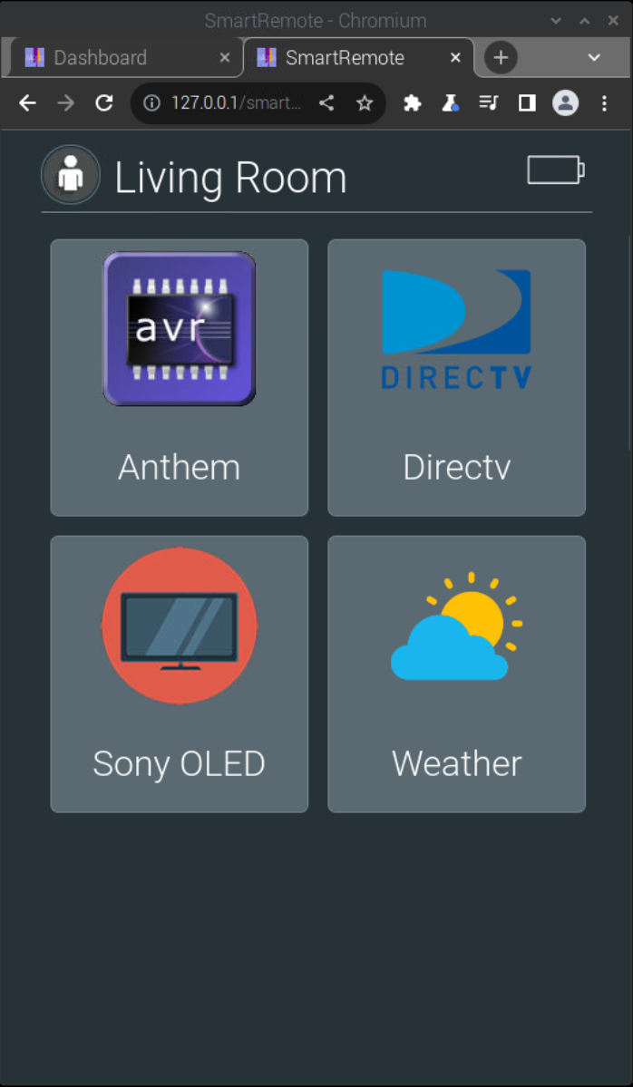

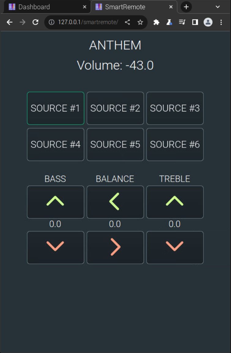

Navigating to the home page on the SmartRemote you should see a source entry for the amp under the AVR icon. Pressing the icon will bring you to the generic AVR page. Here you will have basic control of the amp. You are free to modify this page to suite your needs. The hard buttons will control volume, mute and power.

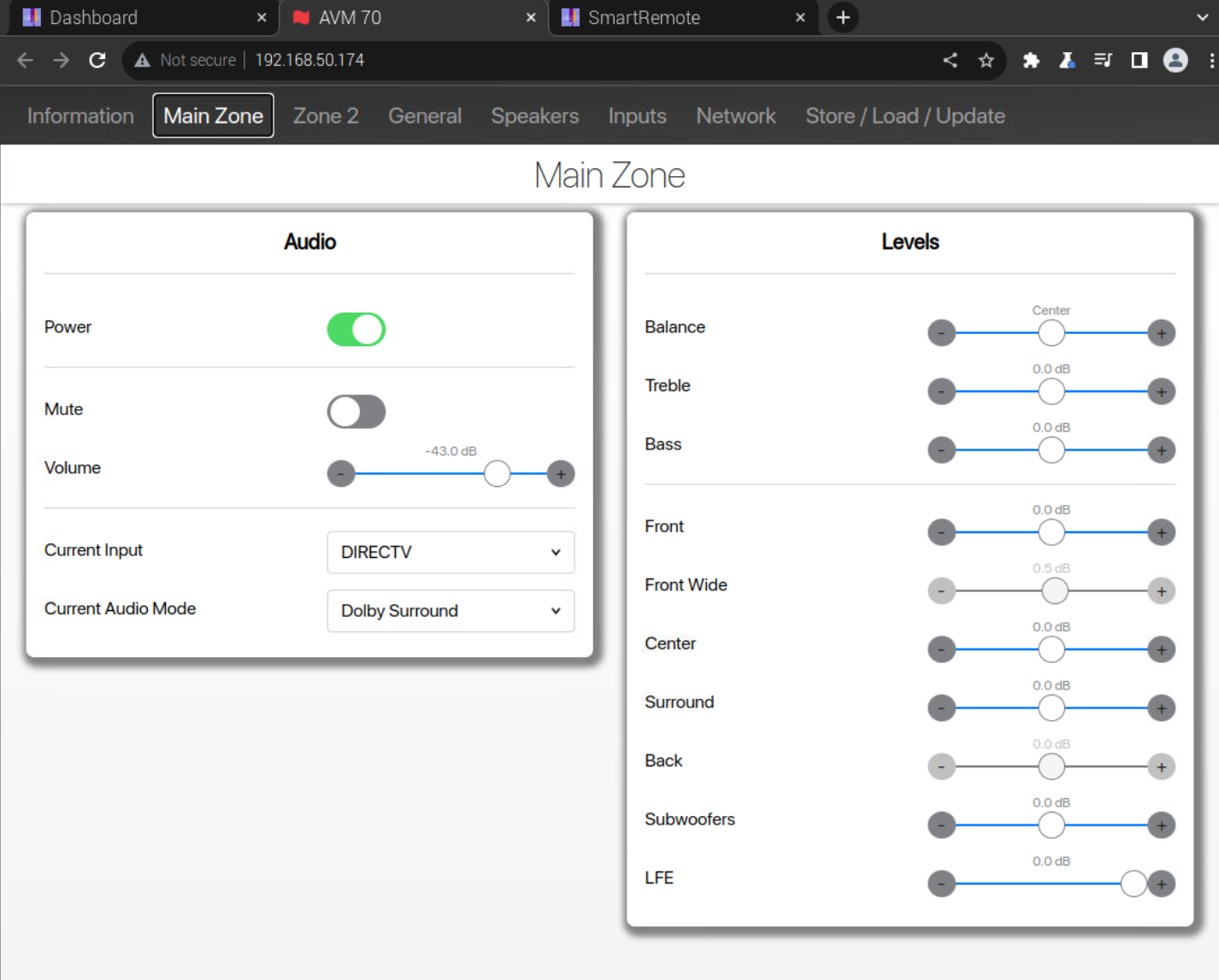

Amplifier Setup:
At the bottom of the Anthem driver page you will see a button labeled View Anthem Settings. Clicking this button will take you to the amp's configuration web page.
Anthem9
