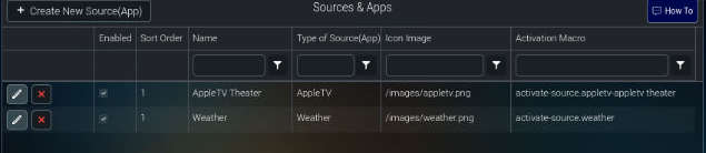

Create a new Source in the Sources & Apps webpage
Enabled, Sort order 1, Name = Weather, Type of Source app = Weather, Icon, /images/weather.png
Activation macro required name:  activate-source.weather
Save

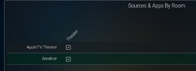

Go to Sources & Apps by Room webpage:
Enable the Weather source for the room(s) you want it to appear in:
