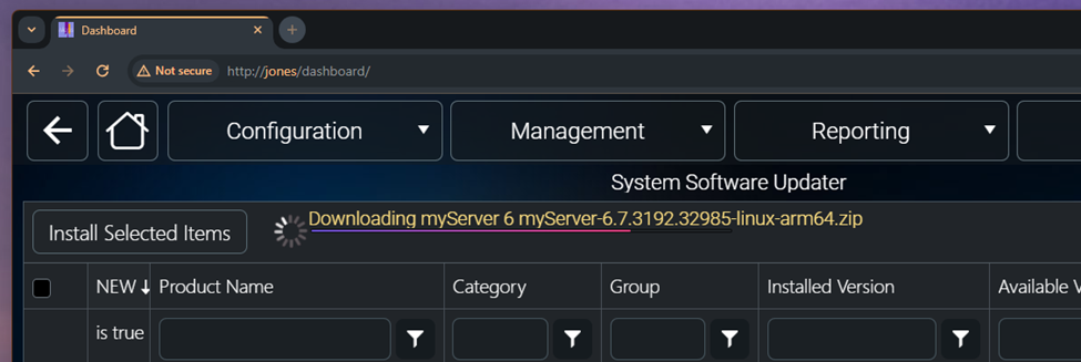

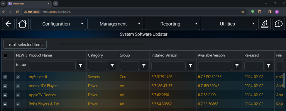

3) From the Utilities dropdown on the Dashboard select the Software Updates option.
Software Updates
This will bring you to the System Software Updater page.

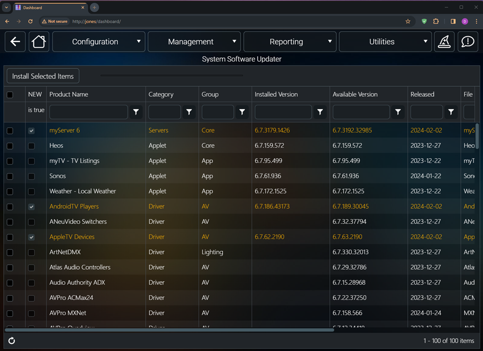

This table represents a comprehensive list of all the myServer components available for installation. The list is organized by type of software component, Applet, Driver or Template.
When an update is available for a software component that is already installed the item will be shown in a bright amber color. You can also compare the latest version number with the available version number. Double check that you are on the latest myServer 6.8 version (it might not be highlited).
4) If you double click on the column header labled NEW you will see all the available updates grouped together.
5) Here we’ll check off all of the items to update. (meaning ONLY the Whats NEW - not ALL drivers...)

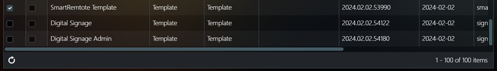

6) Download the latest Moonlight Tablet and Moonlight Smartphone templates. We also need the latest SmartRemote sample template. Make sure you scroll the software list to the bottom and mark the SmartRemote template to also be installed. Note: Allonis templates are licensed so you may need to add (purchase) additional device licenses for templates and devices you have installed. If you exceed your current allocation, remove the unneeded template from the wwwroot directory and restart myServer. Note that the SmartRemote (as example) template downloads as "smartremote-sample" so it doesn't overwrite your "smartremote" in use folder. Initially, you should copy the smartremote-sample to the simpler, smartremote folder name. This can be done using myDesigner or more simply, via the Raspberry Desktop File Manager.
Recommended is to download the Weather app, and the AndroidTV driver. The SmartRemote runs AndroidOS and the AndroidTV driver allows for connection to it.

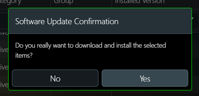

7) Now click on the Install Selected Items button to begin the software update.
8) Select Yes to confirm you want to update the software
You see the progress indicator showing the status as the components are being downloaded
When the all the components have been downloaded you will see the toast message that the server has been restarted and is ready for use.

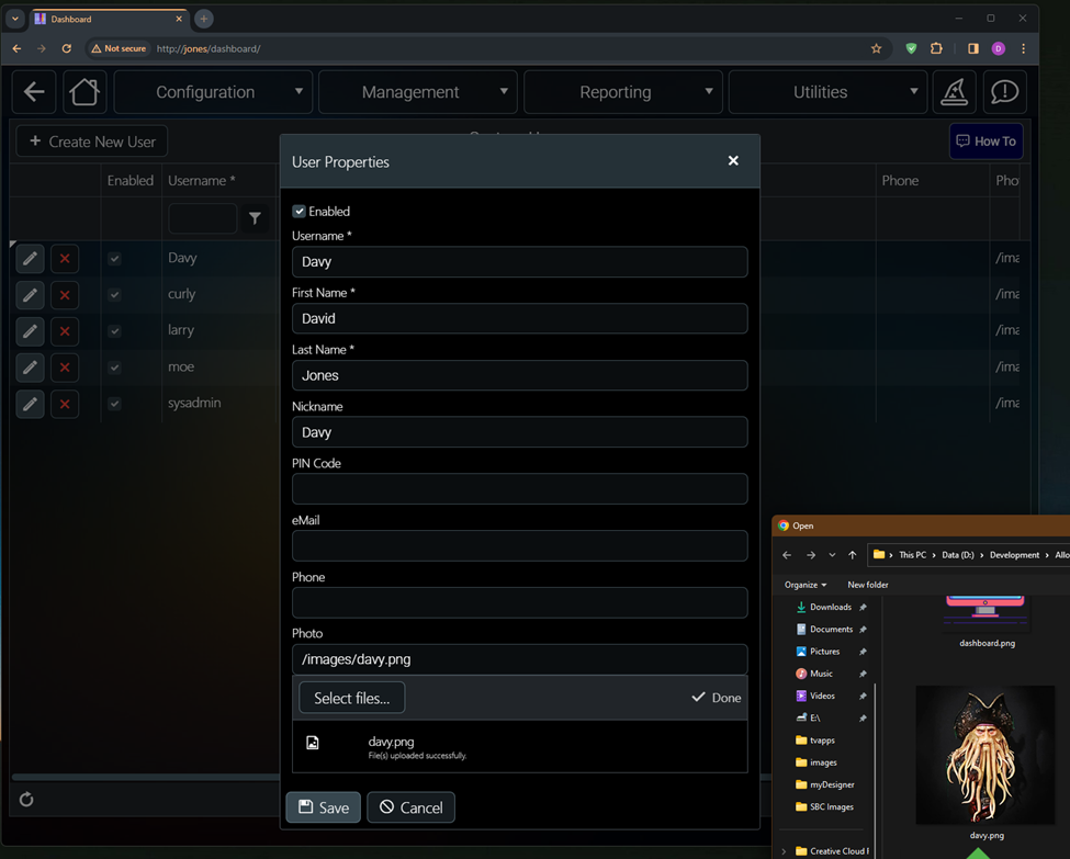

1) From the configuration menu dropdown select the Users option. You’ll see that we have already defined three sample users and an administrator user named sysadmin. The sysadmin user is required but you are free to remove the "three stooges" and add your own users.
2) To create a new user simple click on the Create New User button.
The required fields are username, first name and last name. There space for a avatar photo too.
We’ll add my cousin Davy.
Repeat for as many other users you would like to add.

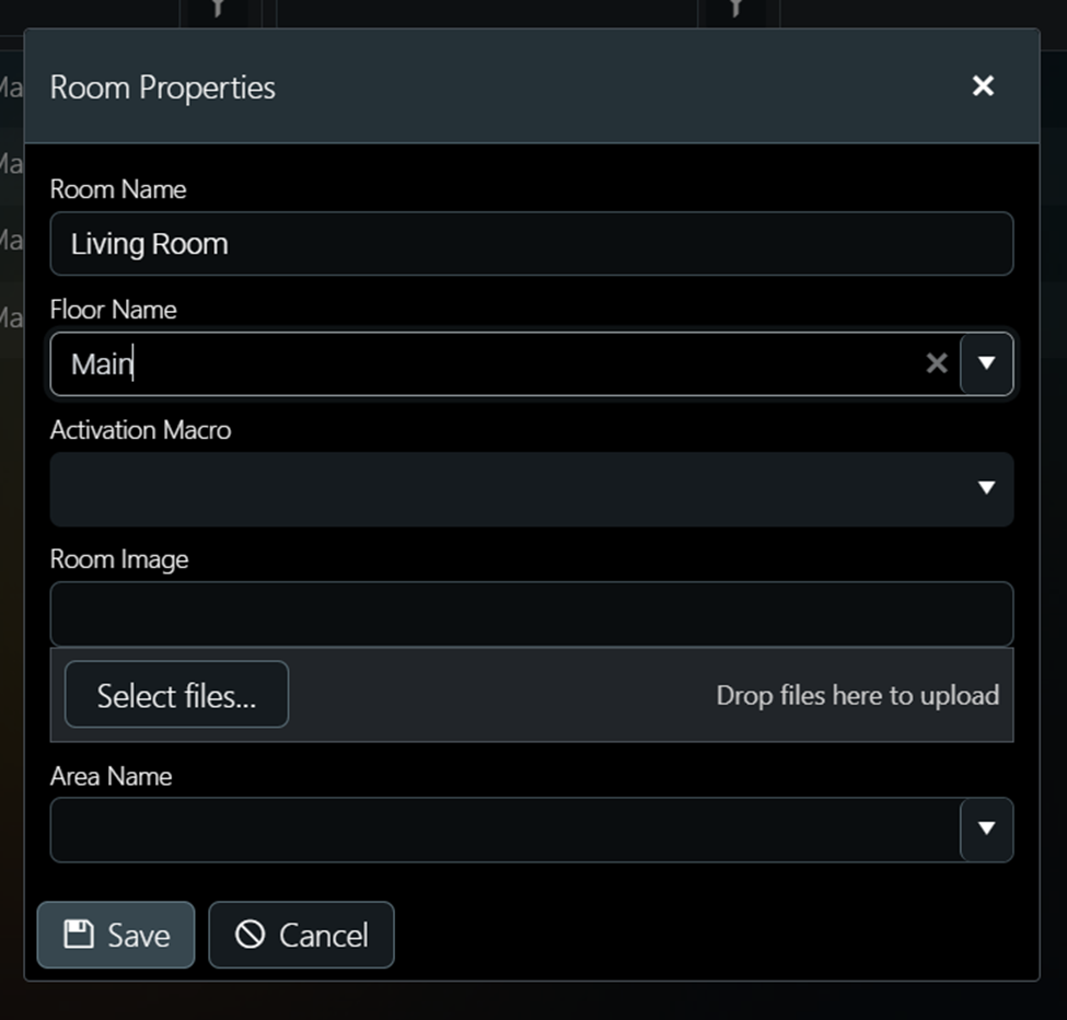

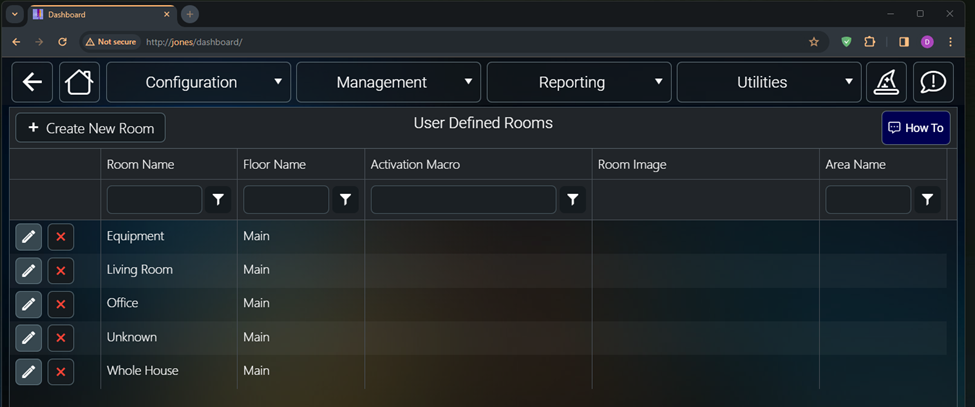

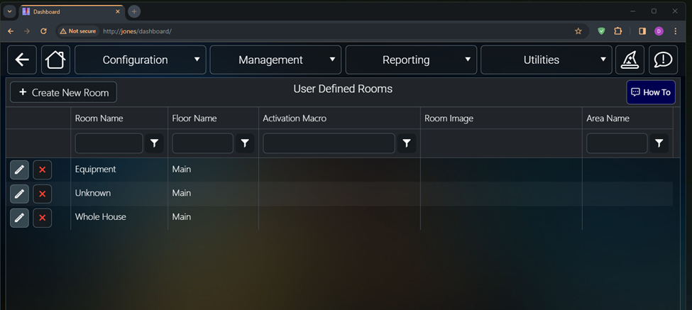

Next, we will add our rooms. From the same configuration menu dropdown select the Rooms option.
We mentioned previously that we will be adding devices into the Living Room and Office. So now we will create those two rooms.
3) Click on the Create New Room button.
The only required field is the Room name. Everything else is optional. Floor name and Area name can be useful later on if you want to perform action based on devices that are on a particular floor or area; for example, select all the lights on the main floor and turn them off. That’s a more advanced topic and we’ll save that for another time. The activation macro field will automatically be filled in by the server.
The "Unknown" and "Equipment" rooms are required by the system. Don't edit, or remove them.
We’re done with rooms for now. We’ll start configuring devices next.

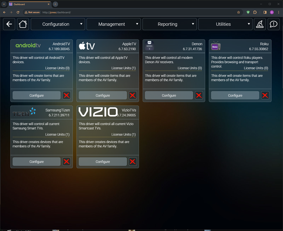

1) From the management menu option select the Drivers option. This will bring you to a page that will display a series of tiles. One tile for every device driver you have installed.
Next, we have to go into each driver and add the devices that each driver is responsible for controlling. Nearly all the drivers you will be using have auto discovery features that will search the network and automatically add them into the system. Optionally you can manually add the device using the build in command building option.

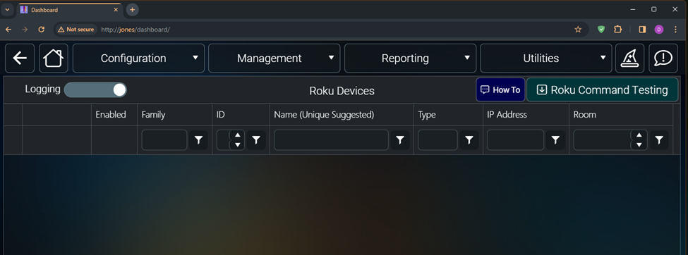

2) Lets, configure Roku. Click on the Configure option on the Roku tile. We start with an empty list. Note for most drivers, you can click the "How To" and get to the driver's support web page.

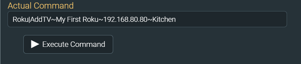

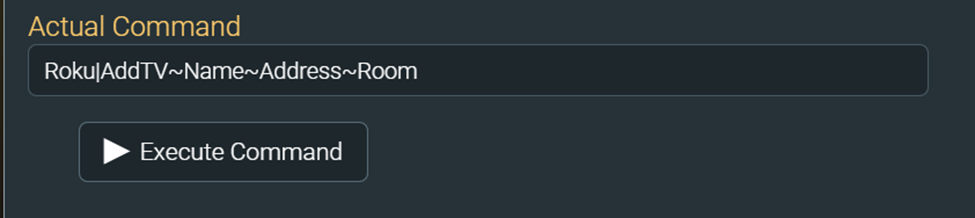

3) If you wanted to manually add a roku player you could click on the Roku Command Testing button to expose the command builder. From the dropdown select the AddTV option. You’ll see that the command to add a Roku player or TV takes three parameters. A name, and IP Address and a Room Name.
Change name address and room to the actual values. Like:
4) Click execute command and the new Roku player will show up in the list.

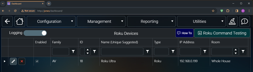

BUT, there is an easier way. Click on the Discover Roku Players button on the bottom of the page and after a few seconds all your Roku players should automatically show up.

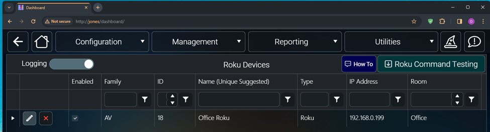

When a device is automatically discovered we won’t know what room it is in. You will have to edit the device by clicking on the pencil icon and put it in the correct room. Also you should give this player a unique name so that it can be easily identified. This Roku is in the office so we’ll make the following changes.
5) Click save

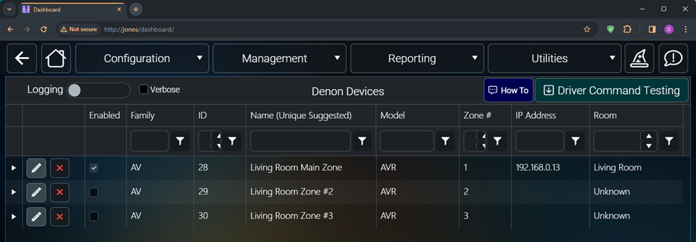

Denon AVR in the Living Room

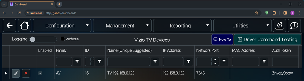

And the Vizio TV
