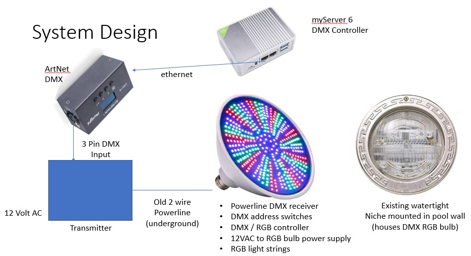

Here is the typical wiring that exists:
12 or 110 Volt AC switch (dependent on bulb requirement) > underground wire > Hayward or Pentair standard sealed housing niche with incandescant bulb
We replace that with:
myServer DMX control system > Wifi > new Allonis lighting Wifi / Powerline DMX Transmitter to replace the old AC switch > Existing two conductor underground wiring > original sealed housing > Allonis new 12 Volt Powerline DMX RGB bulb
Transmitter:
Input: 12 volt AC power
3 Pin DMX
Output: Powerline to Receiver unit.
The new design provides extremely fast and precise color changing capability that has high output LEDs for good illumination.  myServer can than automatically control the lights and colors for time of day.  It is even possible to change the color and intensity to the beat of the music!
myRGBPool 1
 Specifications:
40 watts / 12V AC or DC. Recommended is a power supply that is 20% more.
E26 socket.  Par56 bulb type.
Recommended is to replace the existing Niche housing seal to ensure waterproof installation.  The RGB bulb is not waterproof on it's own.
