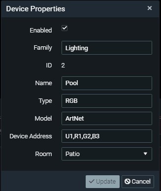

Add Device command:   Name the device, select RGB as the type, ArtNet as the Model, U1,R1,G2,B3 as the example Device Address and ensure that the ControllerID matches your DMX controller you just added.  Click Execute.  Note:  The U1 stands for "Universe 1".  Dependent on the DMX hardware controller, that might support one or more "universes" of addresses.
RGB DMX setup
