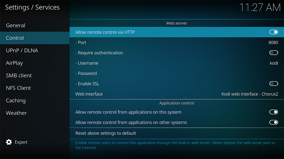

Install Kodi on your Windows / Linux / Android devices and within the Kodi Settings / Services / Control:
  • Enable remote control (on the device and also from network) which opens port 9090.
  • For images to be accessible to myServer, enable "Allow Remote Control via HTTP"  Password is not used / needed.
  • UPnP is not needed.
  • For Discovery to work (within myServer), you can turn on Kodi's Zero Config (requires Bonjour installed on the device).
  • You may also need to let Windows Firewall allow bi-directional port 9090 and 8080 traffic to the Private network (if Kodi is installed on Windows).

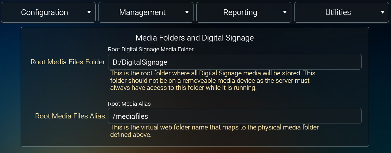

In Dashboard under Configuration / Media Folder change Root Media Files Folder to a valid folder. Or set it back to its default value /home/allonis/applications/myServer/wwwroot/media

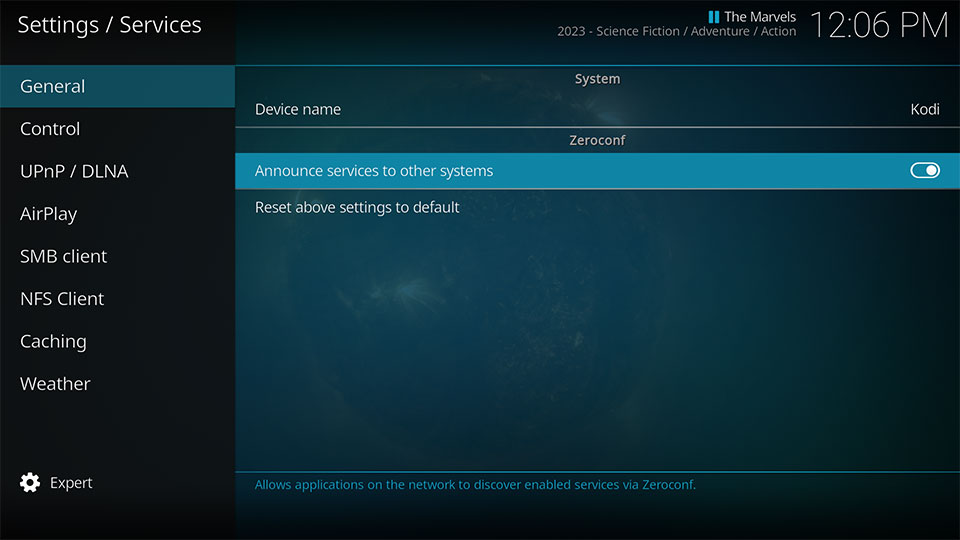

From within the Kodi app lease make sure that you have enabled ZeroConf discovery,  remote control via HTTP without authentication and also enable application control for both local and remote devices. See below.

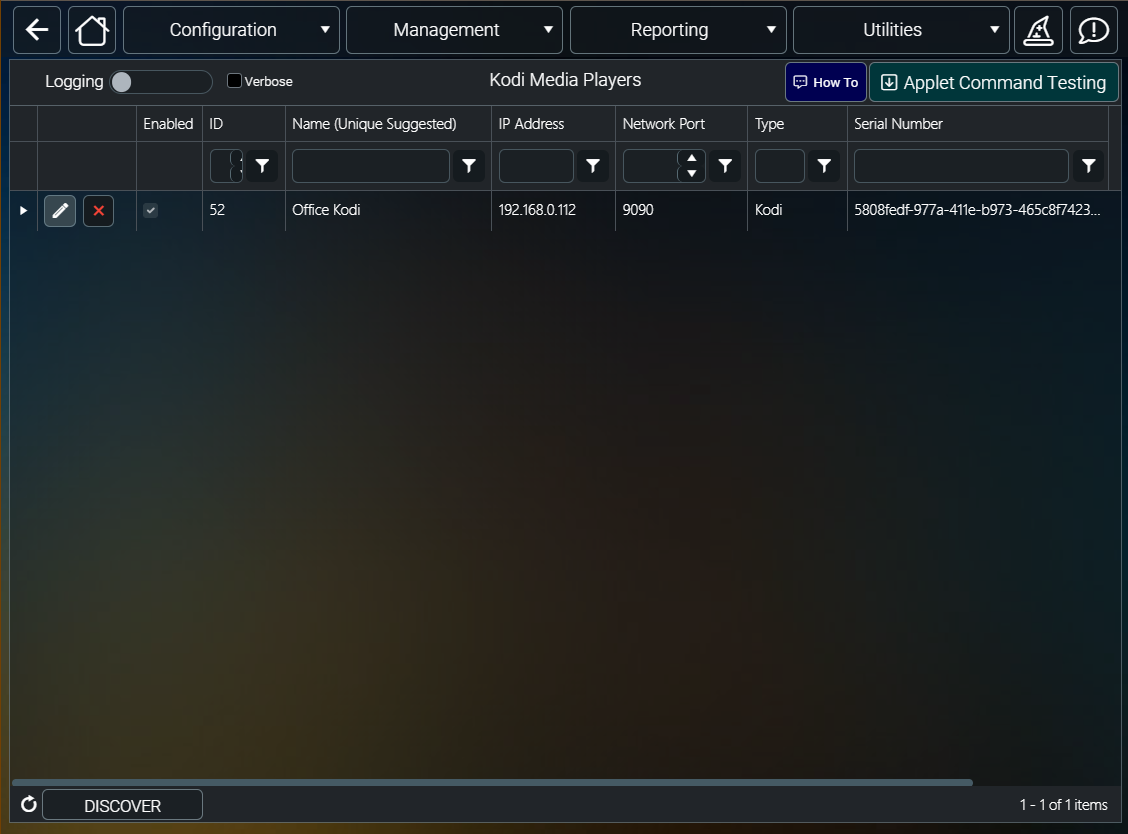

From the myServer Kodi drivers page click on the Discover button to allow the driver to find all your Kodi players. If some of your Kodi players are not found please make sure Kodi is running on the device and that ZeroConf is enabled. You also the option to manually add a player in the command builder. Discovered players will be put into the Unknown room. Please make sure to put each of the players into their appropriate rooms so that the required source activation macros are created.

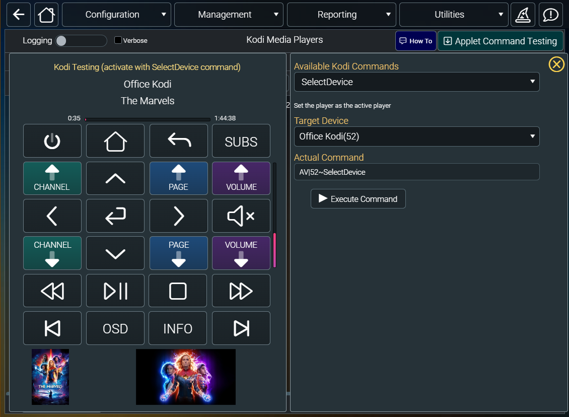

Initial Testing
After your players have been discovered you can test driver functionality by opening the command builder and using the SelectDevice command.  Once a player has been activated you can use the buttons in the left side panel to control the player.
kodi 4

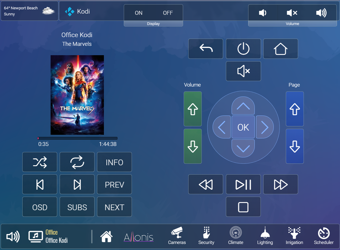

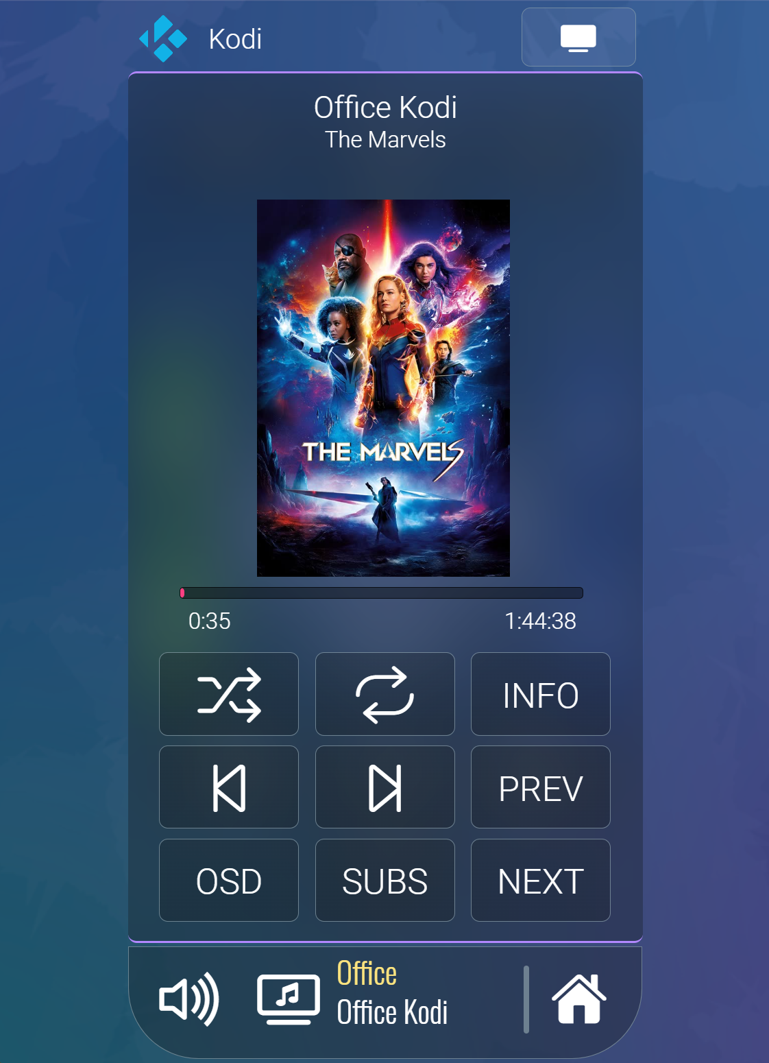

Moonlight Tablets User Interface
This is the sample page that you will find in the Moonlight project template.
kodi 7

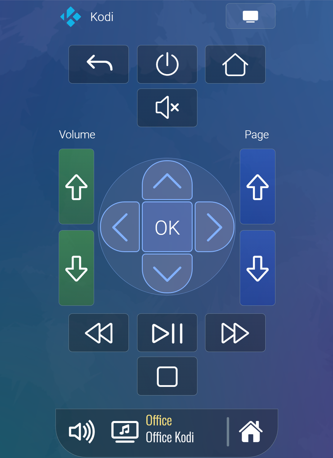

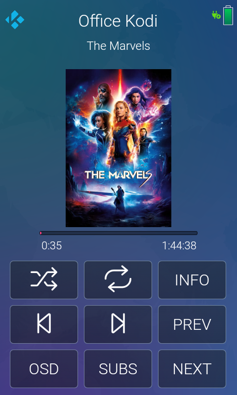

Moonlight Phones User Interface
This is how the Kodi interface will look in the Moonlight Phones project template. It is configured as a primary page with an overlay to support the additional buttons.
kodi 8
kodi 9
