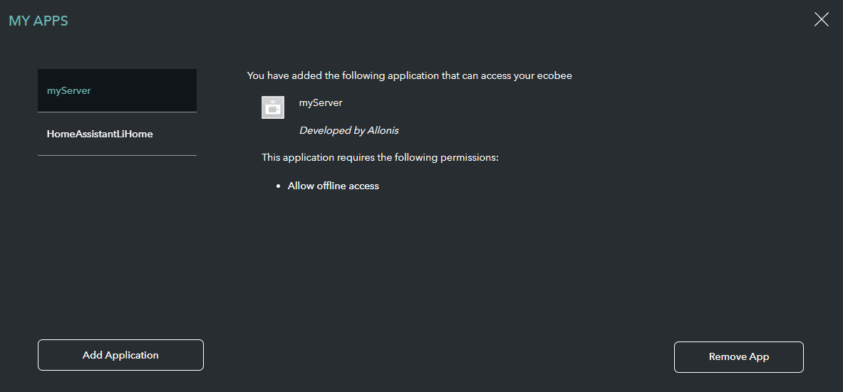

Click on Top right on the "Hamburger Menu" (with the person icon)
Click on "My Apps" link
Click on "Create New"
Click Add Application
Enter the 4 digit - 4 digit PIN code in the field
Click "Validate"
You should then see a success message.
