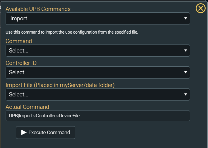

Put your UPB configuration file in the myServer/data folder, restart myServer, and invoke the command
UPB|Import~Controller~DeviceFile
to import your devices:
Once that is done, the standard Lighting Family commands can be used with your UPB devices.
