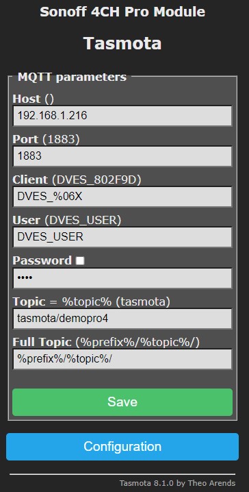

Click on Configuration button, then MQTT
Set the system up like:
Tasmota mqtt config 1
 name the device in the Topic ie: tasmota/name_of_your_device
Click Save.  Device will reboot.
The myServer 6 Tasmota driver should auto discover the new device.  It will name the device as per your topic name (demopro4 in the above example).
