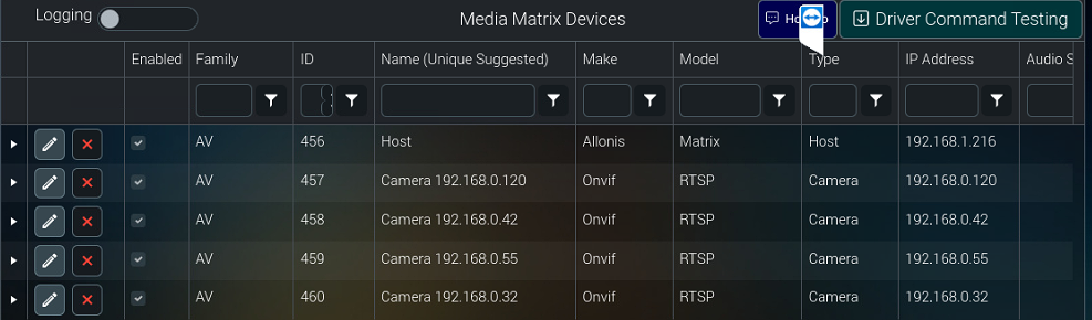

MediaMatrix|AddHost~Host~192.168.1.216~9997
After that AddHost command is processed, the driver will enable the host on that myServer controller.  In command builder, you will see that "Install MediaMTX" is now enabled (after 30 or so seconds).  Click on that to install and then the MediaMTX enginer status should now be showing as "Running".
The MediaMTX software is regularily updated, it gets updated via myServer updates.  If yours is running an older service, click the Upgrade MediaMTX button to update it to the later version distributed via myServer updates.
Click the "Onvif Discovery" button on bottom left to attempt to find compatible cameras on your network.
Click on the camera in the list you would like to process for.

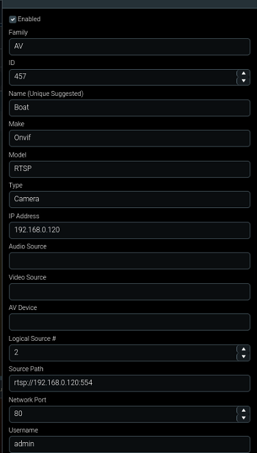

You likely will need to add the user name / password for that camera (towards the bottom of the device edit panel).
Depending on the camera, with this authentication information, the driver might be able to query the camera and determine it's "Source Path" and populate that field.  You many need to reopen the camera's Edit panel to see this new information.
On many cameras, theprimary stream is H265 encoded and we cannot process H265 yet. So switch to the secondary stream which might be H264 encoded.  On some of those cameras, that's the difference between configuring with a "401" in the url and the Streaming/channels/402 in the url (the second stream).
