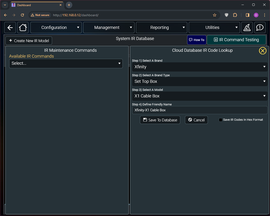

Navigate to the Dashboard Management dropdown and select the IR Database option.
Then click on the IR Command Testing button. From the right side Cloud Database Lookup choose the brand, type, and model from the three drop down selectors. Once you have found your cable box and its IR codes the text box in step 4 will show the suggested new name for the set of codes. Rename if you like and then click "Save To Database". This will download the IR codes from the cloud database to your local myServer database.
The codes will be downloaded and strored. Close the IR Command Testing to return the main IR page.

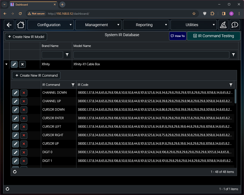

You'll see all the new IR codes that have been downloaded.
You will repeat this process for any other IR devices that you might want to control using infrared.

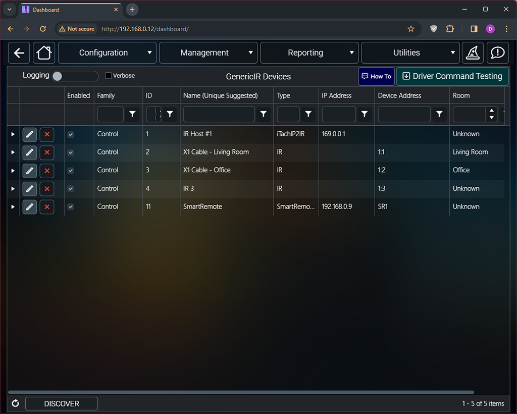

Once you have the IR codes you can advance to the GenericIR driver to define what devices will be used for sending these IR codes. Go to the Dashboard Devices page and open the GenericIR driver.
We currently support sending IR using Global Cache hardware or the SmartRemote. Support for other IR emitters may be added at a later date.
In our example we will being using a Global Cache iTachIP2IR for our emitters.
Make sure you have your Global Cache devices on the network and set for a static IP address. You always want to have all you equipment set to static IP addresses whenever possible.
You can manually add the iTach using the driver's command builder but it is easier to just let the driver find them. Click on the Discover button and let it run until it has found your IR devices.
Here we see we've found the iTach.
The three IR ports on the iTach were added using the generic names IR 1 to 3. We suggest taking the time to change the name of these devices to better match the device it will be trying to control. We have two cable boxes one in the Living Room and another in the Office and they are on IR ports 1 and 2. We'll make the following name and room changes to each of these devices.

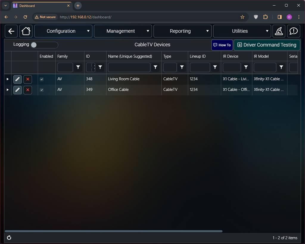

In the following image you see that we have added both of our cable boxes.

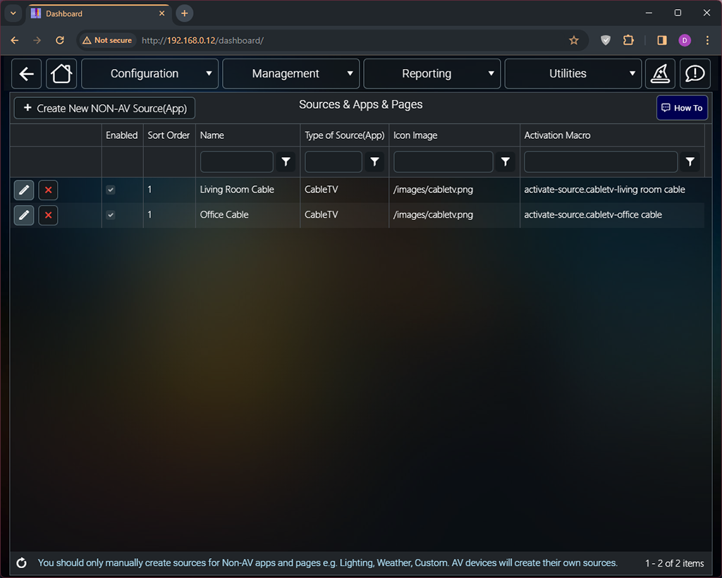

If you go over to the Sources & Apps page under the Configuration dropdown you will see that the system has automatically created the appropriate activation macros for these devices.

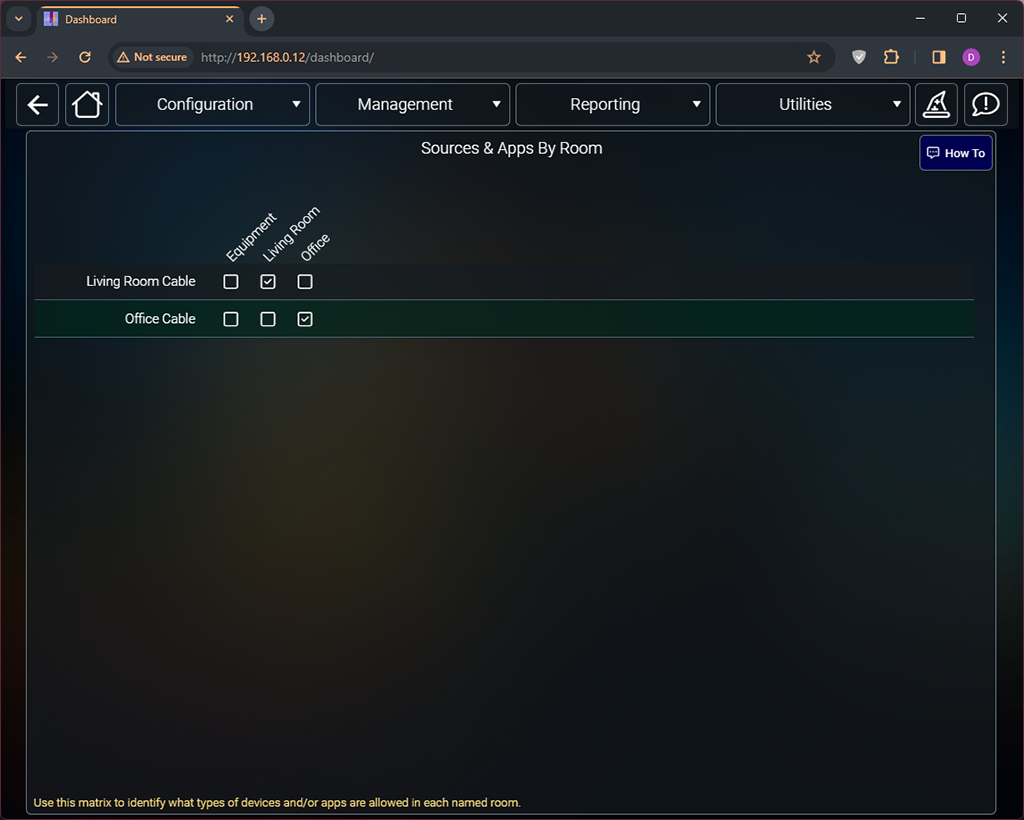

And over in the Sources & Apps By Room page you'll see the devices enabled in the rooms.

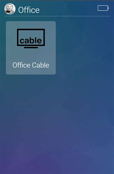

Lastly from the SmartRemote or tablet UIs you'll see the cable box as an option in the room
