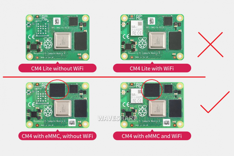

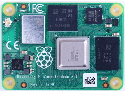

Identifying CM4 modules:
CM4 module
 The pic above references a Wifi enabled (the silver box) that has the external antenna connection (top left, under the mounting hole) and likely 32 Gig eMMC memory (the black flat module to the left of the CPU and the same module above the CPU).
Compute Module 4 5
K4F8E3S4HD-MGCL 8 Gb x32
