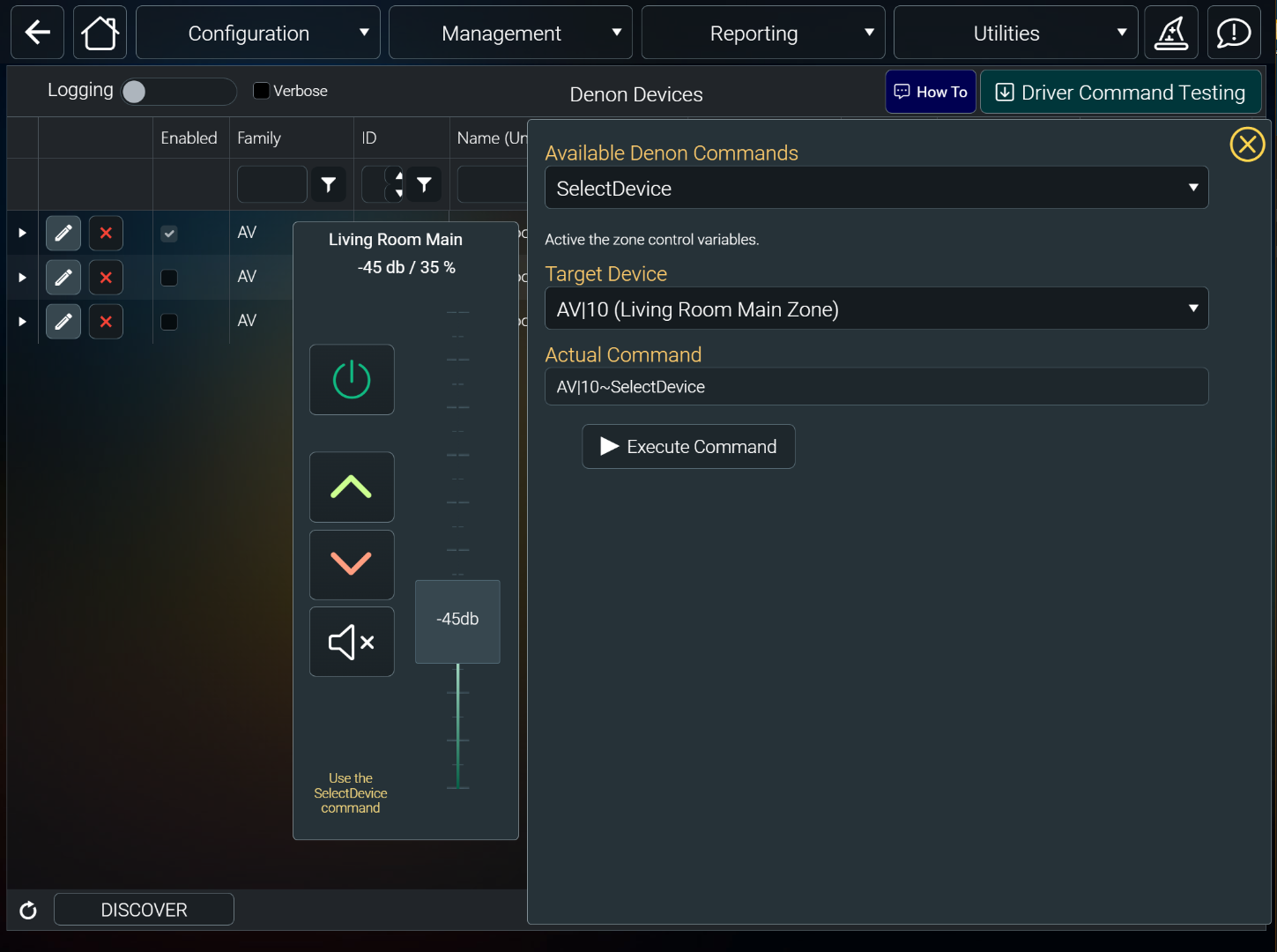

Here is the Denon driver showing the db variable being used.

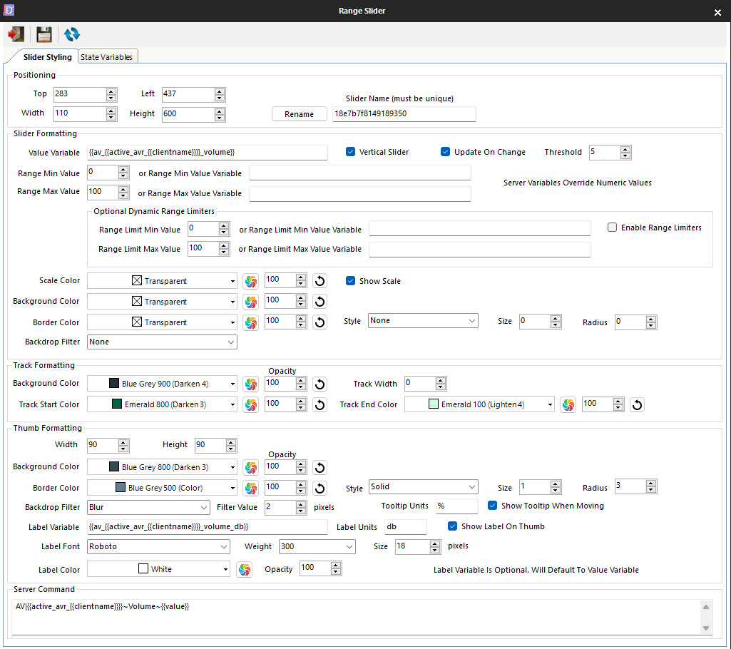

Here is the web object being edited in the Designer showing the new Thumb label variable.
