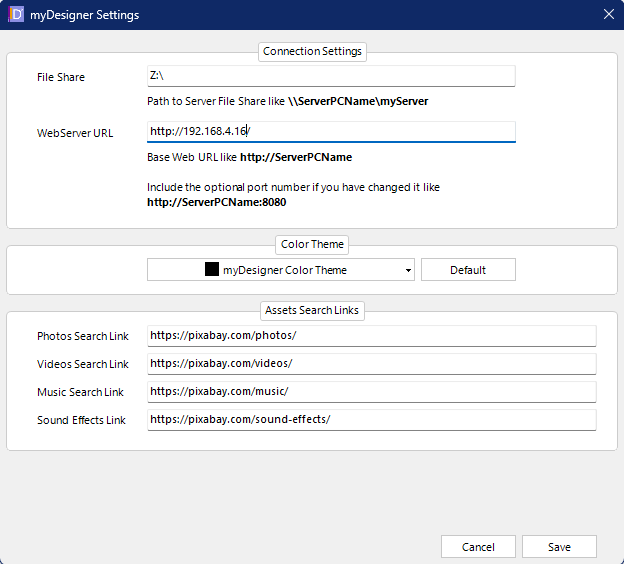

  5. Step 5: The myServer 6 network setup defines which ports on the SQL server allows a remote PC running myDesigner to connect to it.

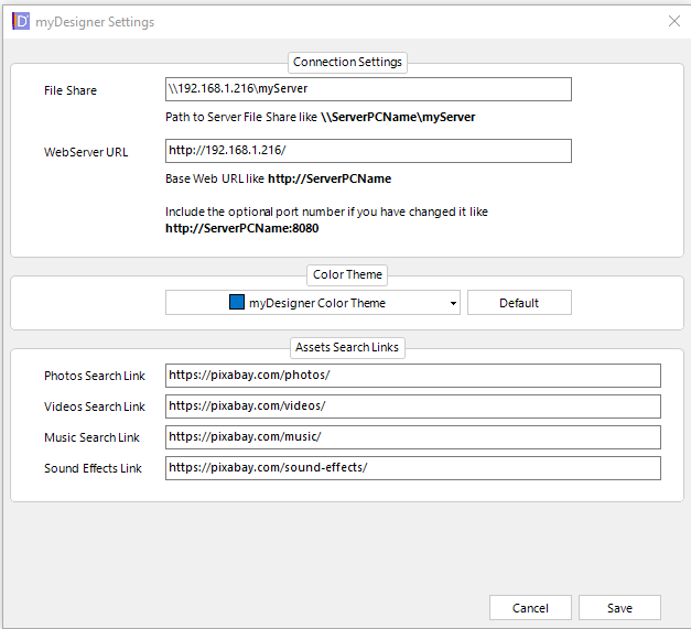

  6. Step 6: Once myDesigner 6 starts up, configure the settings form for the IP of myServer controller.

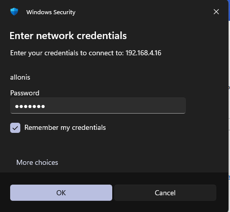

  8. File Share: "\\yourSERVERname\myServer"  If your list of myServer template folders doesn't populate, then it's likely that your Windows computer doesn't allow for connection.  Paste the same URL into Windows File Explorer.  You might need to add "allonis / allonis" user credentials to Windows to enable connection.  If you are having issues, particularily with Windows 11,  right-click on Windows 11 start button. Choose run.  In the Open text box enter \\[IP ADDRESS]\myServer and click ok. Are you prompted for credentials? If yes then enter allonis / allonis and make sure to click on remember. If no then does that open the share and you can browse files?
  9. WebServer URL: "http://yourSERVERname:80/" Modify the port number to be same as what you are running myServer's web server on. Port 80 is the default and it is not required to be typed in the URL. Click Save button.
  10. Step 7: Click the SAVE button and Connect. myDesigner 6 should now be running and your list of web apps should be listed on the left side.

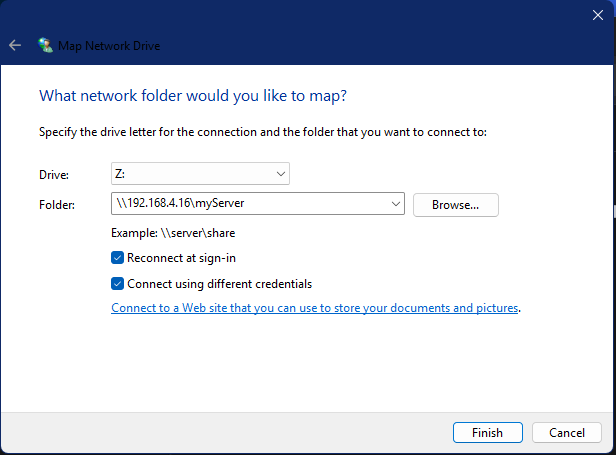

If you have disregarded Windows notification that the folder is not accesible, then you may have to map a new driver:
Some possible steps:
From Windows File Explorer
  Right-click on Network and click on map network drive
From Map Network Drive
Pick a driver letter like Z:
Set Folder = \\<<myServer IP Address>>\myServer
Check - Reconnect at sign-in
Check - Connect using different credentials
mnd 1
Click Finish
On Windows Security Dialog
Click on more choices
  elect Use a different account
Then enter
  username = allonis
  password = allonis
Check - Remember my credentials
Click ok

Set File Share - Z:\
Set WebServer Url - http://<<myServer> IP Address>>
click save

Right-click on the Windows Start Icon.   Select run.
In the Open dropdown type  \\A.B.C.D\myServer and click ok.
Where A.B.C.D equals the IP Address of your myServer device. e.g. \\192.168.0.23\myServer
Does it prompt you for credentials? If yes the username / password combination is allonis / allonis
Make sure to check off the "remember" checkbox.
