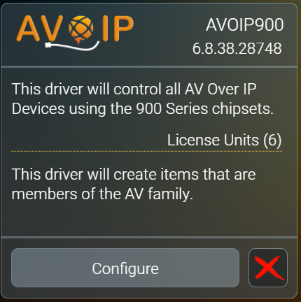

Install the AVOIP900 driver from myServer's Software Updater when myServer is connected to the Internet.  Licensing:  Each video Output requires a myServer device unit license.  If the system is configured with more devices than the system is licensed for, myServer won't function on restart.

Click on the Discovery button (bottom left).  This in time should populate the driver with all transceivers on the network.  All Discovered devices should be Enabled by default.
Click on Configure in the Drivers list.

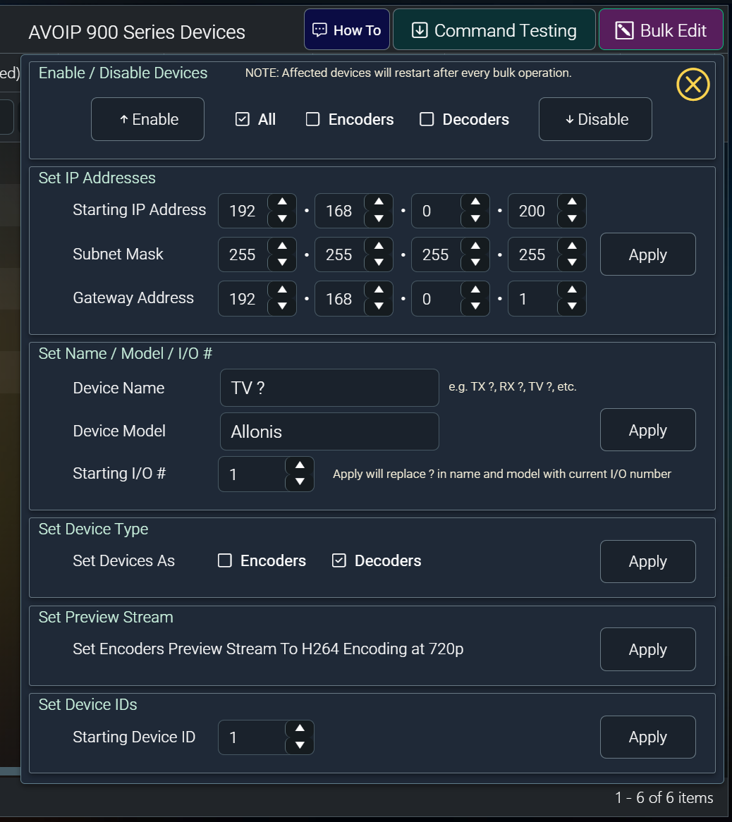

The configuration utilities  for the tranceivers is into the 900 driver.  No need to use a Windows laptop with custom application.   You’ll notice a new button on the driver labeled Bulk Edit.
address1
Clicking this exposes a set of additional functions that will allow for batch updates of all the devices. Naming, IPing, etc.
address1
This should now allow us to fully configure a system without having to use a Windows PC which most systems require.
Everything in Bulk Edit is meant to act upon multiple devices at one. In the normal command builder you will see the same commands that will work on individual devices.
You steer the devices by Enabling and Disabling them in the driver. Only Enabled devices are affected by these commands.  Clicking save typically will reboot that device, which once restarted, will be operating with your configured choices.  The user interface will go "black" during the reboot that is helpful to indentify it.
