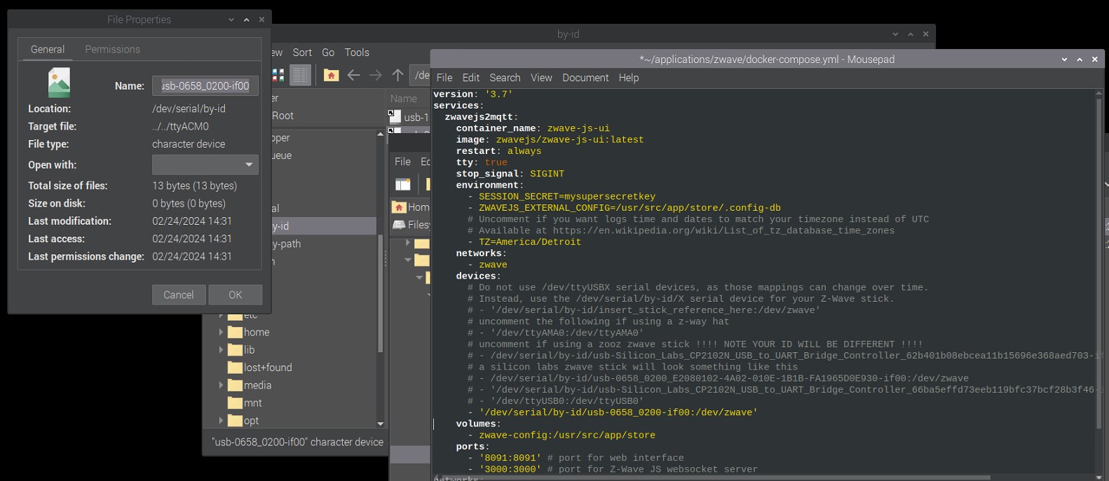

If using a USB stick radio
Plug the stick into a USB2 available slot and then boot the myServer Pi.
Once booted, in File Manager navigate to:
/dev/serial folder should now exist.  Traverse to the "by-id" file. Right click on file and choose "rename".  Copy the full name.
Paste the name into the docker-compose.yml file.  Replace the example name with your actual name.  Remove the comment # and Save the file.
An Aeotec Gen5 USB stick reports as ttyACM0 when plugged into a Shelf myServer 6 enabled front side USB port (as example).
USB configure 1
This is yaml so indentation rules must be followed (keep same indentation as rest of uncommented lines)
The physical device gets mapped to the logical device /dev/zwave
It uses the full path to the device in the using the by-id reference path that doesn't change inbetween reboots.
