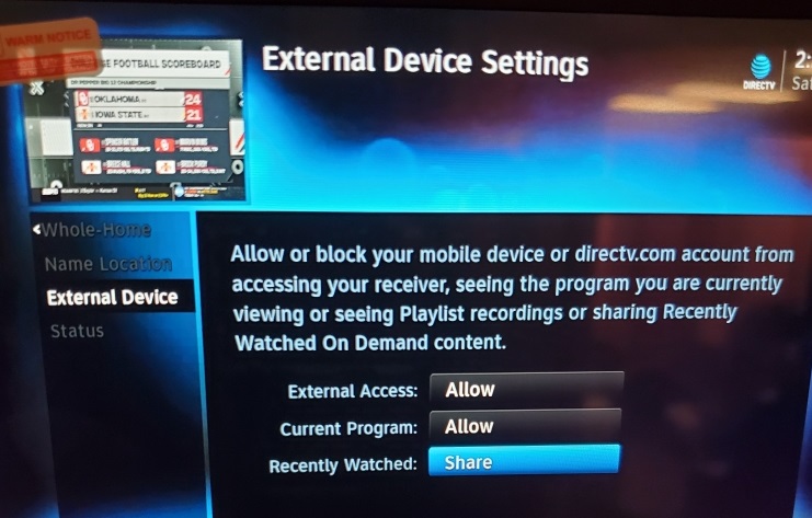

2) Configure the DirecTV receiver(s) by enabling "External Access" in the Menu / Setup / Network.
"If you’re using DIRECTV® Whole-Home DVR service, use this option to name this receiver location. Select “Whole-Home”, then “Name Location” and follow the onscreen instructions. To learn more, read the “DIRECTV® Whole-Home DVR service” section in Chapter 3. Use the “External Devices” option to allow mobile devices to access content on your DIRECTV receiver, including the ability to see the info for the currently tuned program, and tune to a channel. The “Status” option shows whether your account is authorized for Whole-Home DVR service, and how many receivers are found on your network."
Check to see if your DIRECTV Receivers are networked: Press the DASH button on the remote. The screen should say, SWiM CONNECTED and INTERNET: CONNECTED. If it is not “SWiM Connected” or “Internet: Connected,” ensure it is network connected.
Check to see if DIRECTV Receivers are enabled for the External App: Press and hold the INFO button on the remote until the System Info & Test screen appears. Select WHOLE-HOME. Select EXTERNAL DEVICE. Change all options to ALLOW. Options could include EXTERNAL ACCESS or CURRENT PROGRAM.
"External Access" / "Access Current Program" has to be allowed.
"Current program" has to be allowed.
"Recently watched" Shared.

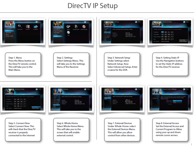

Setting a static IP address on a DIRECTV receiver
This is done from the actual receiver. On most DIRECTV hardware, press MENU, then follow these steps:
  • Choose “Settings and Help”
  • Choose “Settings”
  • Choose “Internet Setup”
  • Choose “Advanced Setup”
You will see a screen similar to this one:
https://blog.solidsignal.com/wp-content/uploads/2022/07/ip-address-300x170.jpg 300w, https://blog.solidsignal.com/wp-content/uploads/2022/07/ip-address-768x436.jpg 768w, https://blog.solidsignal.com/wp-content/uploads/2022/07/ip-address-180x101.jpg 180w, https://blog.solidsignal.com/wp-content/uploads/2022/07/ip-address-120x67.jpg 120w" alt="" width="1024" height="581" class="wp-image-34419" style="height: auto; max-width: 100%; margin: 0px; padding: 0px 0px 15px; border: 0px; font: inherit; vertical-align: bottom; box-sizing: border-box;" decoding="async" />
This will let you set that static IP address.
  • For IP address, use the first three numbers of the IP addressing scheme, that you got earlier.
  • For the fourth number, use something out of the DHCP pool, if at all possible.
  • For subnet mask, use the subnet mask that you got earlier.
  • For default gateway and DNS, use the default gateway you got earlier.
When you are done, press “Connect Now” and there will be a short test. If you’ve done everything right, it should all work and you will be connected.
