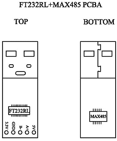

Plug in the USB RS485 adapter into the Raspberry Pi controller (running myServer6)
Wire the "A" terminal on the meter's RS485 screw terminal to the "A+" terminal on the USB RS485 adapter. (second from right looking from the screws with the wire exiting the bottom)
Wire the "B" terminal on the meter's RS485 screw terminal to the "B-" terminal on the USB RS485 adapter. (middle)

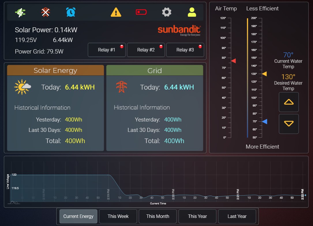

If all is plugged in and configured, immediately the meter should start populating variables in the "energy_" group.
