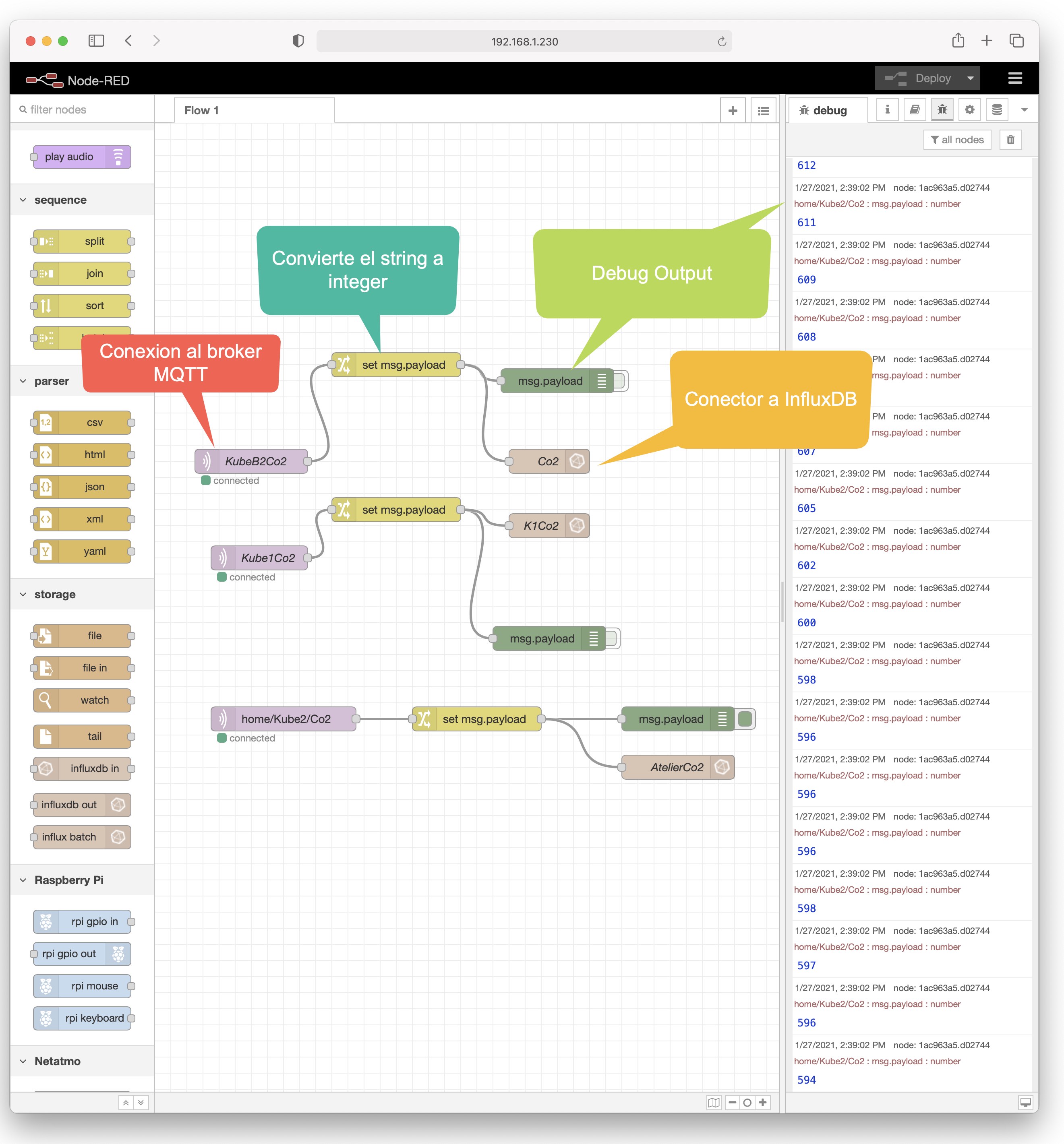

This tutorial is about embedding a grafana panel into your interface designer project. The project uses Grafana, InfluxDB, MQTT Broker and Node Red. In the authors case the sensors are home made and he has shared with you his Node-Red flow.  This is one example, your system may have additional uses.
node red flow:
NodeRedSetup

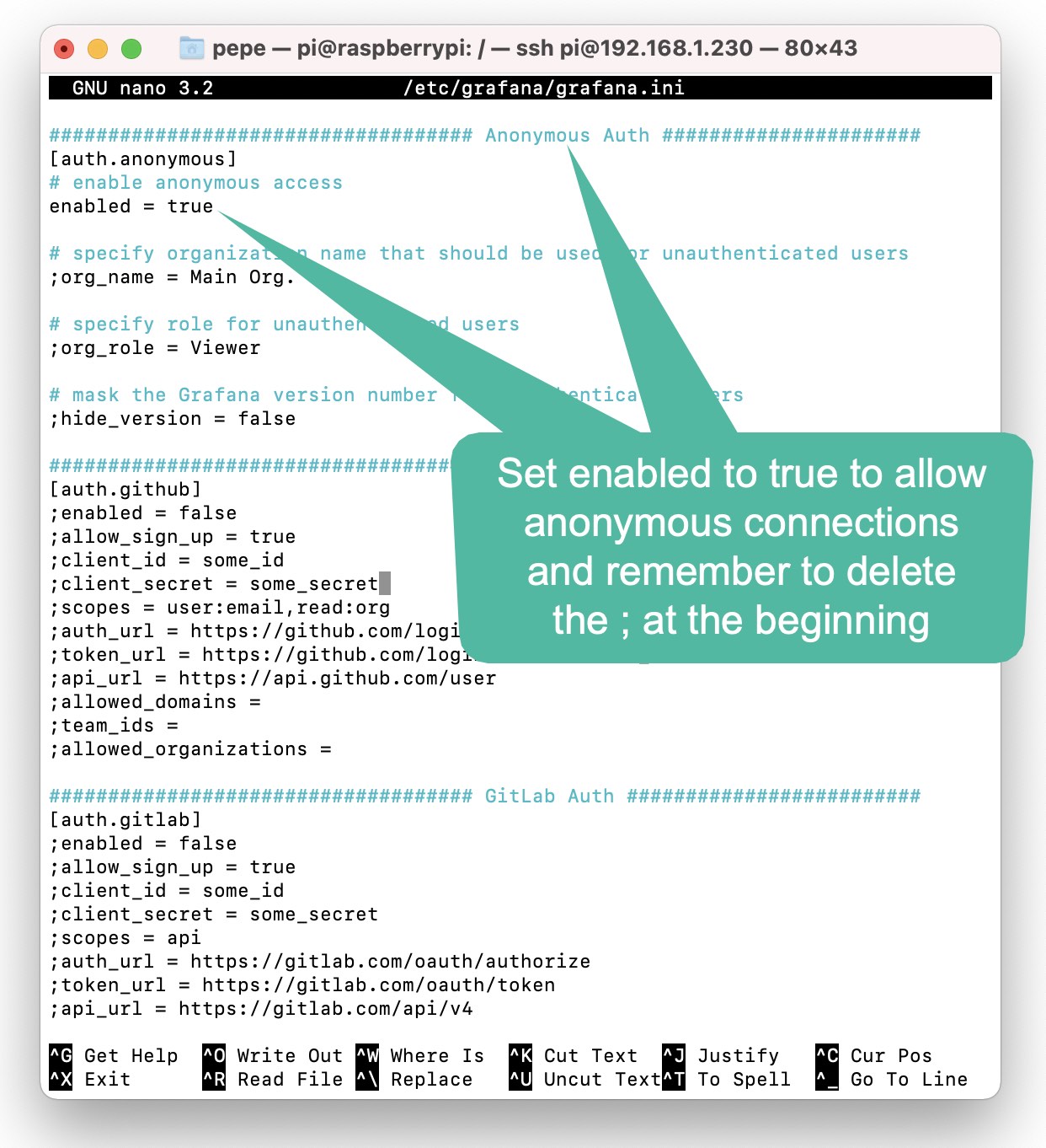

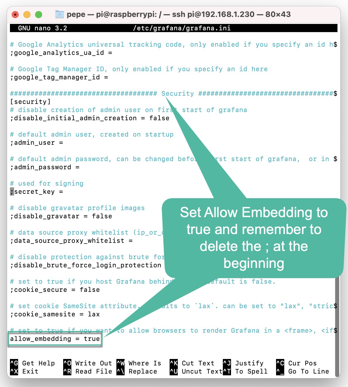

Modify your Grafana .ini configuration file by typing:
pi@raspberrypi:/ $ sudo nano /etc/grafana/grafana.ini and change the following:
Grafana ini
Grafana ini2

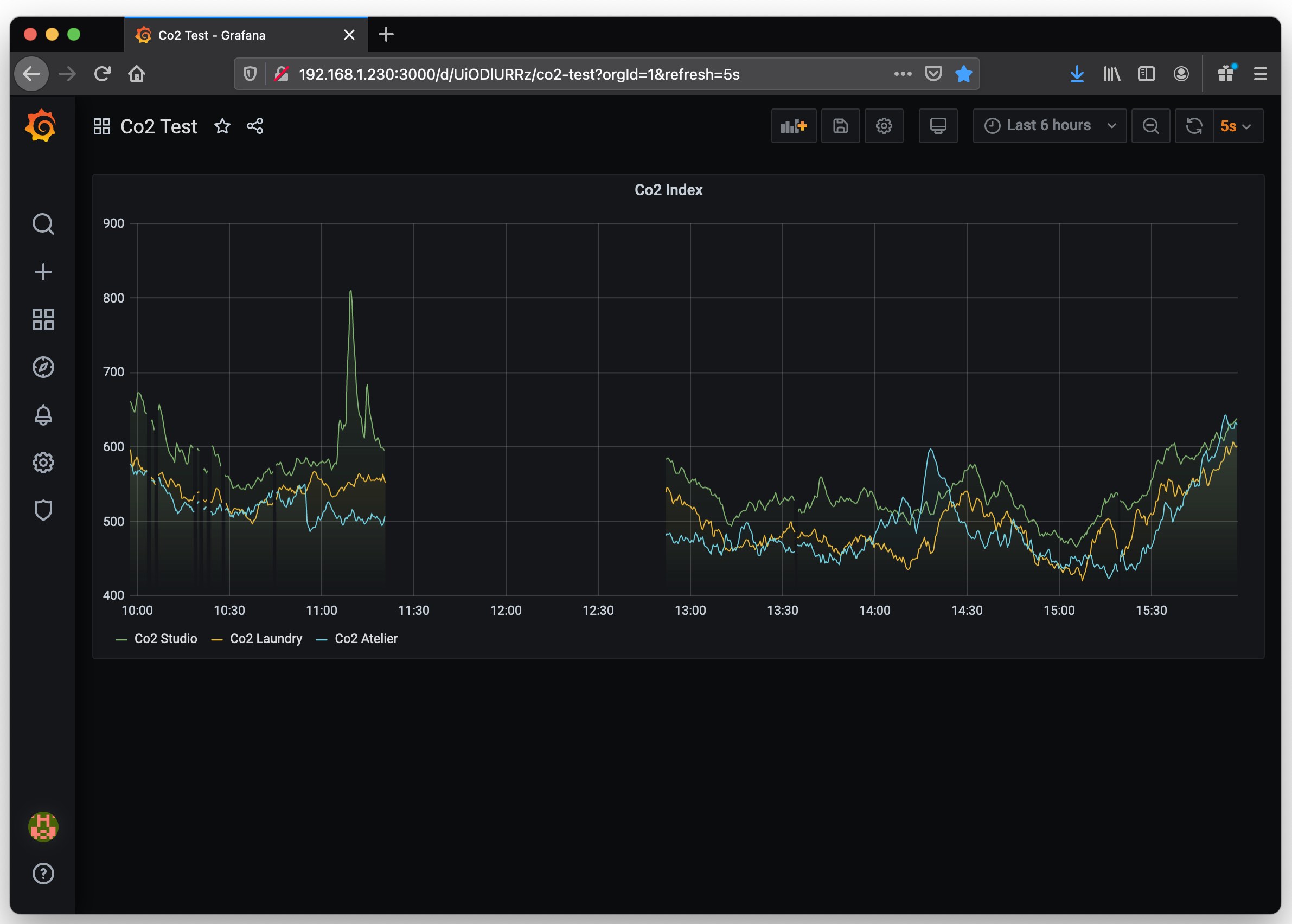

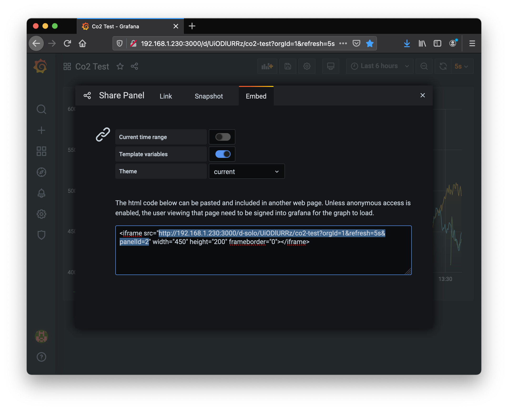

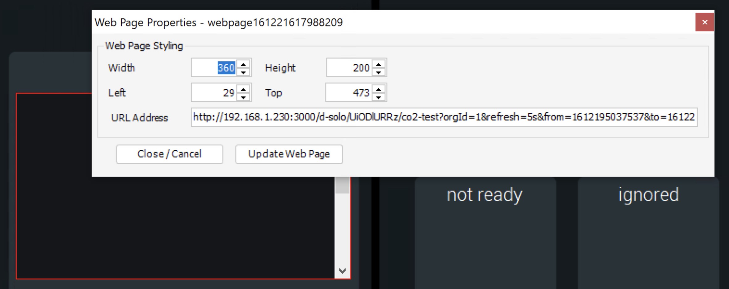

Then from your panel, partially copy the embed link as seen below. The reason why you won't need the whole link is because the web page object is already an iFrame:
Grafana time2
Copy that into your web page properties under the URL address:
Grafana myDWeb1

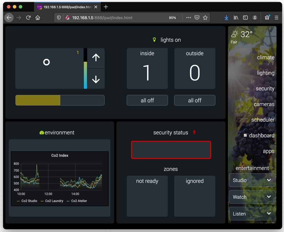

Will appear where you wanted:
Grafana myDWeb3
