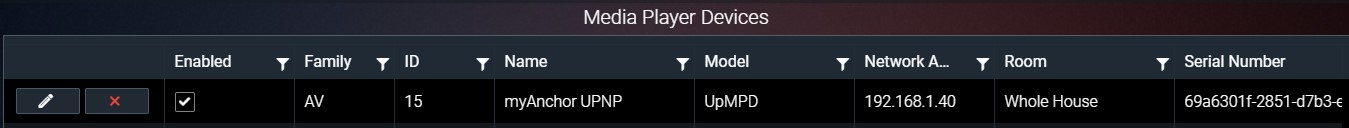

Here is the MediaPlayer Driver setup:
myAudioPlayer setup1
