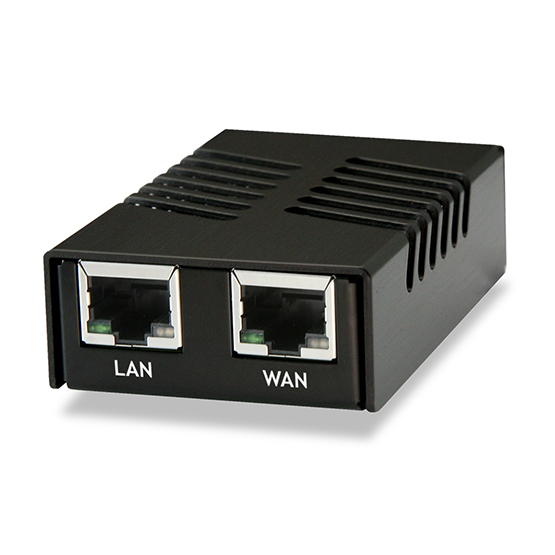

We support two models:  myFirewall2 (has two ports:  WAN and LAN) and myFirewall4 (WAN / LAN1 / LAN2 / LAN3).  The four port model enables next level security like putting all automation and security systems on a secure network, allowing all clients on the private network to communicate to the devices, and a Guest network that only has access to the Internet (no Intranet access).

myFirewall2
